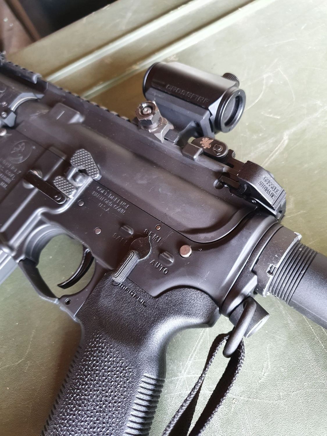

darkmajin Posted October 6, 2020 Share Posted October 6, 2020 Hey, i learned a lot of things from this thread i wal lurking around for some time, thank you all heres my finished build. Sawyer, PopRocket123 and JSwan 3 Link to comment Share on other sites More sharing options...
SSPKali Posted October 6, 2020 Share Posted October 6, 2020 51 minutes ago, AlphaBear said: May I ask, are your MWS’s stock internals? And is there a power increase with Nuprol 3.0? I tested mine on Nuprol Red at the weekend, about 13-15deg and the standard TM valve. I was getting 30-40fps over ASG Ultrair green gas. Ended up refitting the RA Tech NPAS and will run the ASG gas at the weekend and save the Red gas for <10degC days. Link to comment Share on other sites More sharing options...
ajumma Posted October 6, 2020 Share Posted October 6, 2020 1 hour ago, darkmajin said: Hey, i learned a lot of things from this thread i wal lurking around for some time, thank you all heres my finished build. Nice! Internals? Also where did you get that rail? Link to comment Share on other sites More sharing options...
darkmajin Posted October 6, 2020 Share Posted October 6, 2020 4 minutes ago, ajumma said: Nice! Internals? Also where did you get that rail? Ali they will fake everything lol... internals just follow the guide speed buffer, prommy etc, valves nothing new Link to comment Share on other sites More sharing options...

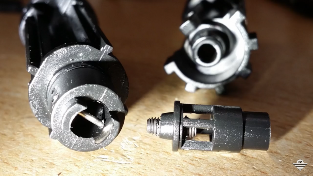

jsmithski Posted October 7, 2020 Share Posted October 7, 2020 I just ordered the Ra-Tech Black NPAS but see what I’ve came across. Anyone tried that DIY NPAS? Super simple to do (the example is from WE) Link to comment Share on other sites More sharing options...
