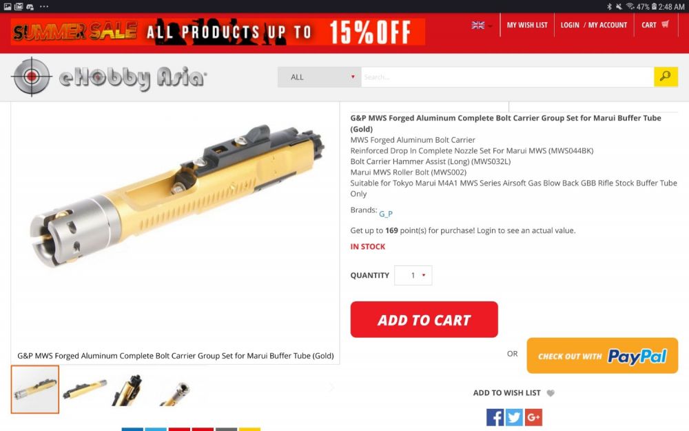

AlphaBear Posted October 4, 2020 Posted October 4, 2020 20 hours ago, Marroksteel said: Go get a Guns Modify or G&P unit I personally went with the G&P because in Hongkong they have a 2.0J limit so their products are made for higher pressure not making it to Japan's 1.3J standard and saying its green gas compatible. Because I like to believe but not certain that they stress test the products at higher rates before selling them. Would you have any links to these? I assume I can just drop one of these units into the Marui bolt carrier itself or are these complete BCGs? Marroksteel 1
Marroksteel Posted October 4, 2020 Posted October 4, 2020 1 hour ago, AlphaBear said: Would you have any links to these? I assume I can just drop one of these units into the Marui bolt carrier itself or are these complete BCGs? https://www.fire-support.co.uk/product/dynamic-precision-aluminium-lightweight-bolt-carrier-type-b-black-for-marui-m4a1-mws https://www.fire-support.co.uk/product/dynamic-precision-reinforced-nozzle-for-marui-m4a1-mws https://shop.ehobbyasia.com/g-p-mws-forged-aluminum-complete-bolt-carrier-group-set-for-marui-buffer-tube.html https://shop.ehobbyasia.com/guns-modify-reinforced-drop-in-complete-nozzle-set-v2-for-tokyo-marui-m4-mws-gbbr.html https://shop.jkarmy.com/hao-bolt-case-bcg-for-marui-mws-ecoline-tm-mws-g-hk-style.html https://shop.jkarmy.com/guns-modify-zinc-alloy-drop-in-complete-bolt-carrier-set-for-tm-gm-ha-mws.html http://www.airsoftglobal.com/shop/index.php?main_page=product_info&cPath=570_647&products_id=24718&zenid=es6o8jv45itdgb37p5gn12hr00 http://www.airsoftglobal.com/shop/index.php?main_page=product_info&cPath=570_647&products_id=23379 http://www.airsoftglobal.com/shop/index.php?main_page=product_info&cPath=570_647&products_id=23544 https://shop.ehobbyasia.com/g-p-reinforced-drop-in-complete-nozzle-set-for-marui-mws-gbb-gun-metal-gray.html https://shop.jkarmy.com/guns-modify-km-g17-stainless-steel-thread-barrel-for-tm-g17-silver-6794.html https://shop.jkarmy.com/guns-modify-km-g17-stainless-steel-thread-barrel-for-tm-g17-silver-6790.html AlphaBear 1
AlphaBear Posted October 4, 2020 Posted October 4, 2020 I’ve been reading up this morning as a matter of fact. Cheapest way is to get the G&P drop in nozzle set which should fit into the stock Marui bolt. But then I’m thinking I may as well get the complete G&P bolt carrier group. It’s all built for you so just simply drop it in. Decisions, decisions.... Also perhaps a G&P 3.5 nozzle valve kit too perhaps ?

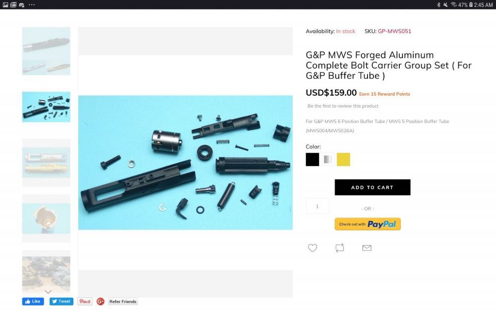

Marroksteel Posted October 4, 2020 Posted October 4, 2020 15 minutes ago, AlphaBear said: I’ve been reading up this morning as a matter of fact. Cheapest way is to get the G&P drop in nozzle set which should fit into the stock Marui bolt. But then I’m thinking I may as well get the complete G&P bolt carrier group. It’s all built for you so just simply drop it in. Decisions, decisions.... Also perhaps a G&P 3.5 nozzle valve kit too perhaps ? Just be aware that they make 2 versions of the BCG 1-for their stock tube and 1-for marui's I would bet its for civilian sized stocks whereas the Tokyo marui is in between civilian/ military size AlphaBear 1

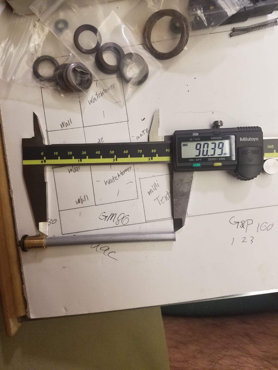

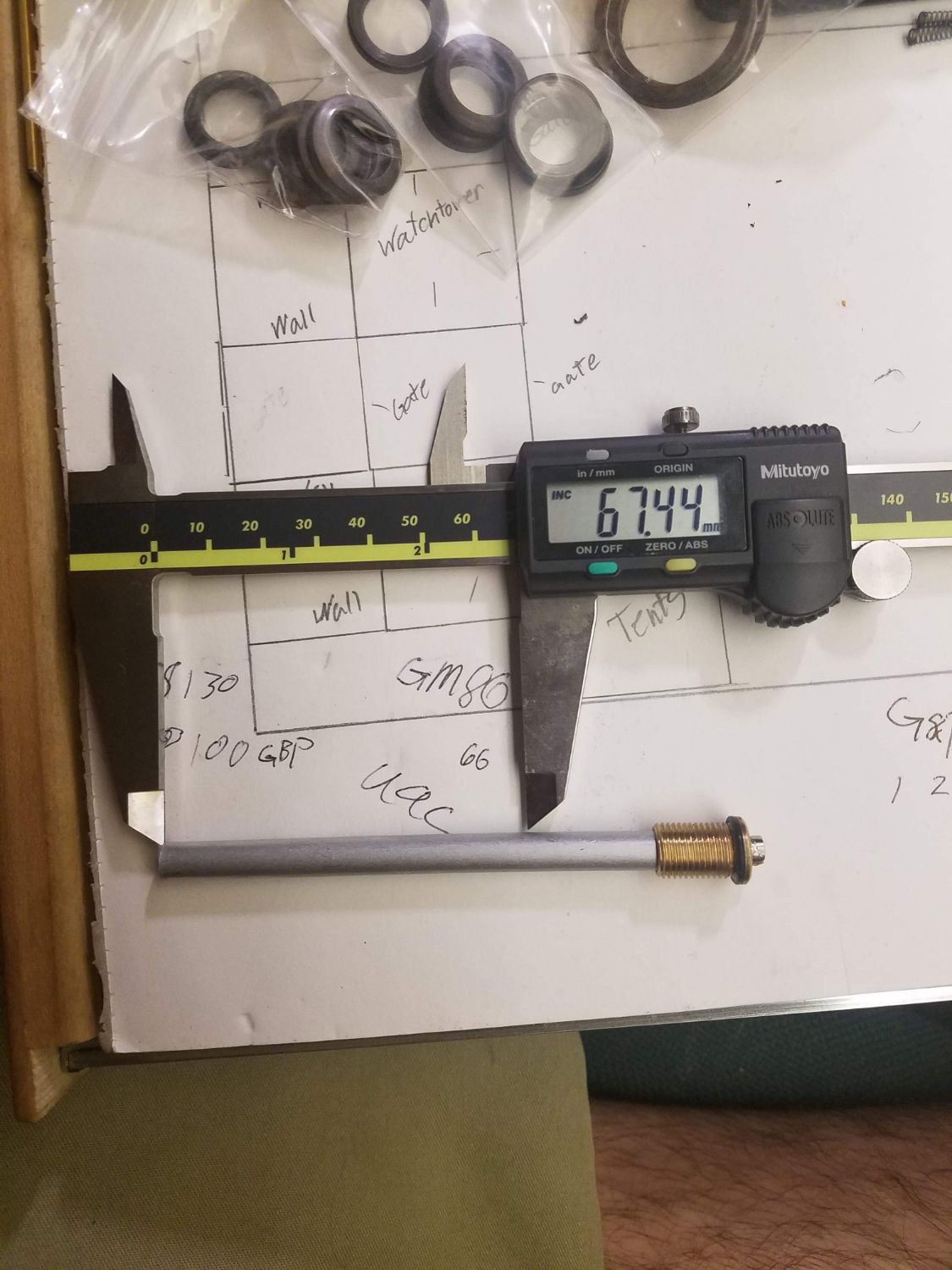

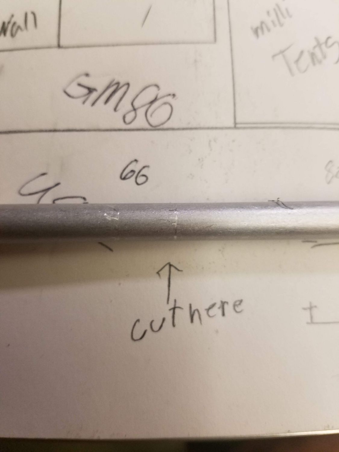

Marroksteel Posted October 4, 2020 Posted October 4, 2020 Well I'll make it simple for people with the power of mitutoyo. For the green gas mod cut 33mm or more (depending on your preference) above the brass fitting. Wild Weasel 1
