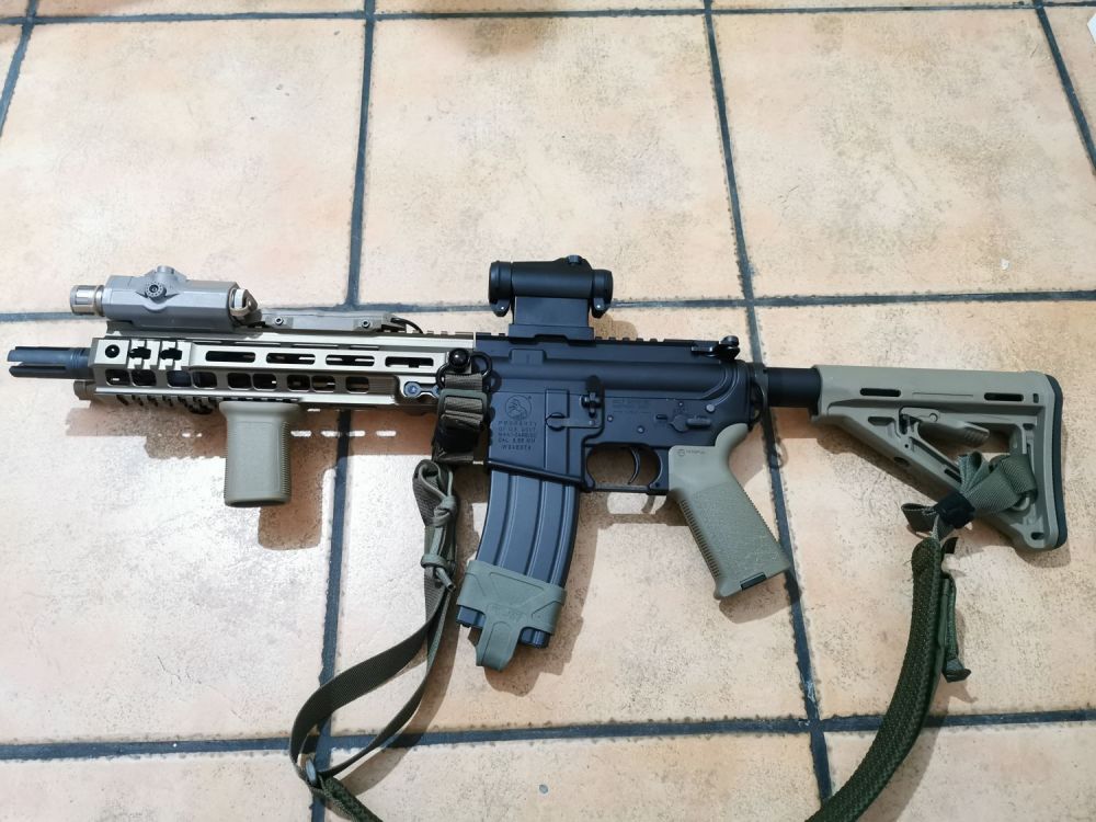

MILITATED Posted August 7, 2020 Posted August 7, 2020 32 minutes ago, Davegolf said: Wonder where that came from!? Shouldnt be difficult to get a genuine buffer. Whats the game plan? Looks familiar, doesn't it ? Probably 7 inch barrel & m lok handguard combo, PDW type stock, suppressor to cover the remaining inner barrel and a Magpul MVG. Might change the pistol grip too. Basically, the opposite of a normal MTR! All still up in the air for now though!

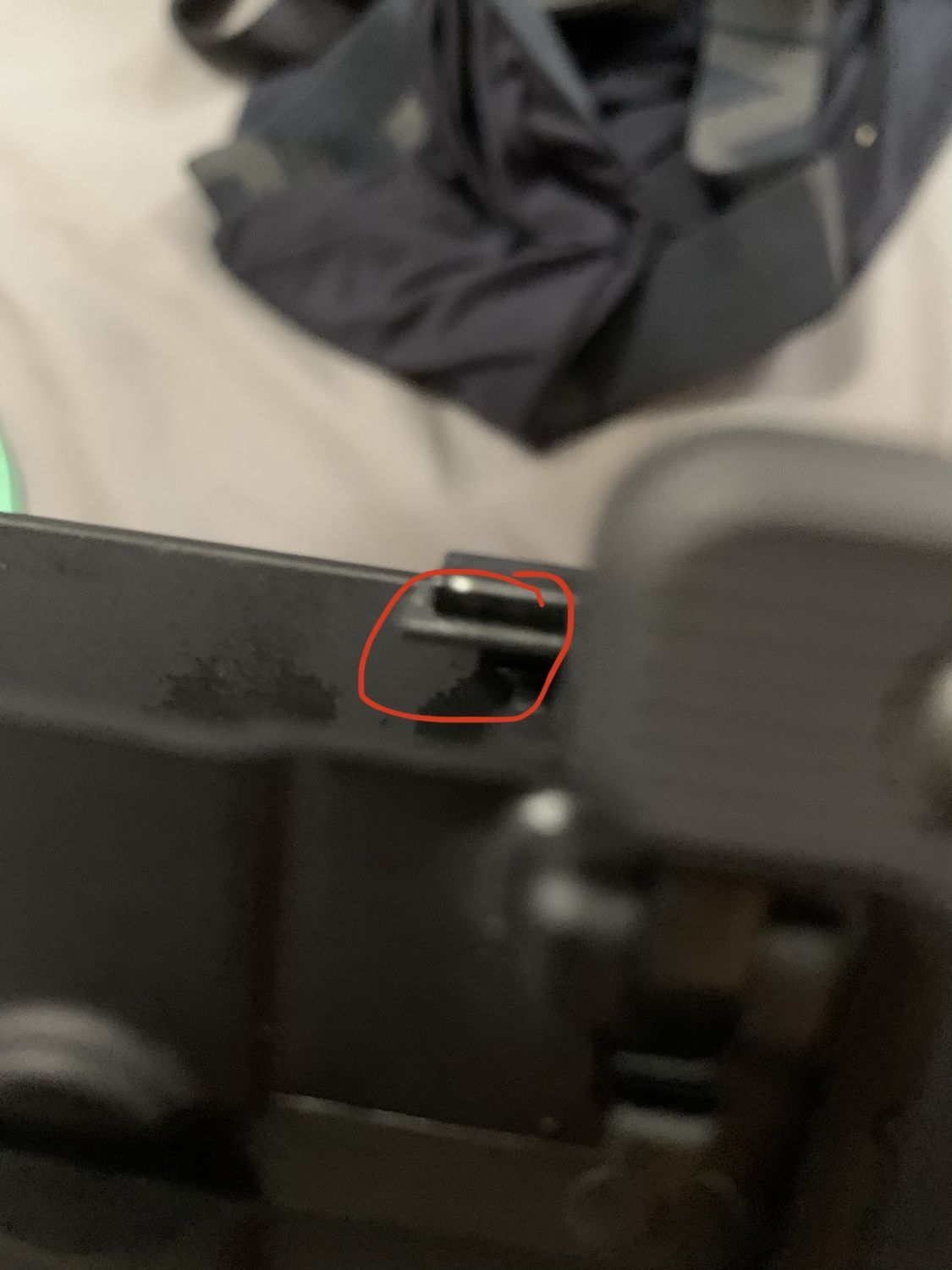

Modallthethings Posted August 9, 2020 Posted August 9, 2020 Alright Gents! just got my MWS a couple days ago and proceeded to install the magpul BAD lever. Was told by Kakasi on IG that it would work with no modification. It did not. Im assuming that as was stated waaay earlier in this thread that the lever is too heavy for the magazine spring to push up. What was done was to wrap some tape under the bolt catch. I took it a step further and super glued some material under it. Its about two credit cards thick of material for those about to ask how thick it should be. The bolt catch now works 110% of the time. Attached are pics for those wishing to install the BAD lever. Youre welcome Davegolf 1

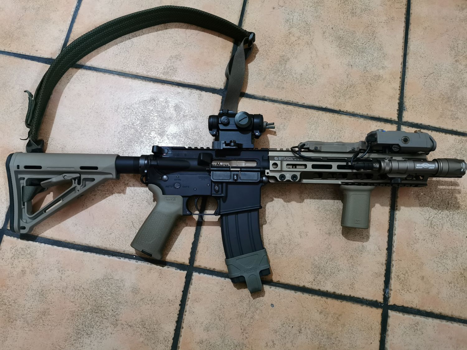

P4radox Posted August 10, 2020 Posted August 10, 2020 On 07/08/2020 at 17:19, BigBlackGlock said: Same! Kinda... And so the build begins! Must decide on what to do. Need to replace the buffer tube also, bit of a weird one as it doesn't screw in more than 3 revolutions. Not even sure if it is a TM tube Wanted to use the MTR as a base for a while now Proper cqb length!??? MILITATED 1

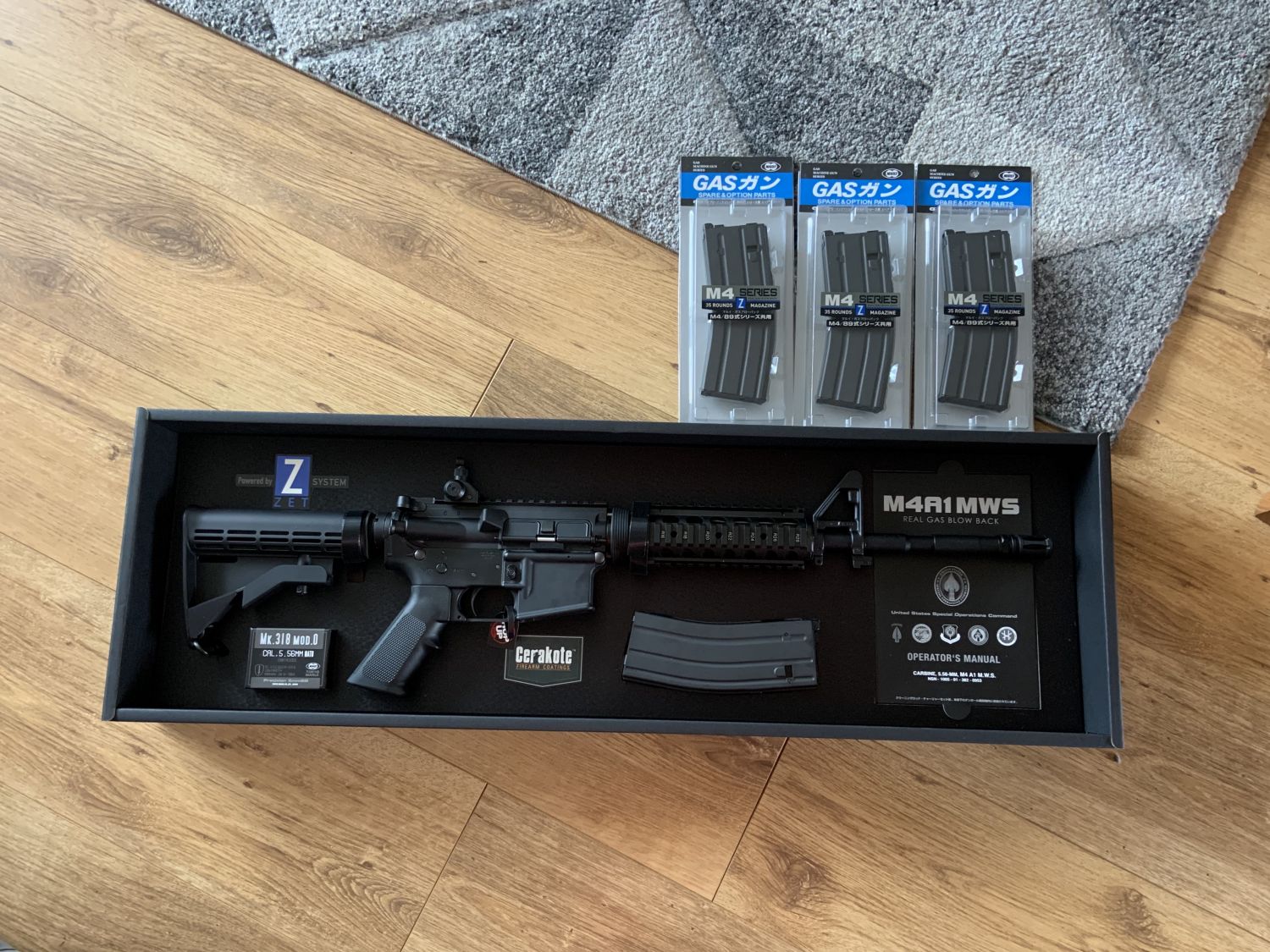

Noddy45 Posted August 10, 2020 Posted August 10, 2020 Bought from Fire Support - first purchase from them - great service and prompt delivery. Thanks to @Jacket for the info - good deal - Gun and three extras mags - basically got the case free going off what I could find elsewhere. Jacket and SSPKali 1 1

Wild Weasel Posted August 11, 2020 Posted August 11, 2020 On 10/08/2020 at 00:29, Modallthethings said: Alright Gents! just got my MWS a couple days ago and proceeded to install the magpul BAD lever. Was told by Kakasi on IG that it would work with no modification. It did not. Im assuming that as was stated waaay earlier in this thread that the lever is too heavy for the magazine spring to push up. What was done was to wrap some tape under the bolt catch. I took it a step further and super glued some material under it. Its about two credit cards thick of material for those about to ask how thick it should be. The bolt catch now works 110% of the time. Attached are pics for those wishing to install the BAD lever. Youre welcome Yep, same for me, I installed it, it failed to lock back, I wound out the buffer tube two rotations and it worked. My problem with it, as much as I loved it was that it failed to allow the ping-pong paddle to come out enough from the lower receiver which prevented the zet plate to come up enough to lock forward and although it worked perfectly I was noticing additional metal fragments appearing in the lower receiver. To remedy this I tried to bend out the b a d lever culminating in me cracking the anodising like a f'ing mong and getting v upset with myself for flushing £35 down the crapper. Well I was warned. I reckon though if you have mad metal work skills this could be made to work, unfortunately I've been dropped in too many times on my head and I couldn't. Good luck.
PopRocket123 Posted August 11, 2020 Posted August 11, 2020 2 hours ago, Wild Weasel said: Yep, same for me, I installed it, it failed to lock back, I wound out the buffer tube two rotations and it worked. My problem with it, as much as I loved it was that it failed to allow the ping-pong paddle to come out enough from the lower receiver which prevented the zet plate to come up enough to lock forward and although it worked perfectly I was noticing additional metal fragments appearing in the lower receiver. To remedy this I tried to bend out the b a d lever culminating in me cracking the anodising like a f'ing mong and getting v upset with myself for flushing £35 down the crapper. Well I was warned. I reckon though if you have mad metal work skills this could be made to work, unfortunately I've been dropped in too many times on my head and I couldn't. Good luck. This is why I'd rather use the MTR 16 as the base for an ambi build. Everything else would get replaced though Wild Weasel 1
