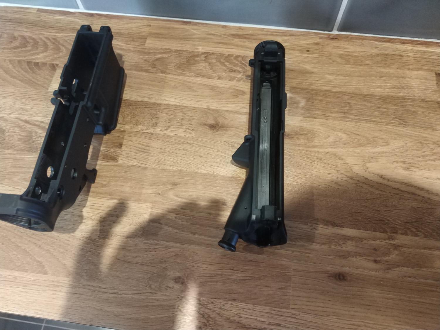

Can I get a price check on this.
I recently upgraded my mws cqbr block 1 to a nova receiver and obviously have a load of spare bits left over, all in really good condition but I would note the upper and lower receiver are both completely stripped with only the forward assist remaining.
In the box:
  • MWS rear site
  • Replica rear battle site
  • Genuine Magpul mlok vertical grip
  • MWS vertical grip
  • MWS a2 pistol grip
  • MWS rails
  • Hop unit and adjuster
  • Stock
I think theres some value but not sure what price to put on it.
Cheers?
