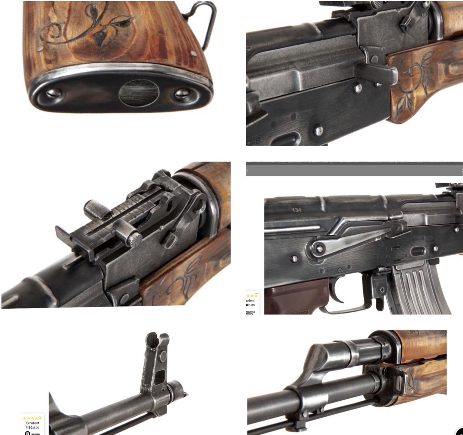

I also use this pic if I’m weathering an AK as a resource but it’s useful what ever long arm your aging .?

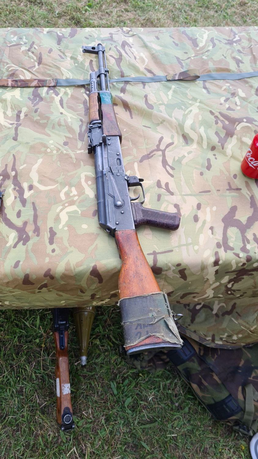

Genuine AK.
Note the weathering is "polished" I see too many guns scrubbed with coarse sandpaper, often in places where they wouldn't wear.
