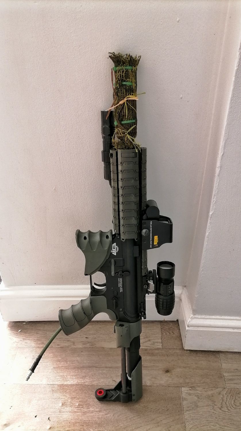

emilianoksa Posted September 28, 2021 Posted September 28, 2021 14 hours ago, airsoftot said: Cheers, I was just saying to my friend how I thought I may be better off leaving the CM16 alone and keeping it as a backup/spare The only thing is I actually really like the gun; it's cheap, light, durable.. paint doesn't scratch etc and being the most sold gun everywhere has spares and of course there is aftermarket support for the gun itself and m4 being developed continually (such as the 250 mid cap mag). I'm not afraid to upgrade and tune all the internals, as that's something I will be doing with my main gun regardless Still just new so not familiar with all the manufacturers/models... I'll maybe see if there is a better polymer m4 base to start with G&G polymer is some of the best you can get.
