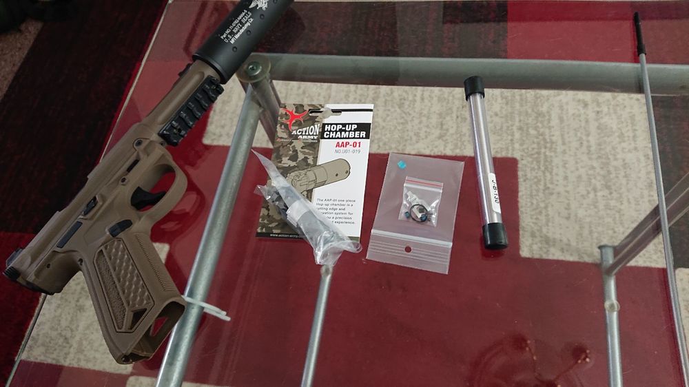

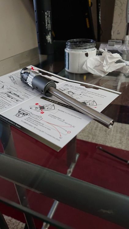

I joined the ever-growing AAP owners recently, and treated myself to the AA hop unit.
Paired it with a 130mm ZCI barrel from @ak2m4
So I can replace the whole hop & barrel in one go, and keep the original set up if needed.
Currently using a flamingo V2, but I've also got a couple of maple leaf buckings on order too. (I thought I had some more spare, but obviously not).
Can't wait to get out & use it next weekend!

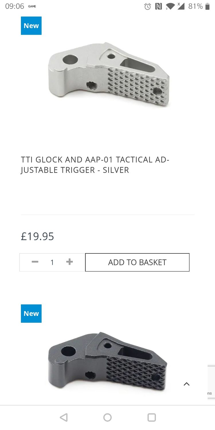

Just sawScreenshot_20210424-090637.thumb.jpg.609eba86e13edabe639fdf303a9c33c3.jpg
Just saw these while filling one of my various payday pending shopping baskets! Only on pre-order at the moment but might try one.
Saw them too! They are interesting because they don't have the stupid glock safety.
I have ordered a supposedly adjustable trigger from aliexpress yesterday, €13 posted.
If it works, I'll get a couple more (or these TTIs if they cost less than a lung here in Europe)
