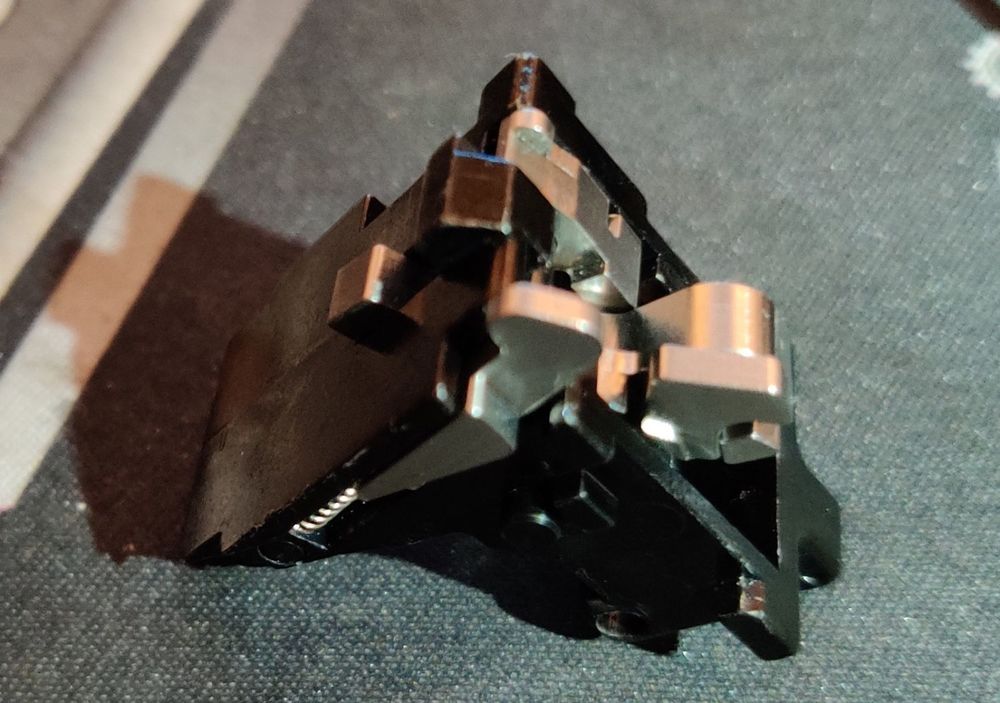

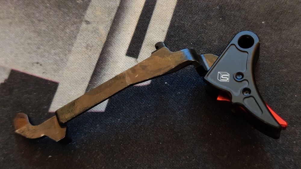

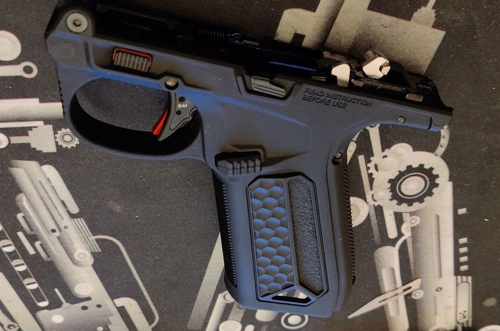

OK, so the lower is done. The Cowcow internals and GM trigger are in place.
The trigger is almost a direct fit but a little adjustment was required to allow it to pull back far enough to release the hammer. You can see it has small extra protrusions to limit over-pull after the release.  One possible downside with aftermarket triggers is you do lose the safety.
I Modified the auto sear to match the original.

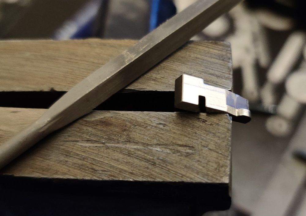

I also took some pictures of the mods I made to the nozzle. You just need to cut/file the rear profiIe to match the original and trim the side guides by the smallest amount (about 0.5mm) to allow it to slide smoothly in the bolt/BBU.  Just shave a little at a time until it moves freely like the original.
Before
During
After

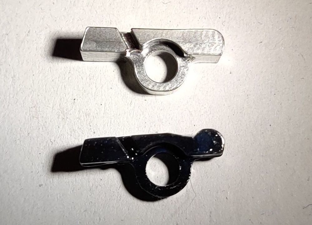

I found that the Cowcow hammer roller caused a very sticky slide so although this picture has the silver Cowcow part this has now been replaced by the original. All fires nice and smoothly now.

That's all impressive, I'd have got my Dremel cutting bit out and probably would have cocked it up lol. That reminds me I need a vice and some new metal files..... anyway, back to my point.... why is there a need to replace the original trigger parts with these 3rd party parts? Durability? Quality? Lockdown boredom? ;)
For the hammer and sears it is mainly for durability. The trigger itself; I just like the alloy trigger rather than plastic. It is also adjustable so I get the short trigger pull I like.
I am also someone who loves to tinker and don't have any standard airsoft guns. I would imagine the standard pistol will be fine for a long time before any need for repair or upgrade. I just can't help myself!!! :)

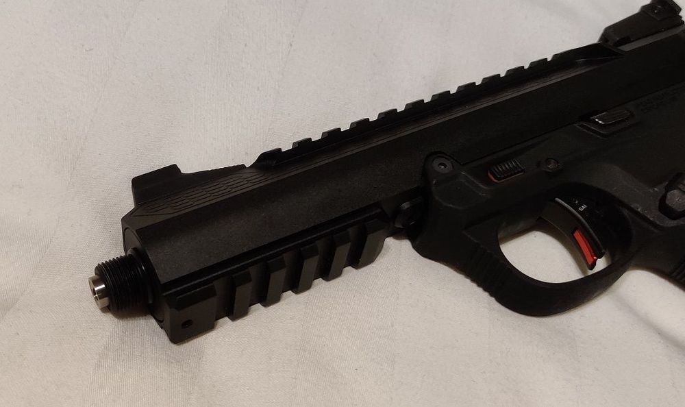

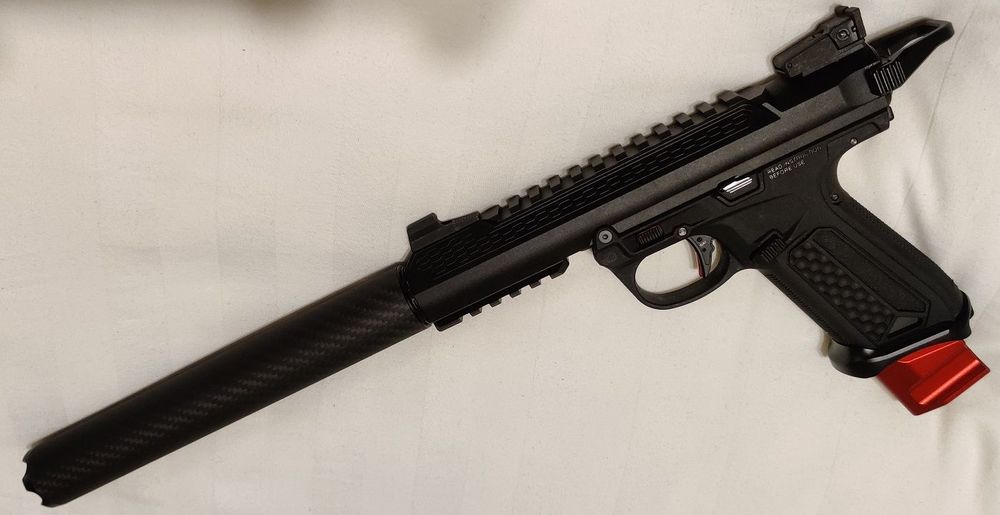

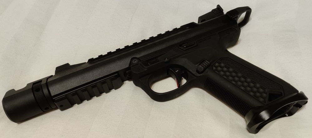

So upper complete. Sorry about the poor contrast in the pictures.
Barrel length just about perfect.
With the standard Mamba compensator.

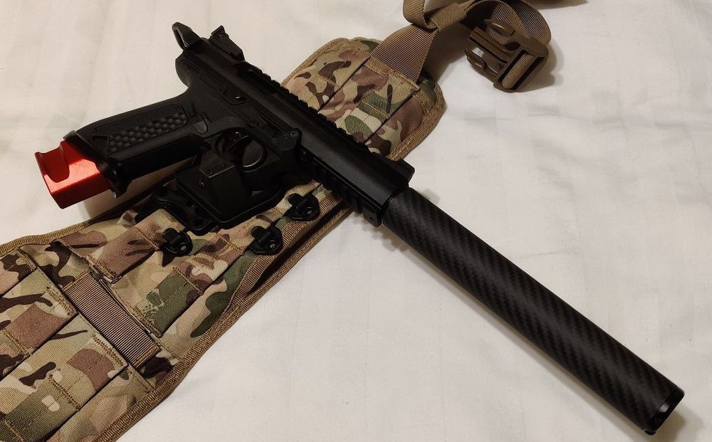

With the suppressor

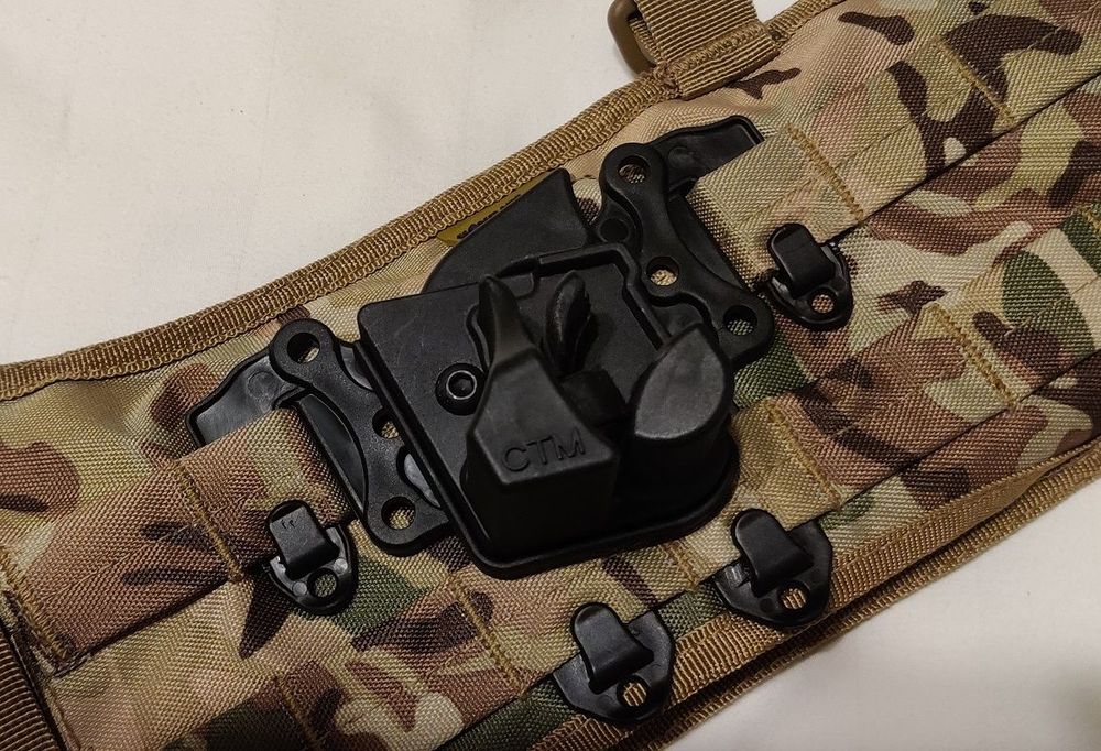

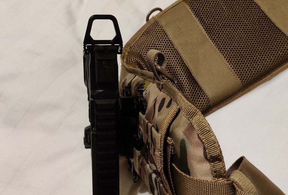

Got the CTM holster with a molle adaptor. This needed a little dremeling due to the change in trigger. With is set up for a short pull the gap behind the trigger is much smaller so material nedeed to be removed from the holster. In standard for the fit was perfect.
With the pistol in the holster.
One of the offset from the belt which feels a lot less than I thought now it is fitted.
