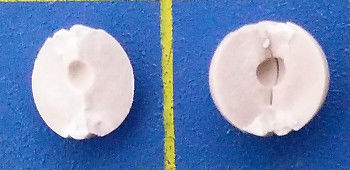

They readily split into fragments when crushed, and unfortunately I found a bubble in every BB I tested. Here's a photo of one that I managed to crack open more or less cleanly showing the air bubble:

Unfortunately, just like the 0.2g version I found an air bubble in every one of these I inspected too. These were also much harder than the 0.2g version and they had a tendency to shatter suddenly once they started to crack but I did manage to break open cleanly for a photo:

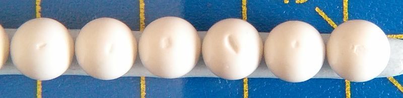

Unfortunately I found a few in the pack with some surface defects. They weren't very big or deep & probably aren't rough enough to cause any damage, but they would most likely affect performance.

I found a number of other BBs in the pack with surface defects, most of those merely had one or more slightly dented and/or scratched surfaces but some were spectacularly bad - especially this one:
(it's even worse than it looks here but my crappy phone camera can't capture it well enough)
They almost look like they've already been fired once then picked up and repackaged. Using BBs with surface defects like these have will cause increased wear on the gun's hop rubber or may even damage it and/or cause jams. It's possible these were simply from a "bad batch", but IMO there's no excuse for any BBs with such glaring external defects as these to go unnoticed.

Most of the BBs tested appeared to be free of air bubbles, but I did find a small air bubble in one of them.

I bought some 6mm Ammo BBs to test. Shipping was extremely quick; I placed my order late on Friday evening, received the shipping notice email on Saturday & they were delivered on Monday - this was with free delivery option too!
These are the 0.30g version, in both the regular and tracer versions. The regular BBs are supplied in a black coloured bag, while the tracers are supplied in a transparent bag. Both bags are completely sealed & resealable - there are no air holes that might allow in dust or any other contaminants from the environment.
6mm Ammo 0.30g Bio BBs
Just like my other tests the very first thing I did was sift through the BBs and inspect them for any obvious defects. Unfortunately I found a number of BBs in the pack that had significant surface defects, ranging from minor dimples to larger dents/scratches (and even a protrusion on one of them) - the latter potentially being a big problem as significant defects could damage the hop rubber an/or cause a jam in addition to compromising the performance of those particular BBs. Here are some of the worst ones I found (best photos I could get; my phone's camera isn't very good):
6mmammo-1.jpg.cf70b0f5154e94f4aca3a1b78be88c16.jpg6mmammo-2.jpg.6c30cc623b8d500124774e1515f08e44.jpg
In addition to this, despite the pack having been sealed there were a few bits of dust/debris in the pack that had stuck to some of the BBs. I only noticed due to paying such close attention to them (and it's not as bad as I've seen in some other brands that don't come in fully sealed bags) so it's likely nothing to be concerned about but I think it's worth noting.
I measured only BBs that didn't have any obviously visible defects.
Weight: All but two were slightly overweight at 0.31g (my scales wavered a little between 0.30 and 0.31 on a few of them before settling on on 0.31)
Size range: 5.91 - 5.95mm; 4 measured within the 5.95 +/- 0.01mm tolerance. 1 was 5.91mm minimum, 2 were 5.92mm minimum, 13 were 5.93mm minimum, 4 were 5.94mm minimum.
Roundness: 1 measured 0mm variation all around, 15 measured with max variation up to 0.01mm, 3 with 0.02mm, 1 with 0.03mm
Defective BBs aside these are among the better BBs for consistency and roundness, with 17 being 5.93mm+ and only one having more than 0.02mm variation, although they lean towards the heavier side.
These are harder and more brittle than the Geoffs 0.30s, breaking apart cleanly. I did not find any air bubbles in the ones I broke apart.
