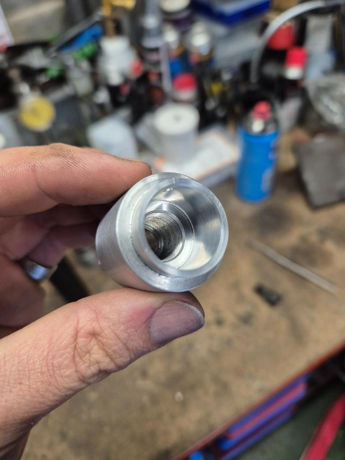

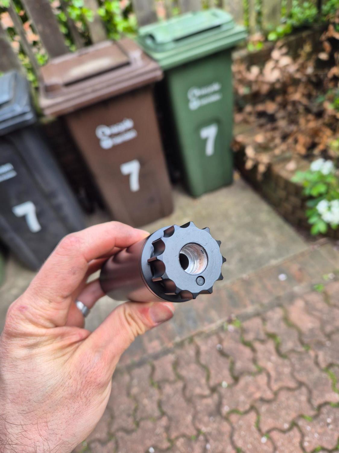

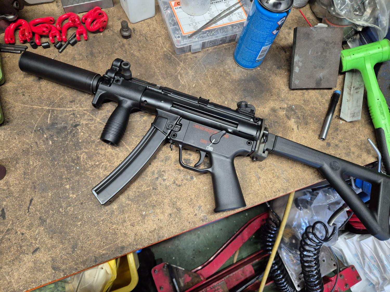

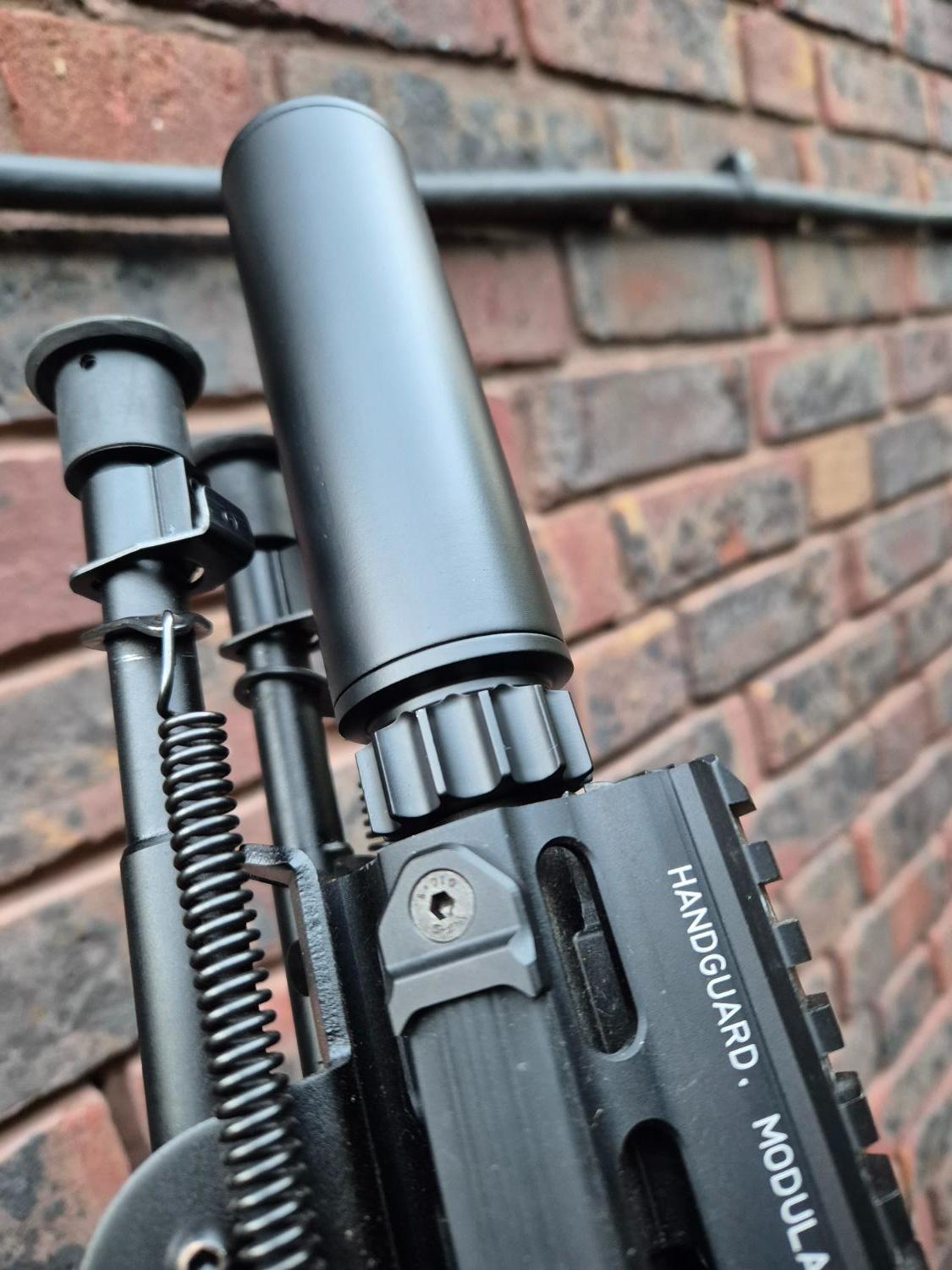

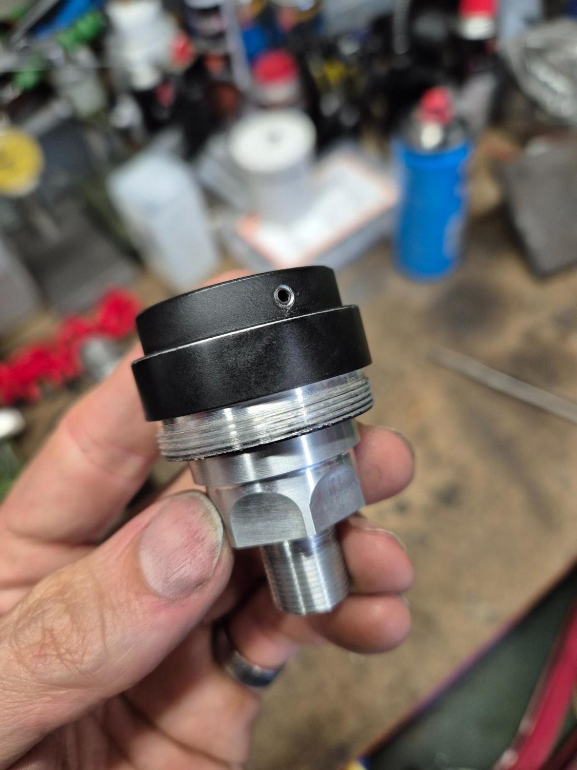

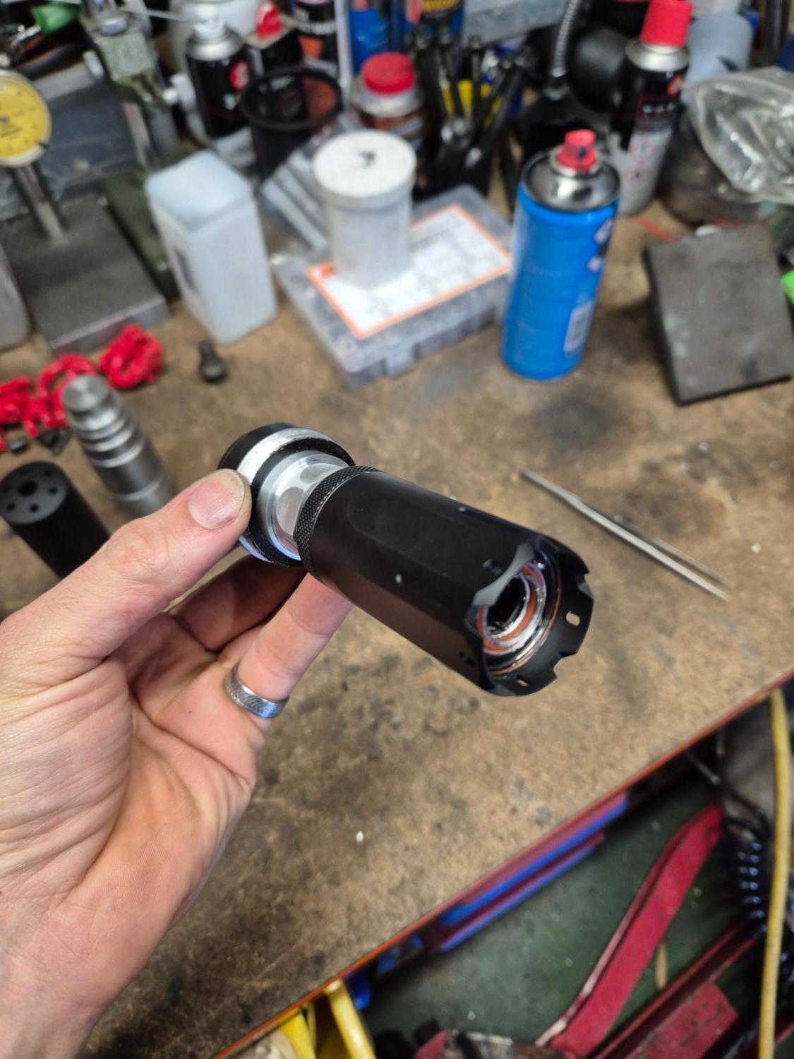

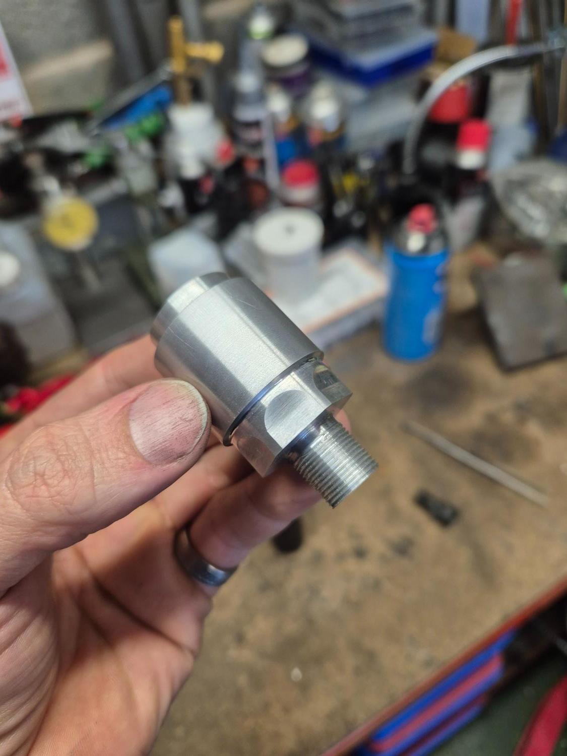

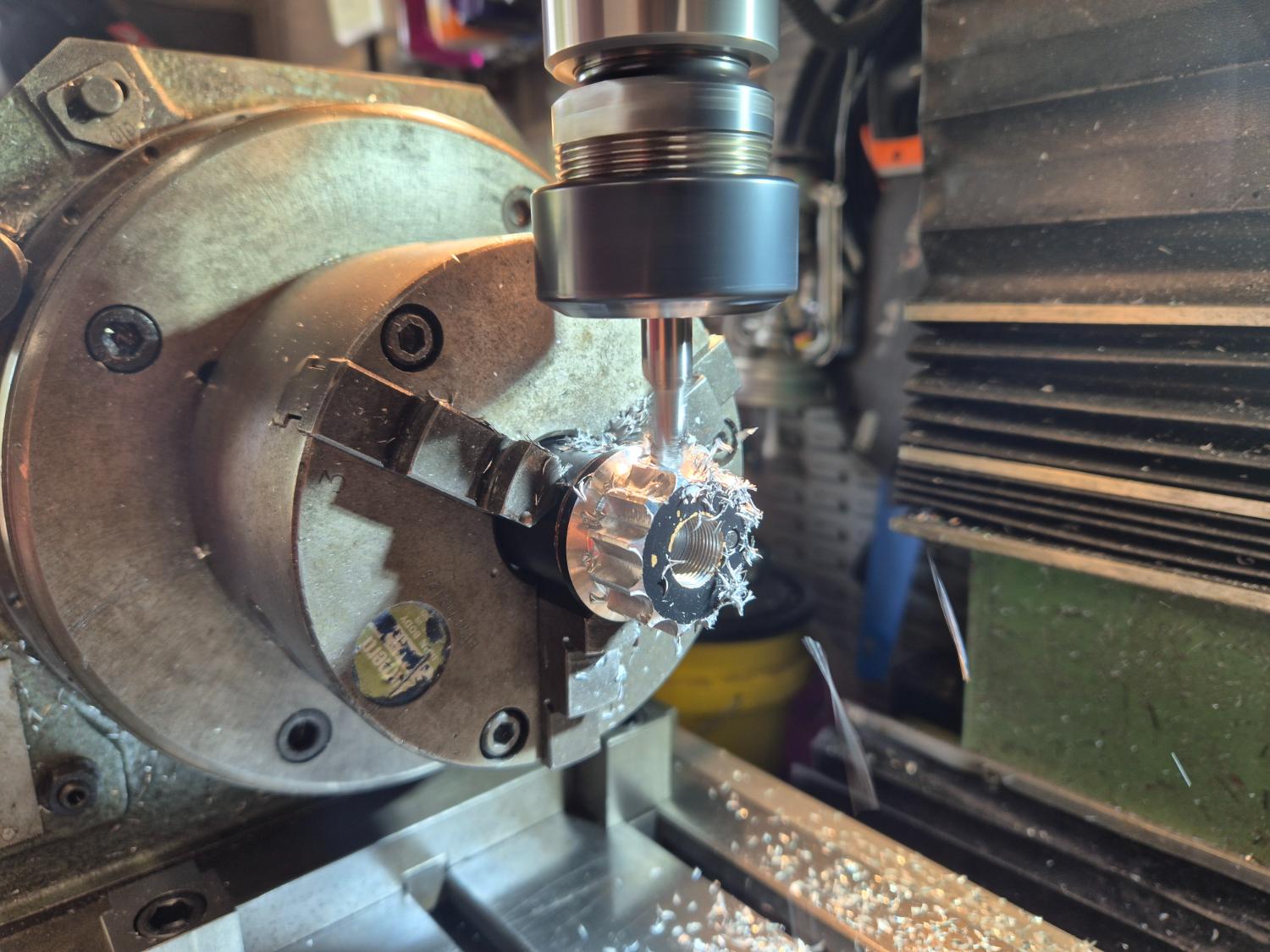

Popular Post Anonymoose Posted April 26 Popular Post Posted April 26 Somewhat productive day in the SkunkWorks. Started off by modifying a silencer/tracer unit, wasn't so fond of the grooves in it and decided to copy the Specter one, but with 12 smaller flutes. Before: After turning the OD down, it was put in the rotary table and flutes were cut with an 8mm ball-nosed end mill. Bit of lousy paint.. And now it looks so much better. Very happy with the result. Next up was a silencer that i bought for my MP5K-PDW. It's some specific type that i didn't realise at the time, but that didn't matter. I made an insert that'd screw on to the threaded outer barrel, but go over the 3-lug QD and sit closer to the front sight block. Turned from 38mm ally, bored to clear the 3 lugs, threaded inside, with an external male thread to fit a tracer and hex flats milled too. It's secured to the outer body with a grub screw. Finished + fitted: Enid_Puceflange, DanBow, Rory and 7 others 5 5

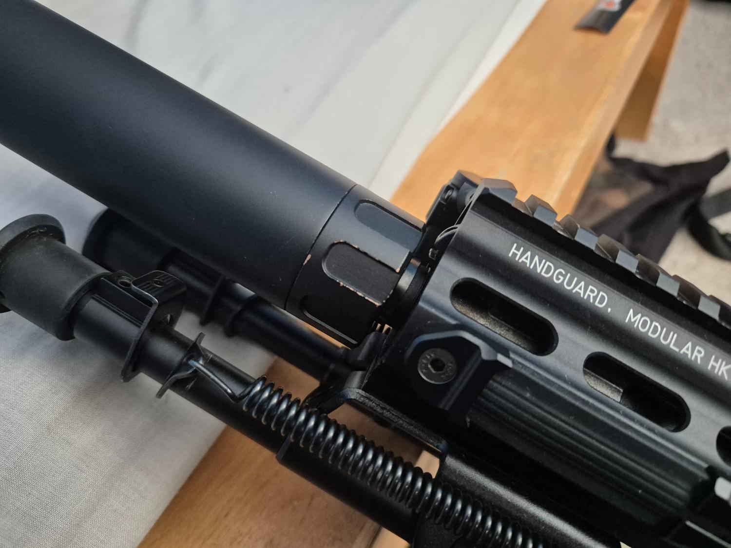

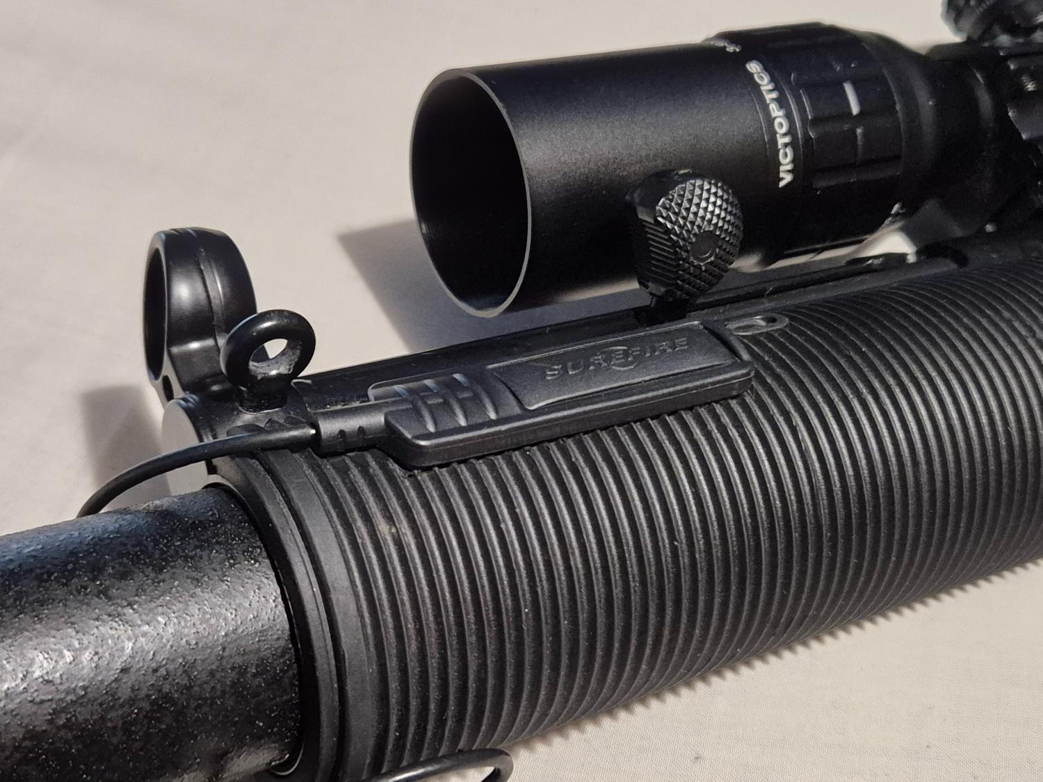

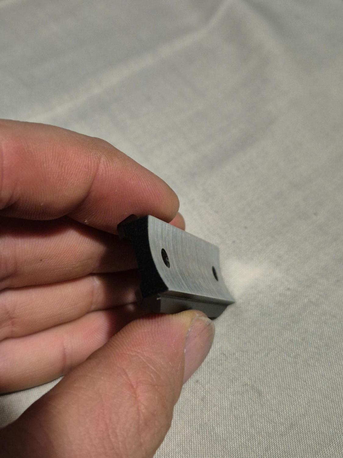

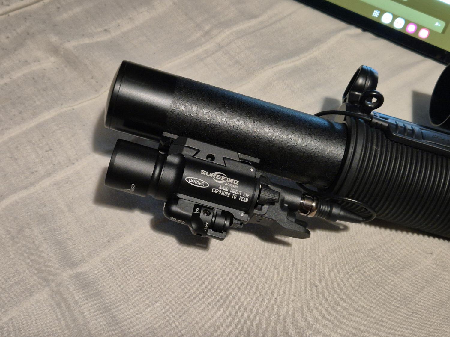

Anonymoose Posted April 26 Posted April 26 5 minutes ago, ButcherBill said: FFS M8, you're making us/ME look bad. I don't think i'll ever rival your collection. ? Another quick job, added a short rail to my MP5SD silencer to attach an X400 clone. The silencer has a small grub screw to index it so i can still keep zero when i have to remove the silencer. Spare rail piece had a suitable radius cut into it to match the silencer: Small section of the ribs were cut off the handguard to fit a remote switch, which is held on with 3M VHB tape. Tackle, TheFull9 and enzo47 2 1

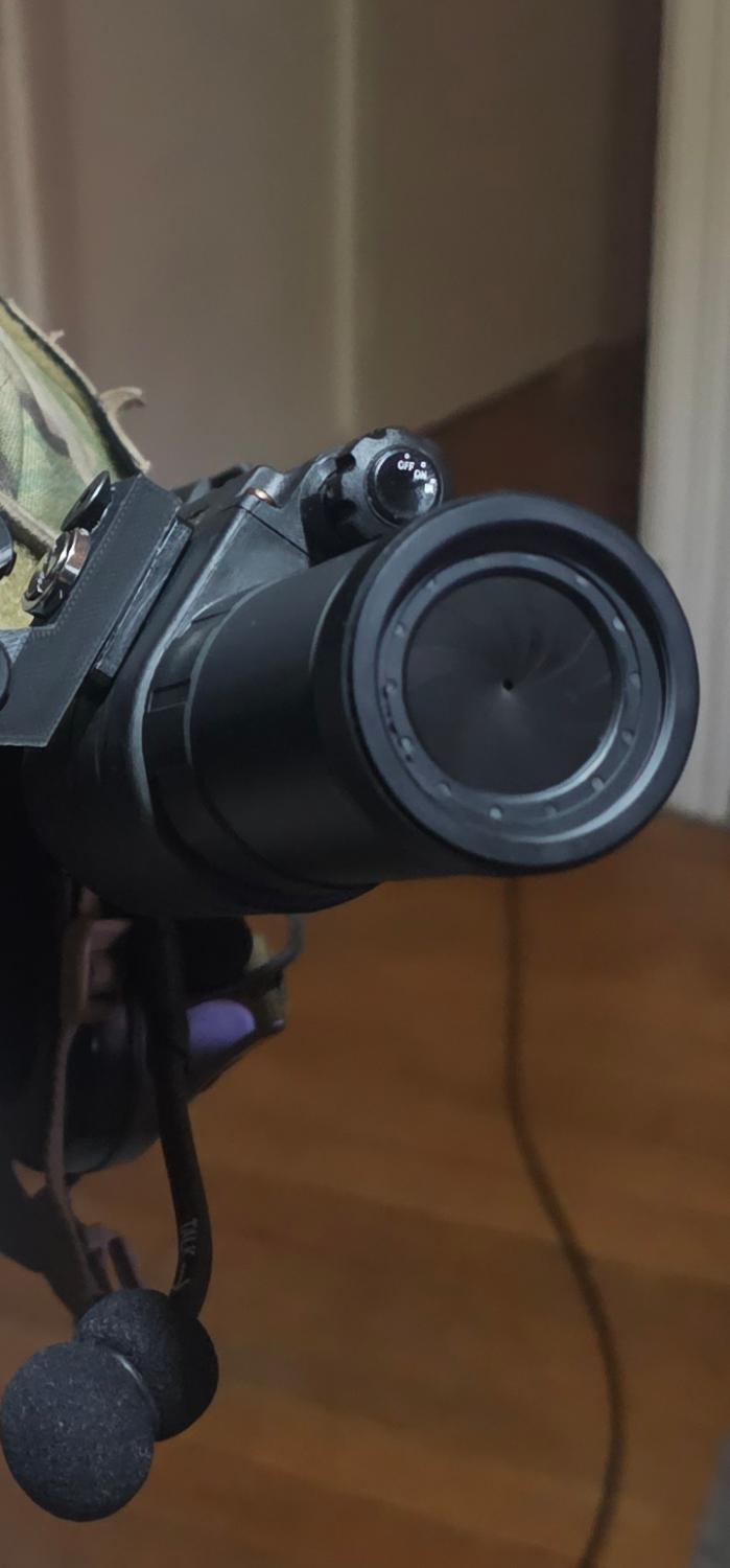

Moderators Popular Post Jez_Armstrong Posted May 6 Moderators Popular Post Posted May 6 Now with iris ? 20250505_211136.mp4 Rogerborg, Wavey_Gravey, Cannonfodder and 2 others 1 4
Wavey_Gravey Posted May 6 Posted May 6 Amazing, you should sell those, save people paying £100 per one. Are they difficult to do? Surprised your housing isn’t 3D printed too! ?
Moderators Jez_Armstrong Posted May 6 Moderators Posted May 6 50 minutes ago, Wavey_Gravey said: Amazing, you should sell those, save people paying £100 per one. Are they difficult to do? Surprised your housing isn’t 3D printed too! ? The tube that attaches to the iris is 3d printed so it slides over the end of my tube Cost me £22 per iris and 30 min of 3d printing ButcherBill and Wavey_Gravey 2

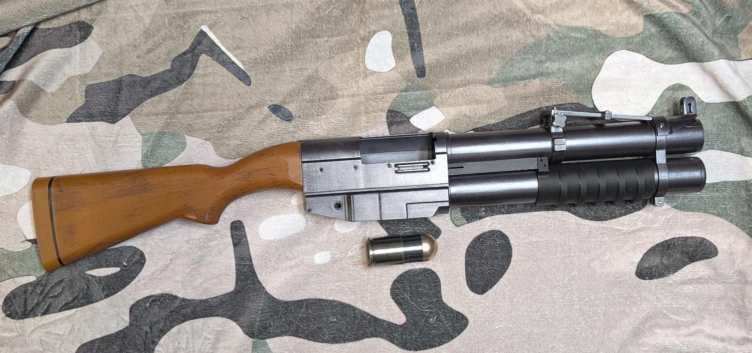

Popular Post mightyjebus Posted May 11 Popular Post Posted May 11 At a stage where I'm happy to share the progress on this. China Lake 40mm grenade launcher. It will be a 3+1 40mm pump action grenade launcher. Externals are pretty much done and just waiting on some parts to make progress on the internals. All 3D printed in a mixture of ABS, PLA and Wood filament. There are a couple of parts that I'm going to CNC in metal (looking at you pump arms) but the 3D printed ones will be good enough for testing. Scythian, GeorgePlaysAirsoft, Jacob Wright and 12 others 2 13

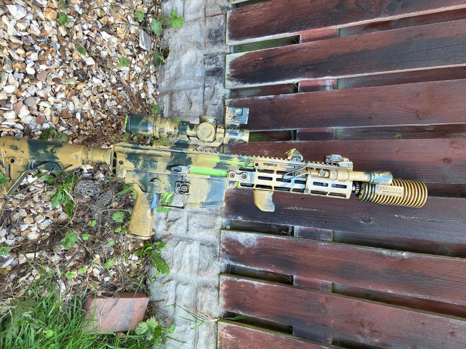

BYRNEMORGAN52 Posted August 11 Posted August 11 Did my first ever paint Job this weekend. currently waiting on the paint to fully dry before sanding it down and removing the glossy-ish finish. ButcherBill 1

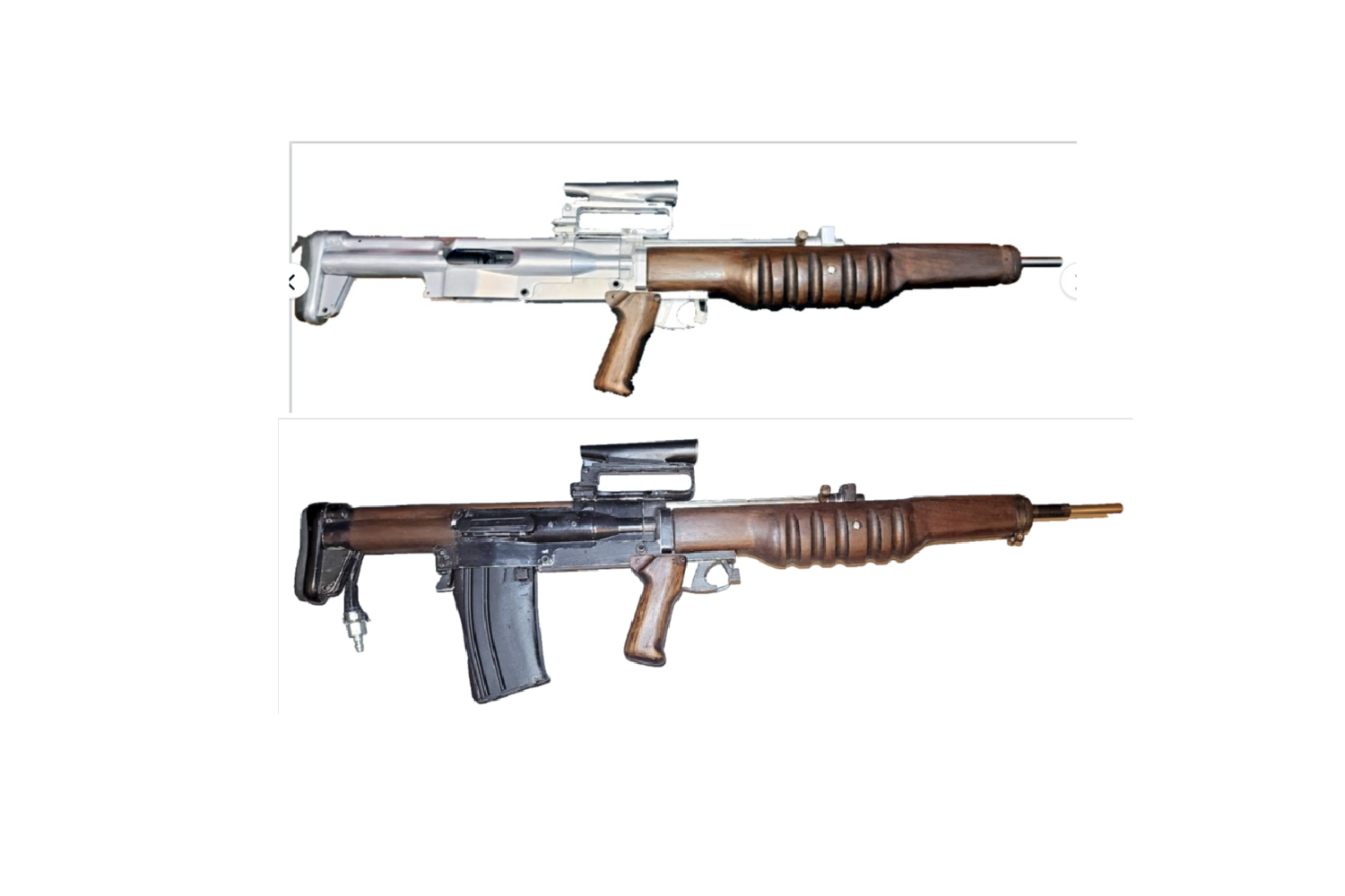

MSSNAFU Posted August 21 Posted August 21 Rifle, 6mm, No.9 Mk EM2 😁 Lozart, BYRNEMORGAN52, ButcherBill and 1 other 2 2
MSSNAFU Posted August 21 Posted August 21 56 minutes ago, MSSNAFU said: Rifle, 6mm, No.9 Mk EM2 😁 Mostly CNC Aluminium & Walnut. Still very much a prototype but I'm going to (try) to use it this weekend. HZR13 1
ButcherBill Posted August 21 Posted August 21 41 minutes ago, MSSNAFU said: Mostly CNC Aluminium & Walnut. Still very much a prototype but I'm going to (try) to use it this weekend. Extremely cool, best I could do is buy a prop. MSSNAFU, HZR13 and Nick G 3
Moderators Jez_Armstrong Posted August 21 Moderators Posted August 21 3 hours ago, Titchiemagoo said: Just need to make them adapt to light, like a sensor and motors to close them automatically. Sy fi heaven I've shifted these on now, I have Gen 3 PVS-14 now
MSSNAFU Posted August 21 Posted August 21 2 hours ago, ButcherBill said: Extremely cool, best I could do is buy a prop. Thank you 😁Its been an 'interesting' journey making it, with little previous experience using a CNC machine. A very high point was having the rare privilege of handling a real one courtesy of Jonathan Ferguson at the Royal Armouries Museum in Leeds. Low points frequently included the machine doing what I told it to do, rather than what I wanted it to do! 🙃 Egon_247, HZR13, ButcherBill and 1 other 1 1 2
