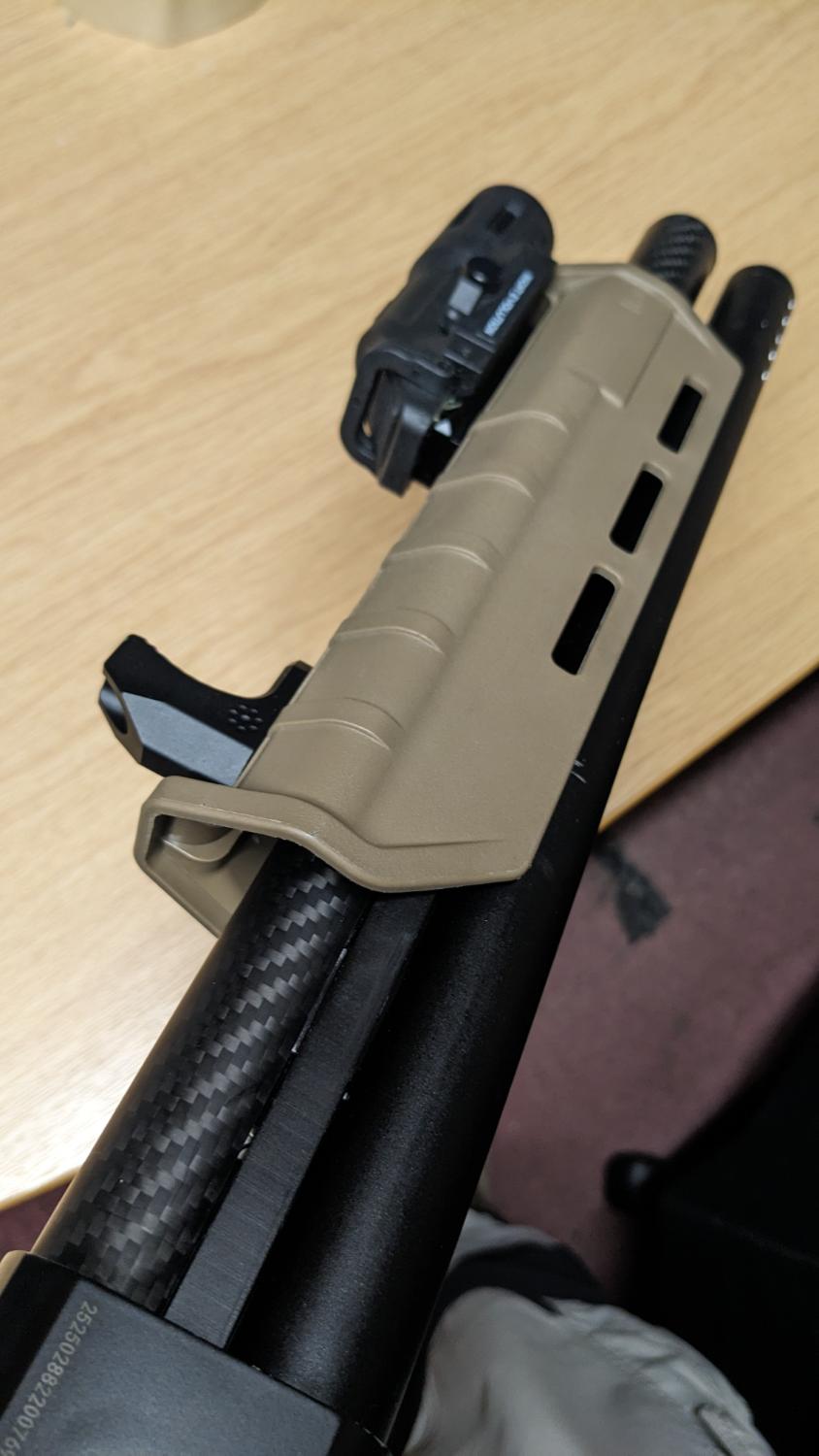

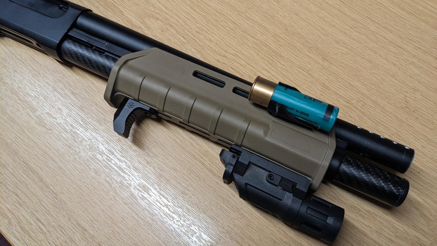

tBG_Geoff Posted January 20 Posted January 20 Made a carbon fibre magazine tube for my GE M870 as the OE chinesium one snapped. ButcherBill and Galvatron 2

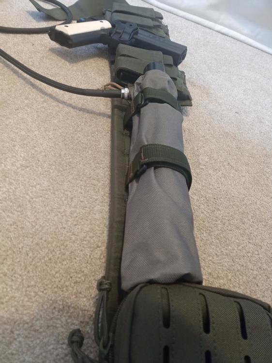

The_Lord_Poncho Posted January 31 Posted January 31 A horizontal pouch to house a little 13CI HPA bottle, keeping it nicely tucked out of the way and not bouncing around on the back of the belt. Primarily for use with my recently converted L96 with a Mancraft SDIK. I couldn't find any ready made solutions on the market, so resorted to making my own with leftover bits and bobs that I had+ a 20 year old sewing machine! ButcherBill and PopRocket123 2

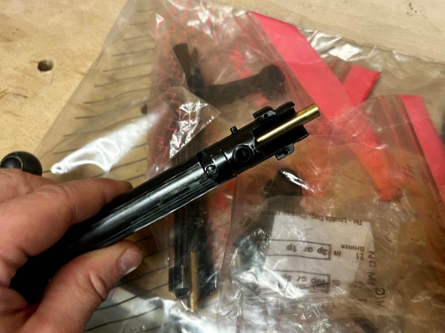

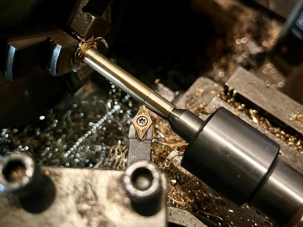

LMKipper Posted January 31 Posted January 31 Another day, another nozzle for a Tanaka - this time a set of three for @Impulse The Kar98k nozzle was a little different, in that it needed a thread running through it internally for a power restrictor.

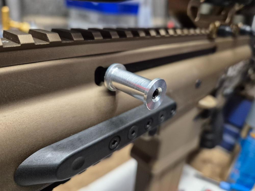

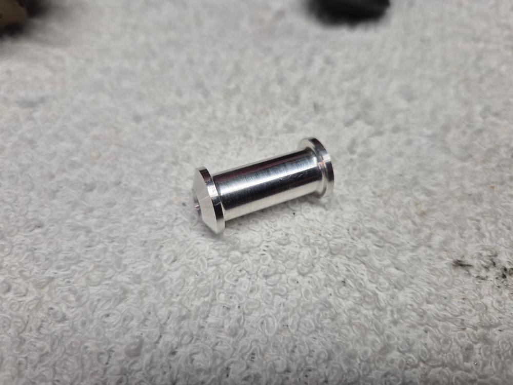

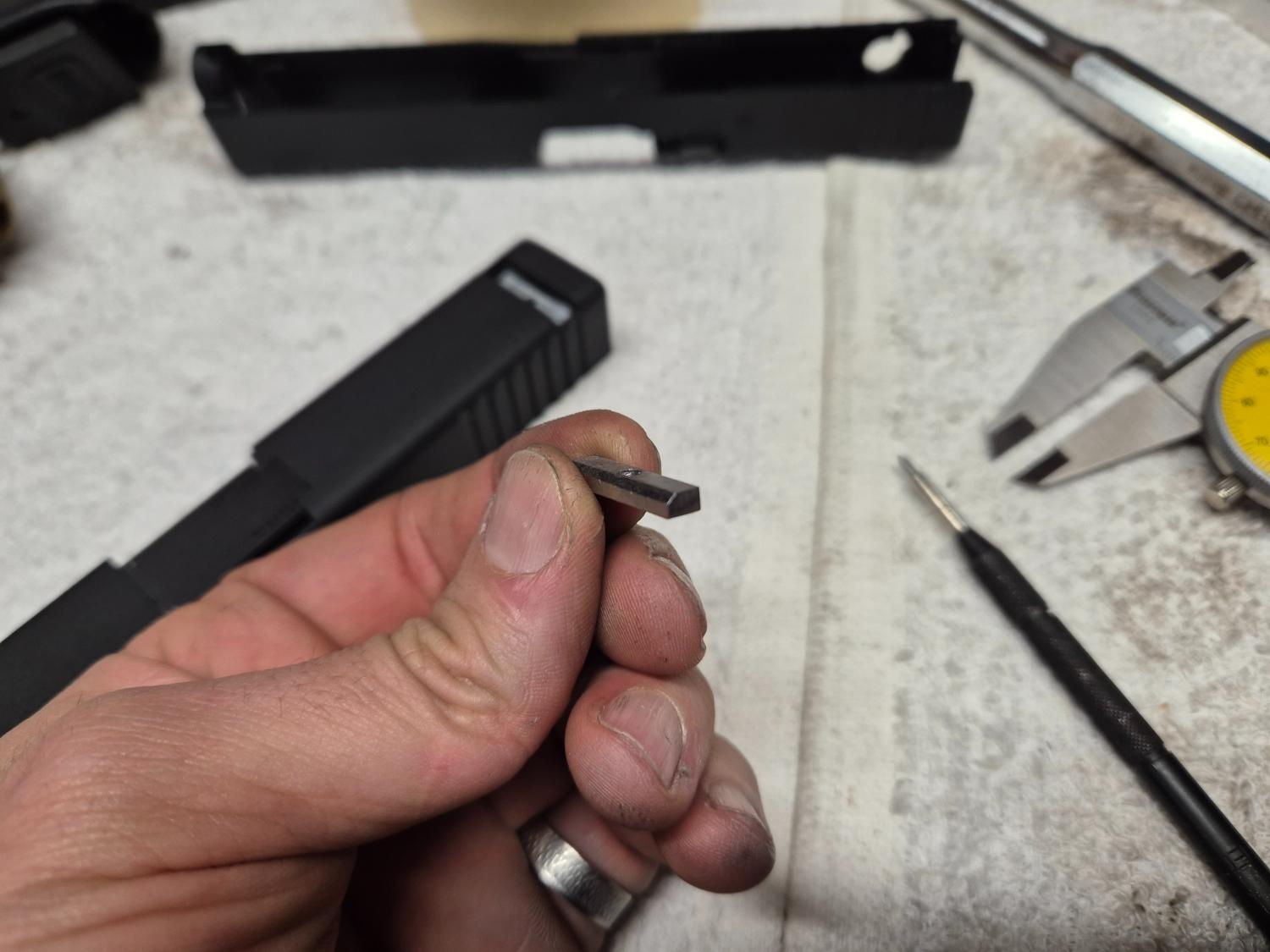

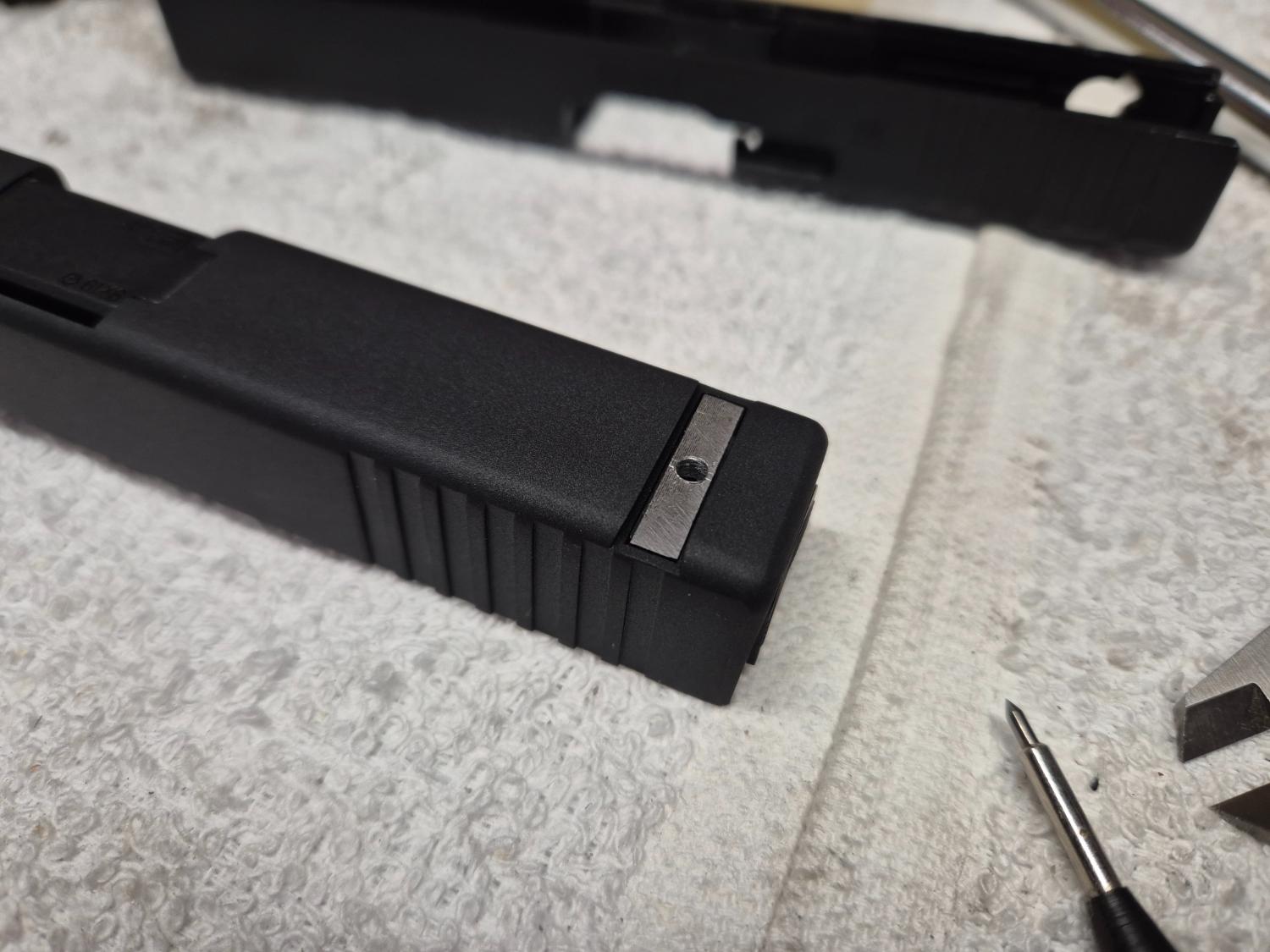

Popular Post Anonymoose Posted February 1 Popular Post Posted February 1 Few little jobs today: The barrel on my SCAR-H SSR has a necked down section just behind the flash hider that looked odd. Had a spare M16 thread protector that i bored out and cut down. Bit of test fitting and light cuts to get the flash hider clocked to have the flats vertical. It doesn't look quite right but it's better. Also made an ally charging handle for it, instead of the plastic one it came with. Just needs painting now: Then converted a spare 18C to a 17 G3 as i'm nicking the full-auto bits for another build. Some little milling cuts inside the slide and made a "spacer bar" that sits under the rear sight: Galvatron, TheFull9, ButcherBill and 2 others 3 2

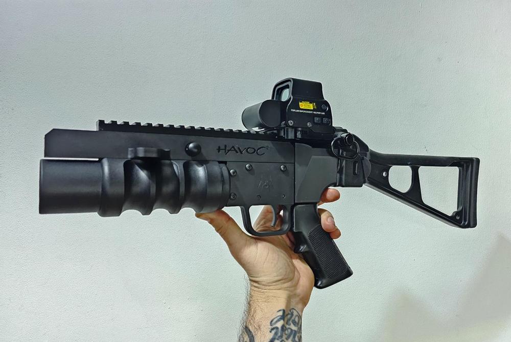

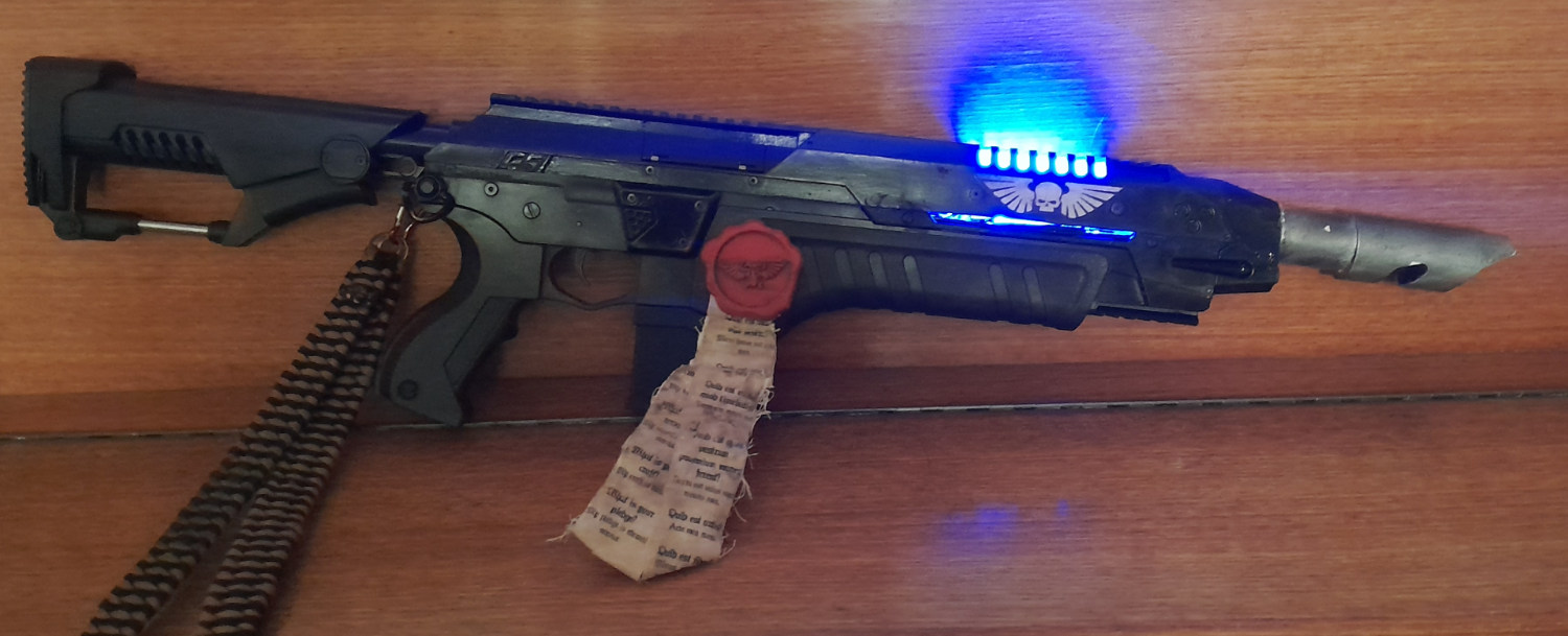

Moderators Popular Post Jez_Armstrong Posted February 1 Moderators Popular Post Posted February 1 The stand alone part for this launcher and somehow managed to get a UMP stock on it TheFull9, Galvatron, Lozart and 3 others 2 4

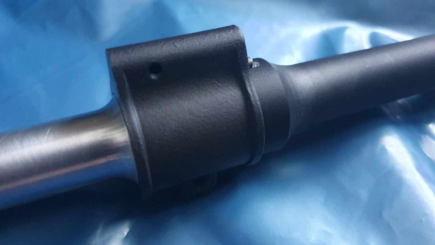

Supporters TheFull9 Posted February 2 Supporters Posted February 2 More modded than made, and not me but @Anonymoose (absolutely top bloke). Outer barrel lathed; gas block mounting area cut down from a full M16 front sight length down to the compact block length for the Geissele style gas block. Little mill cut done on the top for the locating pin. Also drilled the bottom to add a slot for the locking spring pin, since neither of the original 6 o'clock slots in the barrel for the mil spec front sight pins lined up with the hole in the new block. Mag release button hole in a totally unknown blank AEG receiver set filed just slightly, now fits the BJ Tac Geissele mag release which EBA listed as AEG, but I reckon is probably GBB. I believe I've fitted a GBB mag release to my Krytac LVOA though so fingers crossed this will actually function correctly once the gearbox goes in. Anonymoose, Enid_Puceflange, Lozart and 1 other 2 1 1

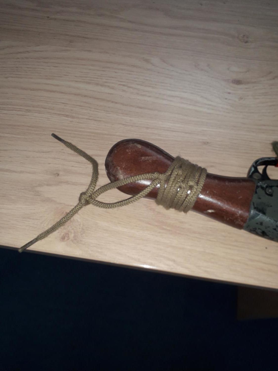

Cannonfodder Posted February 2 Posted February 2 Nowhere near as fancy as other builds here but meh. I decided to do a "paracord" (a boot lace really) wrap and sling loop on my GE 870 as there's no way to attach a sling. Nowhere near the prettiest job but it does what it's supposed to ButcherBill and Galvatron 2
