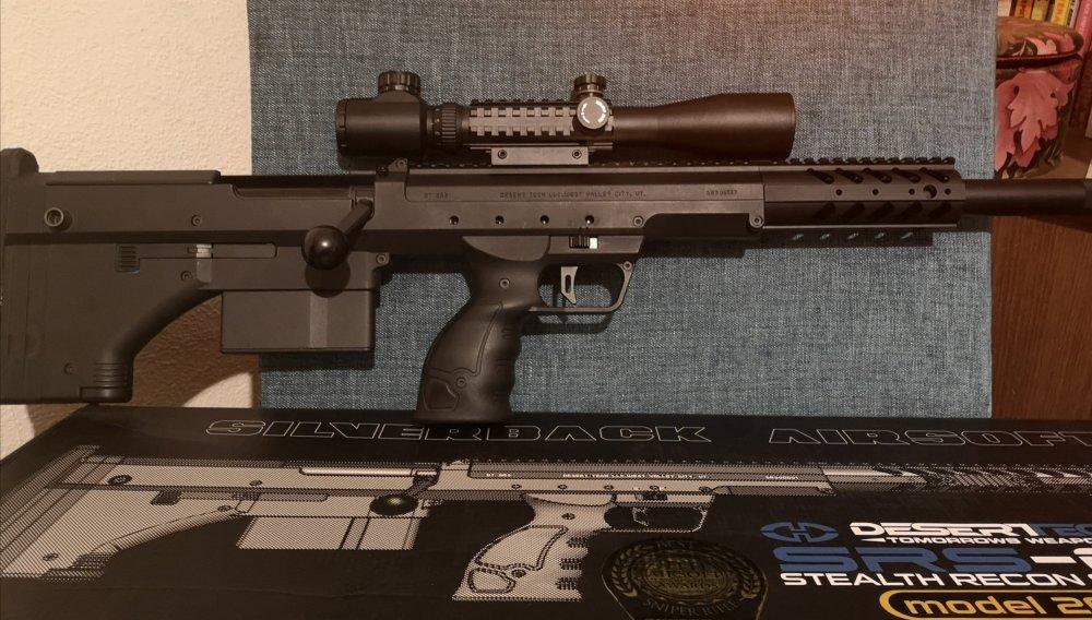

Immortal Posted January 8, 2020 Share Posted January 8, 2020 3D printed ext part (need to find some button head screw or print some washers). Steveocee 1 Link to comment Share on other sites More sharing options...
Steveocee Posted January 10, 2020 Share Posted January 10, 2020 Wow! Took it apart again the other evening and wiped out all the grease out of the cylinder guide area and off the outside of the cylinder. Relubed the cylinder with some Muc-Off Dry Lube and my god what an improvement! So much smoother bolt pull. Immortal 1 Link to comment Share on other sites More sharing options...
Immortal Posted January 10, 2020 Share Posted January 10, 2020 11 minutes ago, Steveocee said: Wow! Took it apart again the other evening and wiped out all the grease out of the cylinder guide area and off the outside of the cylinder. Relubed the cylinder with some Muc-Off Dry Lube and my god what an improvement! So much smoother bolt pull. I tried the WD40 version PTFE, amazing difference isn't it. I've done the same with my VSR too. I also used the Muc-off disc brake cleaner on the VSR trigger set too and dry lubed that. I'll do the same with the SRS trigger once it's had a bit of use. Sooo much better than wet stuff. Steveocee 1 Link to comment Share on other sites More sharing options...

Steveocee Posted January 16, 2020 Share Posted January 16, 2020 Just got home to find a parcel from Magya Posta; Faceless 509mm barrel Faceless R-Hop patch Faceless 100% seal Got to say the finish on the inside of the barrel is immense! Looks out of this world and that's before I've run it through with 99% alcohol. >Also got some heat shrink to test on the spring guide. The original one I bought was too thick to get the spring over but have found a "thin wall" version which should be better than electrical tape. Will link if it works. >Aaaaaaand my order of 19mmx2.5mm O-rings has arrived so I can fix my Mk23 mags hooray! Immortal 1 Link to comment Share on other sites More sharing options...
Steveocee Posted January 16, 2020 Share Posted January 16, 2020 Just cut a piece off, probably got enough to do 10 spring guides on 1 order of this stuff. Fit's perfectly, used a heat gun rather than a lighter. As it's thin it doesn't try to hold shape so pulled tight one side before the other but has evened out well. Silverback spring fits over it with little to no resistance at all although will give it a think layer of grease before installing. For £3.29 I'm happy. https://www.ebay.co.uk/itm/Thin-Wall-2-1-Heatshrink-Tubing-Black-Heat-Shrink-Ultra-Thin-Tubing-Per-1-Metre/273904251393?ssPageName=STRK%3AMEBIDX%3AIT&var=573754623689&_trksid=p2057872.m2749.l2649 Immortal 1 Link to comment Share on other sites More sharing options...
Steveocee Posted January 20, 2020 Share Posted January 20, 2020 OK so thin wall heatshrink v1 didn't work, it turns out that its not got glue internally like the thicker stuff has so after a few bolt pulls it started sliding up the spring guide. Installation v2 is going to involve the use of a pritt stick. Skara 1 Link to comment Share on other sites More sharing options...
Skara Posted January 20, 2020 Share Posted January 20, 2020 4 hours ago, Steveocee said: OK so thin wall heatshrink v1 didn't work, it turns out that its not got glue internally like the thicker stuff has so after a few bolt pulls it started sliding up the spring guide. Installation v2 is going to involve the use of a pritt stick. I reckon scoring the spring guide could help the heat shrink sticking more firmly. Link to comment Share on other sites More sharing options...
Steveocee Posted January 20, 2020 Share Posted January 20, 2020 2 minutes ago, Skara said: I reckon scoring the spring guide could help the heat shrink sticking more firmly. It did cross my mind, as did putting a couple of ribs out of electrical tape but the heat shrink is incredibly supple stuff. It's almost like heatshrink velvet because it's so thin. Link to comment Share on other sites More sharing options...

Hedzshot Posted February 8, 2020 Share Posted February 8, 2020 On 07/02/2020 at 14:52, Steveocee said: You literally only need an M150 and they're awesome. Hope 16th goes better for you. Thx man, grabbed some better eye pro and the scope is obviously mounted so it's already better than Sunday. Whilst I'm here... The bolt pull or last centimetre of it ( i know this is not a new thing), i removed the trigger sear spribg, no different. Its lubed up with silicone and dry ptfe. Am i right in assuming that the only way to have a buttery bolt is to upgrade the piston - wasp/silverback etc? Link to comment Share on other sites More sharing options...
Steveocee Posted February 8, 2020 Share Posted February 8, 2020 @Hedzshot maybe have a couple of games with it. Mine was a bit stiff at the end but 2 days use and it is effortless. Link to comment Share on other sites More sharing options...
Hedzshot Posted February 8, 2020 Share Posted February 8, 2020 1 hour ago, Steveocee said: @Hedzshot maybe have a couple of games with it. Mine was a bit stiff at the end but 2 days use and it is effortless. Fair enuf, thx dude Link to comment Share on other sites More sharing options...
Steveocee Posted February 9, 2020 Share Posted February 9, 2020 Great run out yesterday. Using an M150 spring and medium SBA airbrake head set up for hopping 0.43's was making about 480 on 0.2's through the chrono (yeah I know but site dictated you chrono'd on 0.2s). Have dropped an order into skirmshop for a Rapax 2J spring though to get an easier bolt pull and hopefully combining that with the faceless 6.04 & rhop I will be able to use the long airbrake and still make about 2.2J. Only a few things left I want to get now. VMP for 1 and I'm thinking of a 16" outer with muzzlebrake and dtss barrel stabiliser (cheaper than a 420mm barrel) Link to comment Share on other sites More sharing options...
