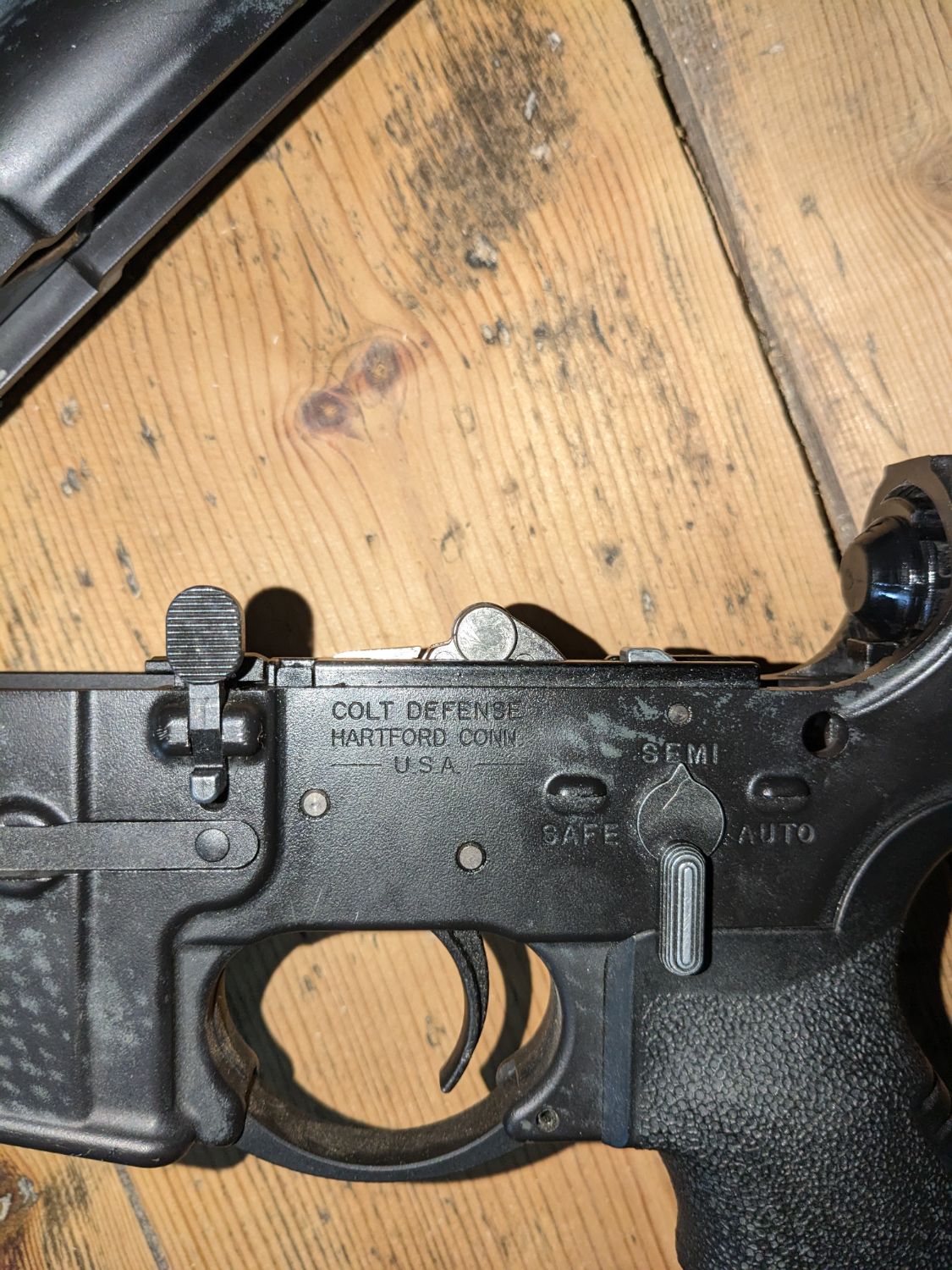

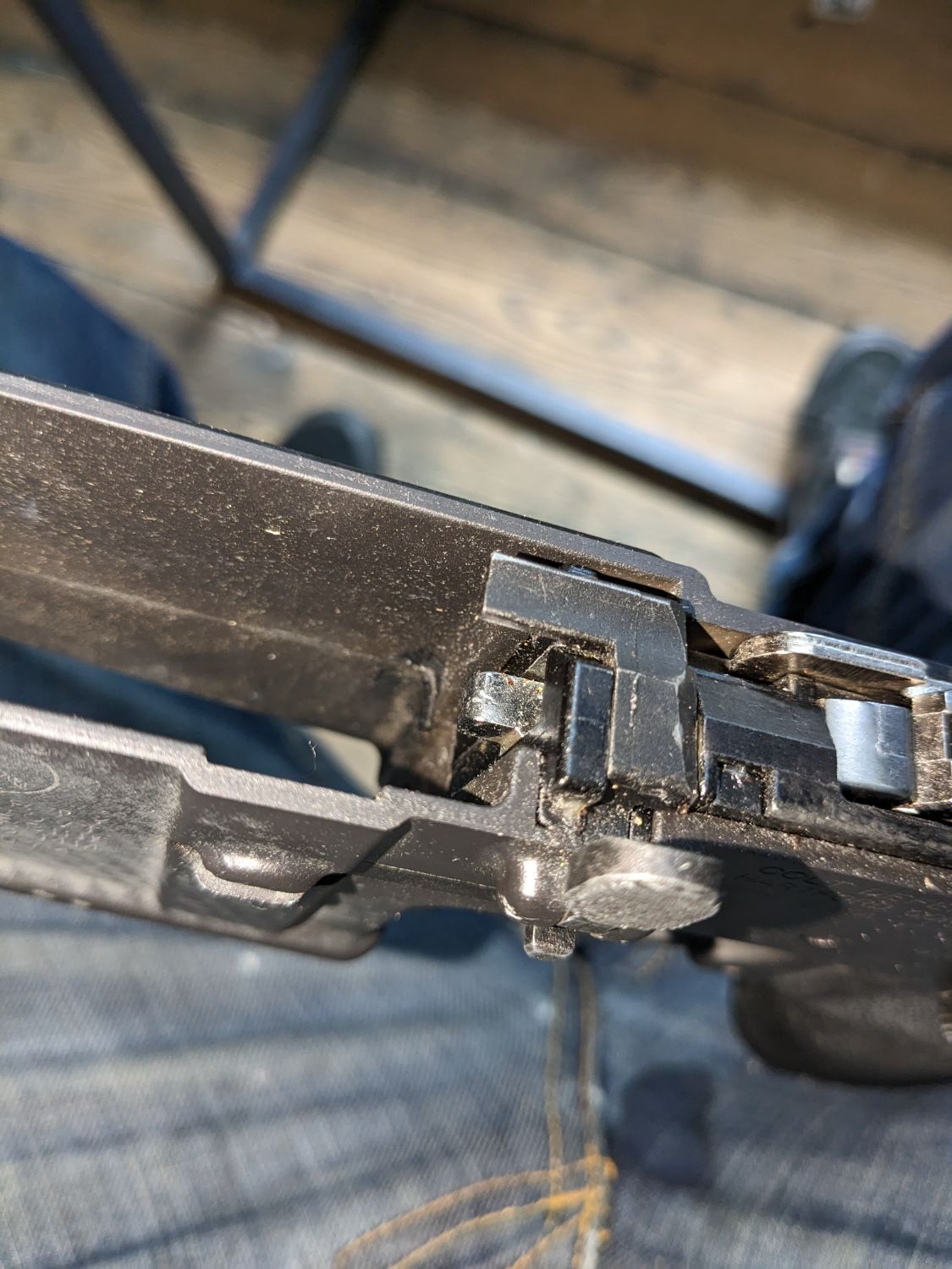

Emergencychimps Posted May 15, 2023 Posted May 15, 2023 (edited) 31 minutes ago, Davegolf said: What have you got as lube on the BCG and piston? - Have not lubed the piston, have applied a tiny amount of gun oil on the BCG. Does the BCG pull back effortlessly and return very quickly? Yes, works exactly as I'd expect. Does the hammer strike nice and hard and to full extension? I think so, sounds like it does, image incoming Edited May 15, 2023 by Emergencychimps
Davegolf Posted May 15, 2023 Posted May 15, 2023 The part you have pictured popping out is the reset roller. The hammer is kinda where the mag release is, it fires out and pushes the mag gas exit valve Emergencychimps 1
Emergencychimps Posted May 15, 2023 Posted May 15, 2023 (edited) Every day is a school day. Yeah, the hammer is coming out quite punchy, about 4 mm Edited May 15, 2023 by Emergencychimps
