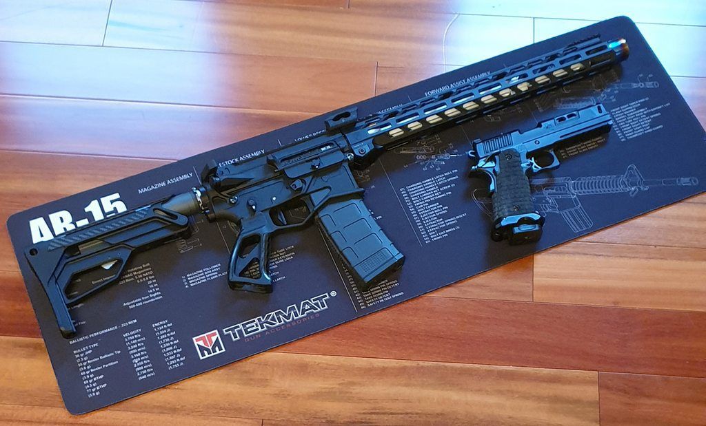

Raydee Posted January 28, 2023 Share Posted January 28, 2023 (edited) Hi, Still on my way to finish this 2021 Fortis custom (MWS base) : All RS equipment parts such as FORTIS, SLR Rifleworks, Battlearms, ocalarworks Trijicon MRO Mount, Timber Creeck, Radian, V Seven, Strike industries etc. Internally, full custom parts : G&P custom Triggerbox (brass version), Gunsmodify, Iron Airsoft, Airsoft Artisan, PDI, etc. Next to come : - Trijicon MRO - Fortis Handstop ou Aeroknox Skeleton Handstop - Railscales Cheers, Edited January 29, 2023 by Raydee Link to comment Share on other sites More sharing options...

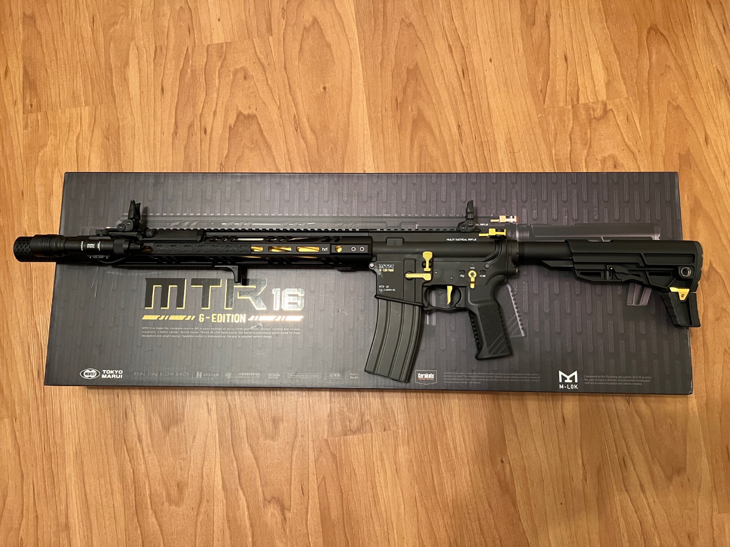

sloppyclock Posted February 2, 2023 Share Posted February 2, 2023 (edited) Hello everyone, just thought I'd share my MTR16 I recently bought. Never had a gbbr before and was always amazed at TMs quality over the years and finally bit the bullet. Just thought I'd share my thoughts and experience with it so far along with some questions. The G Edition was pretty much the only version available when I was shopping for one so it wasn't my first pick originally but every other model had a 2 month plus pre order wait time. The gold accents are kinda tacky but I do like that it came with the ambi selector, mag release, bolt release and the flat trigger. I've never shot a gbbr before so I was quite surprised with the recoil out of the box with propane. Very satisfying. Internally it's currently stock other than a GunsModify reinforced nozzle reset. I have the dynamics precision reinforced valve blocker kit on the way as well. Externally it currently has PTS flip up sights + hand stop, KAC CQB style suppressor w/ cloak foam inserts, BCM gunfighter MLOK rail panels and StreamLight ProTac HL-X. Waiting on a real steel EOTech EXPS3-4 and G33 magnifier to come in from back order. Now for a few questions: How does factory stock and MLOK rail system come off? I have a 10.5" one coming in along with a new outer barrel and I can't seem to find a disassembly video/guide for the rail and the stock isn't like the normal M4 style where I can pull the lever the other way to remove the stock. Maybe I'm just dumb? Stock buffer, is it common for them to break? I had mine break into multiple pieces with only about 1000-1200 rounds thru it and have a GunsModify one on the way to replace it. Assuming using propane caused the issue? Edited February 3, 2023 by sloppyclock Typo Link to comment Share on other sites More sharing options...

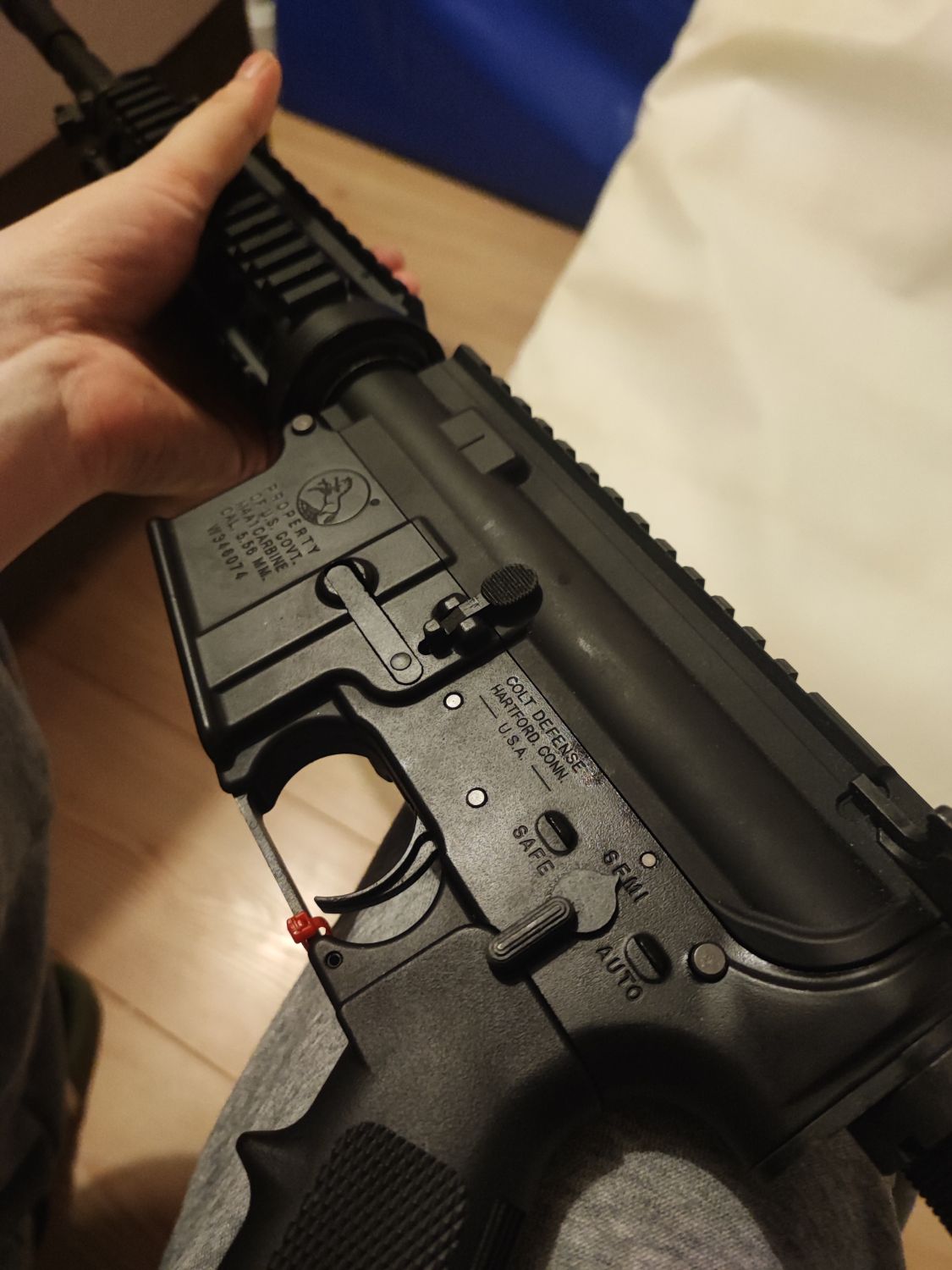

cart3rlfc Posted February 14, 2023 Share Posted February 14, 2023 Does anyone else have abit of a mismatch finish between receiver's? Mine looks unique to other mws I've seen. Link to comment Share on other sites More sharing options...
KirbyHCI Posted February 14, 2023 Share Posted February 14, 2023 On 14/02/2023 at 12:07, cart3rlfc said: Does anyone else have abit of a mismatch finish between receiver's? Mine looks unique to other mws I've seen. Expand Definitely interesting Mine's matching between upper and lower. Hopefully it doesn't bug you and you can appreciate the uniqueness, I kinda dig it! Unrelated; I'm not too keen on heavily modifying mine just yet, but I want to swap out the barrel for the shortest one I can while keeping most of it stock. I have the M4A1 with 20mm railed handguard model (14.5in barrel? I think) - Anyone have any recommendations for outer barrels that would fit an otherwise stock MWS? Heck even if just a link to a stock TM part, just the short one (10.5?). I should have got the CQB-R to begin with but I was being impatient. I also want to swap to a grip without the damn finger groove, it's always bugged me, but I don't think that matters so much to seek recommendations for. Link to comment Share on other sites More sharing options...
