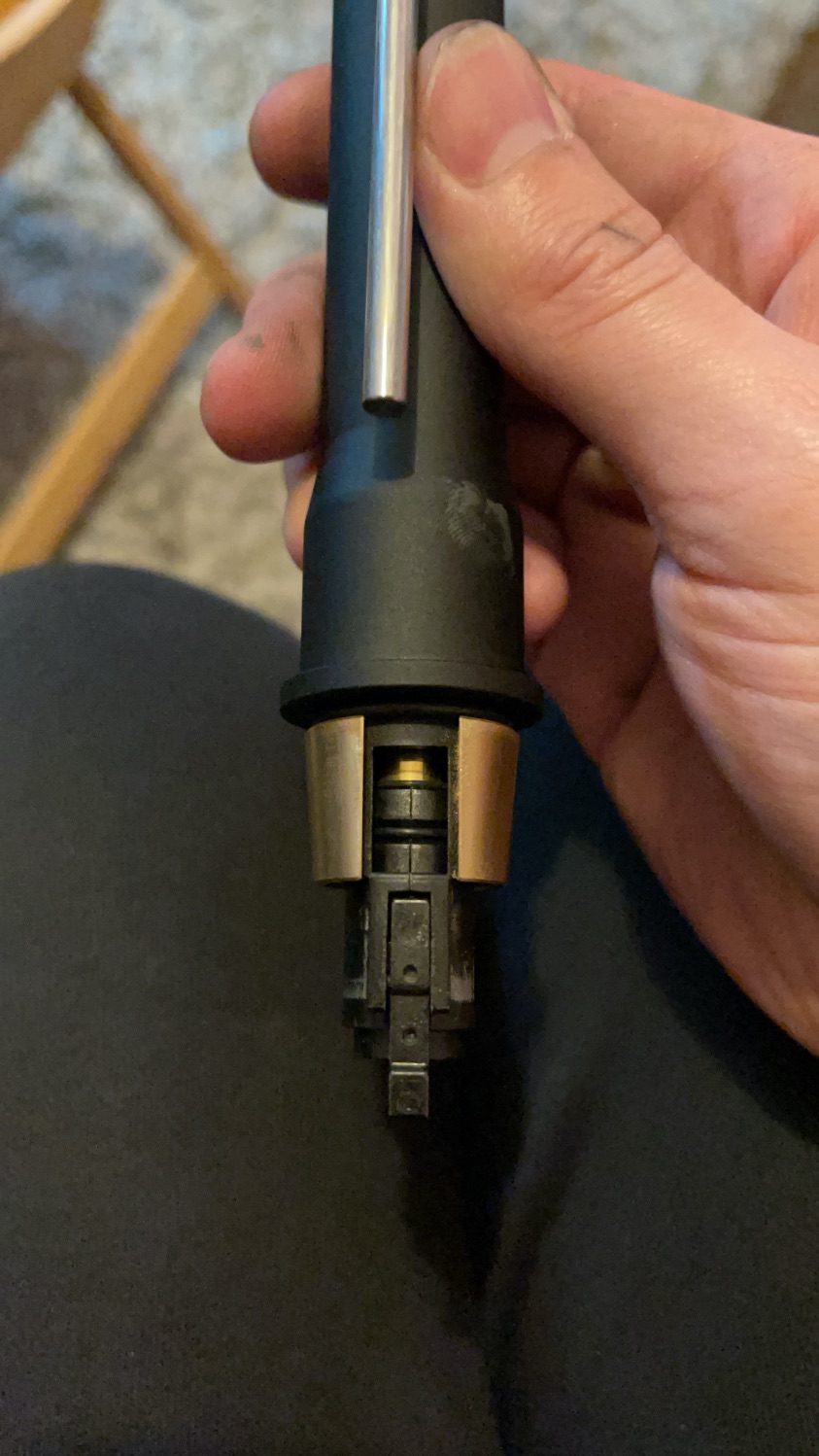

gunbod007 Posted March 3, 2021 Posted March 3, 2021 So I have the Angry gun L119A2 10 inch outer barrel. Doesn't seem to fit the standard TM inner? What have I done!? quango2k 1
AlphaBear Posted March 3, 2021 Posted March 3, 2021 3 minutes ago, gunbod007 said: So I have the Angry gun L119A2 10 inch outer barrel. Doesn't seem to fit the standard TM inner? What have I done!? Let me loop in @Uncle Paulyhe may be able to advise as I believe he had some interesting episodes with Angry Gun barrels ?
gunbod007 Posted March 3, 2021 Posted March 3, 2021 I am this close to just using a small hand file to make it fit, but I don't know how tight this seal has to be for performance etc. Clearly not that important according to angry gun
AlphaBear Posted March 3, 2021 Posted March 3, 2021 Just hold ya horses till you hear back from a few peeps on here. Have a beer or something in the meantime. gunbod007 1
Davegolf Posted March 3, 2021 Posted March 3, 2021 Assuming you mean the O ring holding the two halves of the hop unit together, it’s primary function is just that, and stability. No O rings should be soaked in silicone with the sole exception of gas magazines. I would just tickle the outer barrel window larger, so it has the same fit as the TM outer.
gunbod007 Posted March 3, 2021 Posted March 3, 2021 1 hour ago, Davegolf said: Assuming you mean the O ring holding the two halves of the hop unit together, it’s primary function is just that, and stability. No O rings should be soaked in silicone with the sole exception of gas magazines. I would just tickle the outer barrel window larger, so it has the same fit as the TM outer. The TM one is actually quite loose tbh and easily slides the inner barrel out. Tried widening slightly using a screw driver but the metal is so soft.
AlphaBear Posted March 4, 2021 Posted March 4, 2021 For the who don't know here is the Eagle6 MWS barrel assembly video.... @gunbod007at around timestamp 3.09min onwards you can see the inner barrel being inserted into the marui outer barrel. If the hop unit doesn't slide in then I suspect the tolerance of the Angry Gun outer barrel aperture is too tight and needs a tad filing out to accommodate the Marui hop unit.. Maybe the angry gun barrel is made specifically for an angry gun hop unit to fit? There's a thought eh? SSPKali and gunbod007 1 1

gunbod007 Posted March 4, 2021 Posted March 4, 2021 Update on the Angry Gun L119A2 outer barrel: Got it machined down and inner now fits in. All assembled. But should The BB just slide out the barrel when loaded if the Hop Up is turned all the way off? I am pretty sure this didn't happen before with the standard outer barrel but I rarely have hop fully off. I still won't have to hop fully off but could this be a warning sign that something is wrong or misaligned? To be clear. If I cock the weapon and the Hop is fully off. The BBs will literally just roll out the barrel without even being fired. And it's not like it even needs to face straight down. Just the nozzle moving forwards sends the bbs rolling out. So this is making me think I have fucked up the air seal and something isnt sitting right
Uncle Pauly Posted March 4, 2021 Posted March 4, 2021 23 hours ago, AlphaBear said: Let me loop in @Uncle Paulyhe may be able to advise as I believe he had some interesting episodes with Angry Gun barrels ? 20 hours ago, Davegolf said: ...I would just tickle the outer barrel window larger, so it has the same fit as the TM outer. ^ This ? I had to take a file to mine and open up the barrel window as Dave suggests. Very easy to do. Just go slow and check the fit frequently.
gunbod007 Posted March 4, 2021 Posted March 4, 2021 6 minutes ago, Uncle Pauly said: ^ This ? I had to take a file to mine and open up the barrel window as Dave suggests. Very easy to do. Just go slow and check the fit frequently. Yep I had someone help me machine it down slightly. Any experience with the BBs just rolling out? Very concerned I may have a bad seal or misaligned something now. Going to buy a chronological just to double check.
alxndrhll Posted March 4, 2021 Posted March 4, 2021 33 minutes ago, gunbod007 said: Yep I had someone help me machine it down slightly. Any experience with the BBs just rolling out? Very concerned I may have a bad seal or misaligned something now. Going to buy a chronological just to double check. Certainly not something I’m an expert with when it comes to GBBRs, but as far as I’m aware mechanically there is very little difference between GBB, HPA and AEGs when it comes to loading/loading nozzles. A BB running down a barrel with the hop off is entirely normal in many cases. It’s not so much to do with the ‘air seal’ as it is the lip tension in your hop unit. Some hop rubbers will have more tension, some will have less. I could be entirely misremembering but I believe Maple Leaf buckings have more lip tension than most stock buckings... but I’ve been through so many different brands of bucking on so many different RIFs at this point I get lost. If the rubber has a lower amount of tension on the lips it’s often the contact patch alone being depressed into the chamber that prevents them rolling down of their own free will. Conversely, too much lip tension can wear out/break a loading nozzle prematurely. You have all the tools available to you to verify your results. Rather than speculate ‘I don’t think this happens with the stock components in place’, check them. Don’t be lazy, reinstall the original parts and see how it’s performing.

gunbod007 Posted March 4, 2021 Posted March 4, 2021 18 minutes ago, alxndrhll said: Certainly not something I’m an expert with when it comes to GBBRs, but as far as I’m aware mechanically there is very little difference between GBB, HPA and AEGs when it comes to loading/loading nozzles. A BB running down a barrel with the hop off is entirely normal in many cases. It’s not so much to do with the ‘air seal’ as it is the lip tension in your hop unit. Some hop rubbers will have more tension, some will have less. I could be entirely misremembering but I believe Maple Leaf buckings have more lip tension than most stock buckings... but I’ve been through so many different brands of bucking on so many different RIFs at this point I get lost. If the rubber has a lower amount of tension on the lips it’s often the contact patch alone being depressed into the chamber that prevents them rolling down of their own free will. Conversely, too much lip tension can wear out/break a loading nozzle prematurely. You have all the tools available to you to verify your results. Rather than speculate ‘I don’t think this happens with the stock components in place’, check them. Don’t be lazy, reinstall the original parts and see how it’s performing. Yeah I have checked, it doesn't occur with the standard outer barrel.
AlphaBear Posted March 4, 2021 Posted March 4, 2021 I just checked if a BB rolls out of mine (been a long time since I last fired a BB out of it) . Using as six-G nub, Marui hop rubber and zero hop (I do believe) my BB stayed in the hop unit. However, an ever so slight touch made it roll out... when I mean a slight touch it was like feather touch light...
