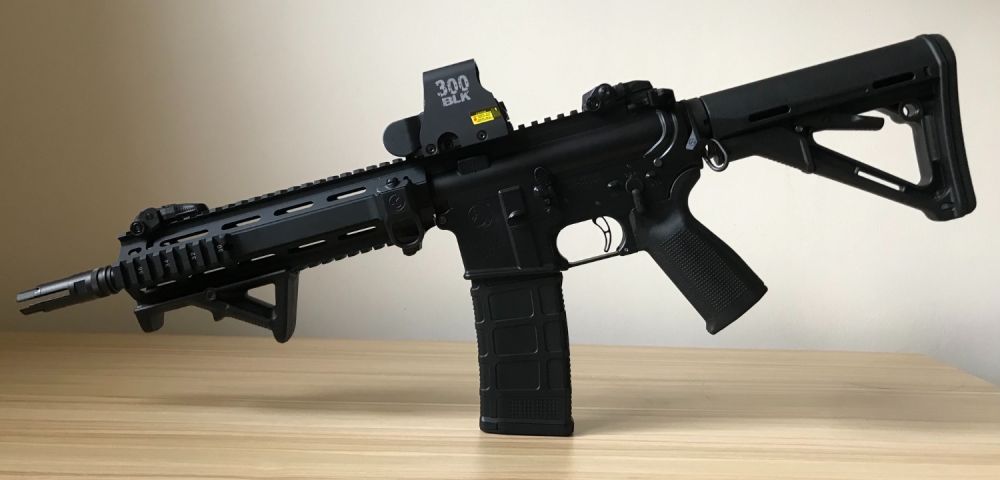

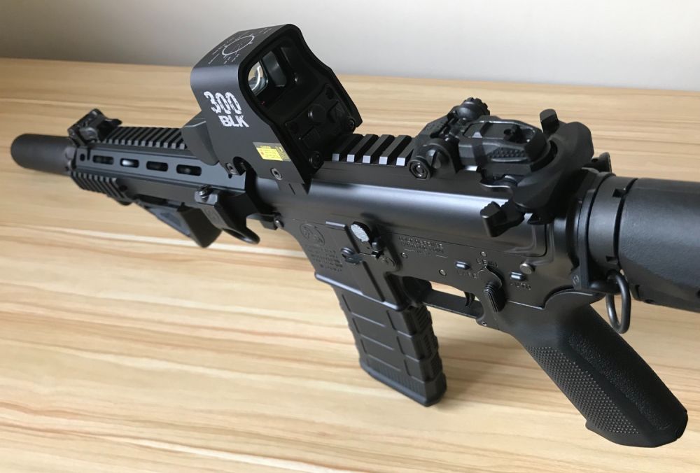

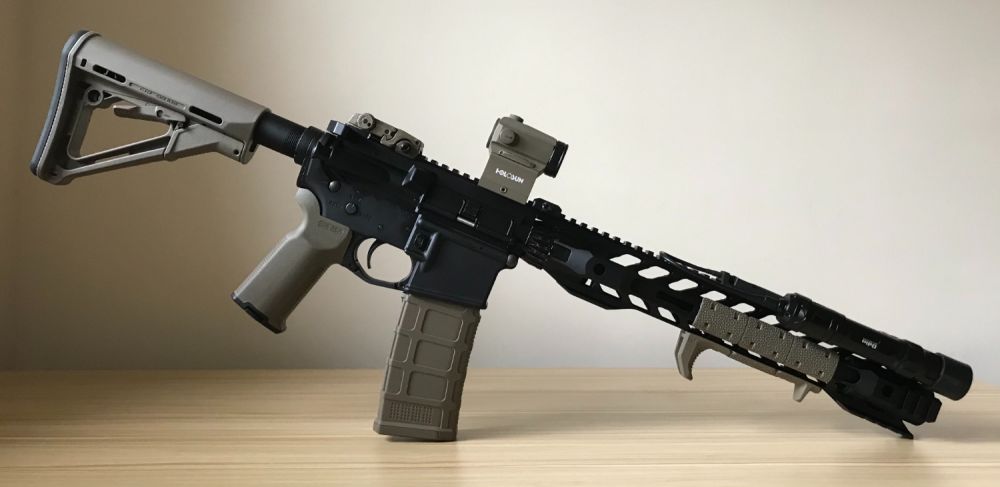

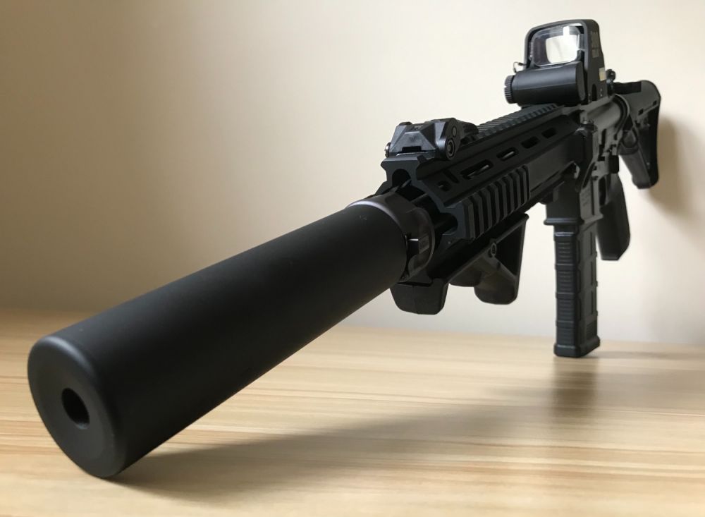

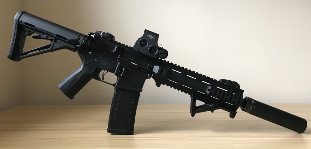

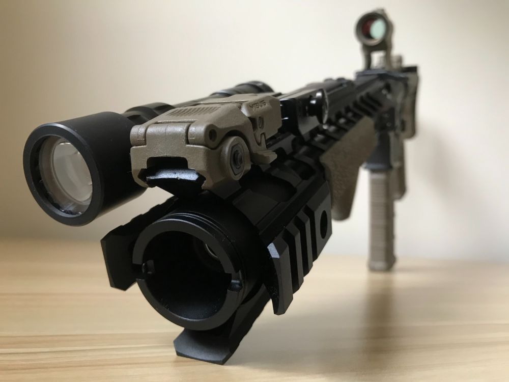

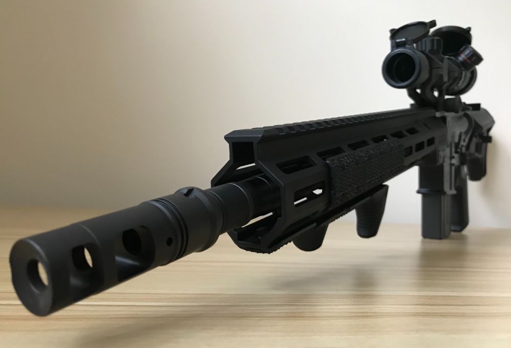

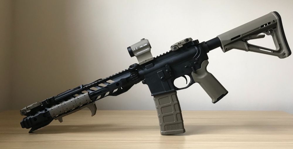

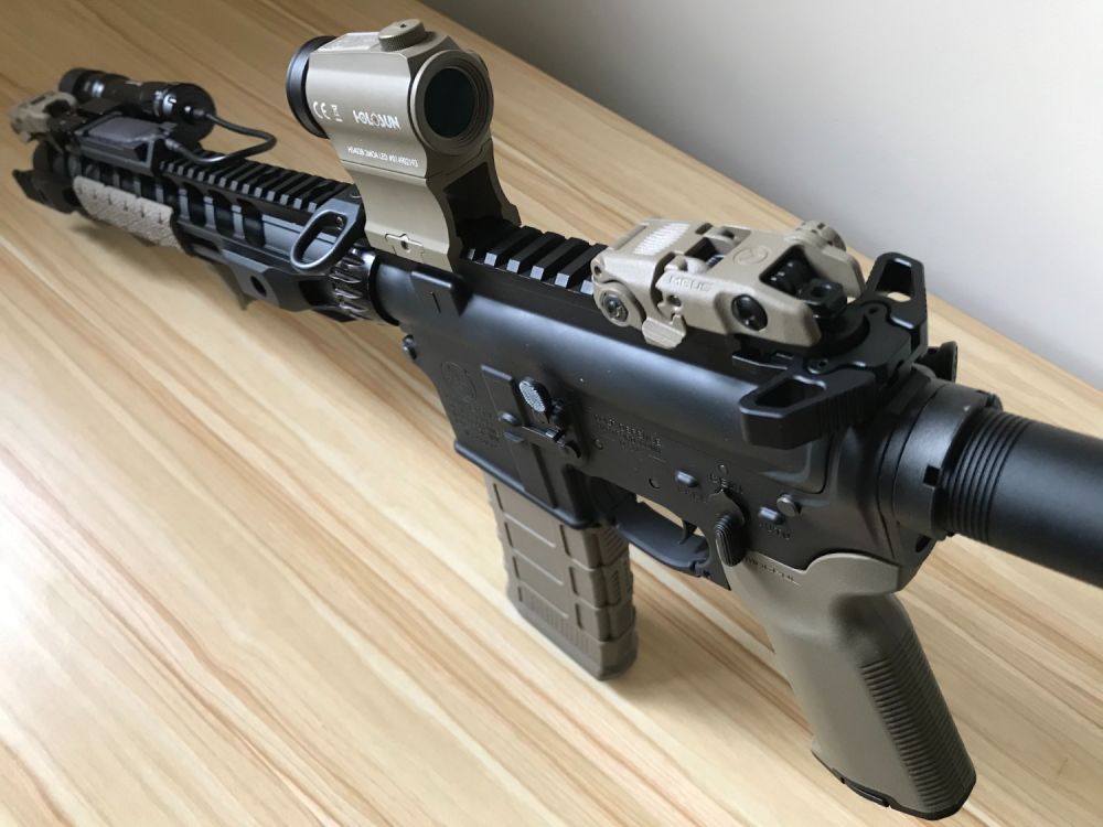

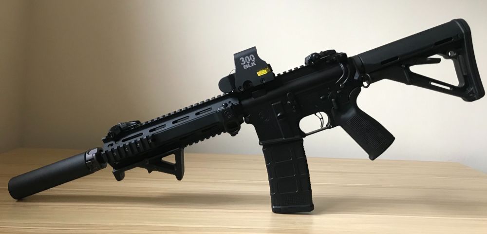

Popular Post Uncle Pauly Posted December 29, 2020 Popular Post Posted December 29, 2020 Very little time spent airsofting this year, but plenty of time spent on MWS builds. Here’s my current line-up... Fortis Night Rail AR-15 build Internal: SixG Super Nub SixG High Speed Buffer Prometheus 6.03mm tight bore barrel (250mm) External: Kublai Fortis Night Rail EMG Noveske Sound Hog amplifier and tracer unit Holosun HS403B Red Dot Magpul MBUS Gen 2 flip-up sights Magpul M-LOK rail covers Magpul M-LOK Hand Stop Magpul MOE K2+ pistol grip Magpul CTR Carbine Stock Magpul MOE Trigger Guard Magpul RSA Rail Sling Attachment PTS Radian Raptor charging handle Olight Odin flashlight Ace 1 Arms PMAG L119A2 build Internal: SixG Super Nub Angry Gun Mil-Spec Buffer Tube Angry Gun Steel Bolt Stop Plate Angry Gun Super Recoil Buffer kit (high speed version) Dynamic Precision Aluminium Lightweight Bolt Carrier (silver) Dynamic Precision Enhanced Nozzle Spring Set Dynamic Precision Match Trigger UAC Enhanced Sealing Buffer WiiTech CNC Hardened Steel Disconnector External: Angry Gun L119A2 Rail (9.25" short version) Angry Gun SF216A L119 Flash Hider Angry Gun SF216A Silencer EOTech XPS2-300 Blackout PTS Flip-Up front and rear sights Angry Gun Ambi Charging Handle PTS EPG M4 pistol grip Magpul AFG2 fore grip Magpul CTR Carbine Stock Magpul ASAP sling plate Magpul RSA Rail Sling Attachment Iron Airsoft PMAG Geissele MK16 URG-I build Internal: SixG Super Nub Prometheus 6.03mm tight bore barrel (370mm) External: Z-Parts Mk16 13.5" Handguard Angry Gun Socom 556 Type-A Muzzle Brake Visionking 1.25-5x26 Short Dot Scope Tokyo Marui Cantilever Scope Mount Z Parts URG-I Airborne Charging Handle Magpul M-LOK rail covers Magpul M-LOK Hand Stop Magpul MOE K2+ pistol grip Magpul ACS-L Carbine Stock Magpul RSA Rail Sling Attachment Marui ZET 20 Round Short Magazine gunbod007, Hypnosis, Wild Weasel and 5 others 1 7
Shamal Posted December 29, 2020 Posted December 29, 2020 11 minutes ago, Uncle Pauly said: Very little time spent airsofting this year, but plenty of time spent on MWS builds. Here’s my current line-up... Fortis Night Rail AR-15 build Internal: SixG Super Nub SixG High Speed Buffer Prometheus 6.03mm tight bore barrel (250mm) External: Kublai Fortis Night Rail EMG Noveske Sound Hog amplifier and tracer unit Holosun HS403B Red Dot Magpul MBUS Gen 2 flip-up sights Magpul M-LOK rail covers Magpul M-LOK Hand Stop Magpul MOE K2+ pistol grip Magpul CTR Carbine Stock Magpul MOE Trigger Guard Magpul RSA Rail Sling Attachment PTS Radian Raptor charging handle Olight Odin flashlight Ace 1 Arms PMAG L119A2 build Internal: SixG Super Nub Angry Gun Mil-Spec Buffer Tube Angry Gun Steel Bolt Stop Plate Angry Gun Super Recoil Buffer kit (high speed version) Dynamic Precision Aluminium Lightweight Bolt Carrier (silver) Dynamic Precision Enhanced Nozzle Spring Set Dynamic Precision Match Trigger UAC Enhanced Sealing Buffer WiiTech CNC Hardened Steel Disconnector External: Angry Gun L119A2 Rail (9.25" short version) Angry Gun SF216A L119 Flash Hider Angry Gun SF216A Silencer EOTech XPS2-300 Blackout PTS Flip-Up front and rear sights Angry Gun Ambi Charging Handle PTS EPG M4 pistol grip Magpul AFG2 fore grip Magpul CTR Carbine Stock Magpul ASAP sling plate Magpul RSA Rail Sling Attachment Iron Airsoft PMAG Geissele MK16 URG-I build Internal: SixG Super Nub Prometheus 6.03mm tight bore barrel (370mm) External: Z-Parts Mk16 13.5" Handguard Angry Gun Socom 556 Type-A Muzzle Brake Visionking 1.25-5x26 Short Dot Scope Tokyo Marui Cantilever Scope Mount Z Parts URG-I Airborne Charging Handle Magpul M-LOK rail covers Magpul M-LOK Hand Stop Magpul MOE K2+ pistol grip Magpul ACS-L Carbine Stock Magpul RSA Rail Sling Attachment Marui ZET 20 Round Short Magazine All looks great ? Uncle Pauly 1

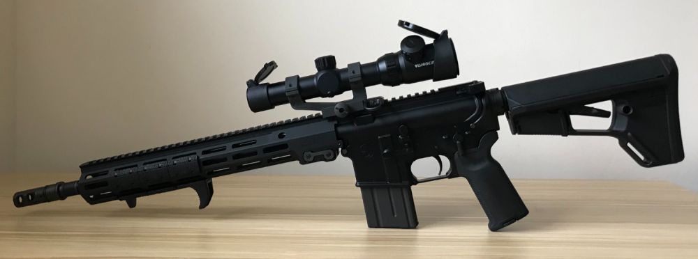

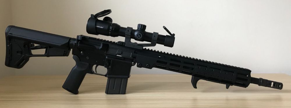

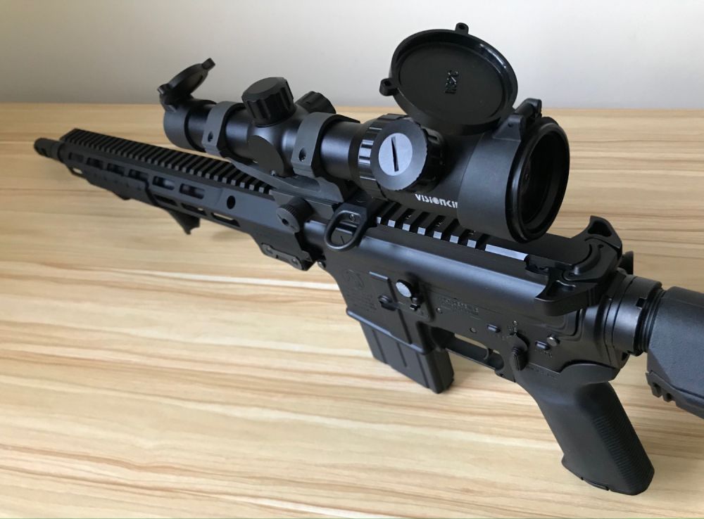

McCoy Posted December 29, 2020 Posted December 29, 2020 11 hours ago, Uncle Pauly said: Geissele MK16 URG-I build Internal: SixG Super Nub Prometheus 6.03mm tight bore barrel (370mm) External: Z-Parts Mk16 13.5" Handguard Angry Gun Socom 556 Type-A Muzzle Brake Visionking 1.25-5x26 Short Dot Scope Tokyo Marui Cantilever Scope Mount Z Parts URG-I Airborne Charging Handle Magpul M-LOK rail covers Magpul M-LOK Hand Stop Magpul MOE K2+ pistol grip Magpul ACS-L Carbine Stock Magpul RSA Rail Sling Attachment Marui ZET 20 Round Short Magazine I will be running a similar build. My Z-Parts 13.5" MK16 Handguard will be here tomorrow. Currently I have a Z-Parts 10.5" MK16 Handguard on my MWS. It is only hand tightened as I am waiting for a wrench. I have about an 1/8" gap between my upper receiver and my Mk16 at the picatinny rail, will this go away once I tighten with the wrench? Uncle Pauly 1
demandt Posted December 30, 2020 Posted December 30, 2020 @Uncle Pauly Love the Fortis build! Incredible how well the FDE colors match. Uncle Pauly 1
Uncle Pauly Posted December 30, 2020 Posted December 30, 2020 23 hours ago, Shamal said: All looks great ? Cheers bud. 12 hours ago, McCoy said: I have about an 1/8" gap between my upper receiver and my Mk16 at the picatinny rail, will this go away once I tighten with the wrench? Yeah, you should be good once the barrel nut is tightened. The gap on mine is approx 1mm. I could probably get it sitting flush if I cranked the nut even further, but it’s fine as is (for reference a slight gap between rail and receiver is very common in real steel builds too). 3 hours ago, demandt said: @Uncle Pauly Love the Fortis build! Incredible how well the FDE colors match. Yeah it’s probably my favourite ? The Fortis rail was a PITA to fit, but I eventually got it pretty much perfect after much swearing and coffee. The sound hog amplifier sits nicely inside the hand guard and adds a noticeable ‘pop’ when shooting, especially indoors. FDE colour coordination is mostly due to sticking with Magpul, although the Ace 1 Arms PMAG is a really good match.
