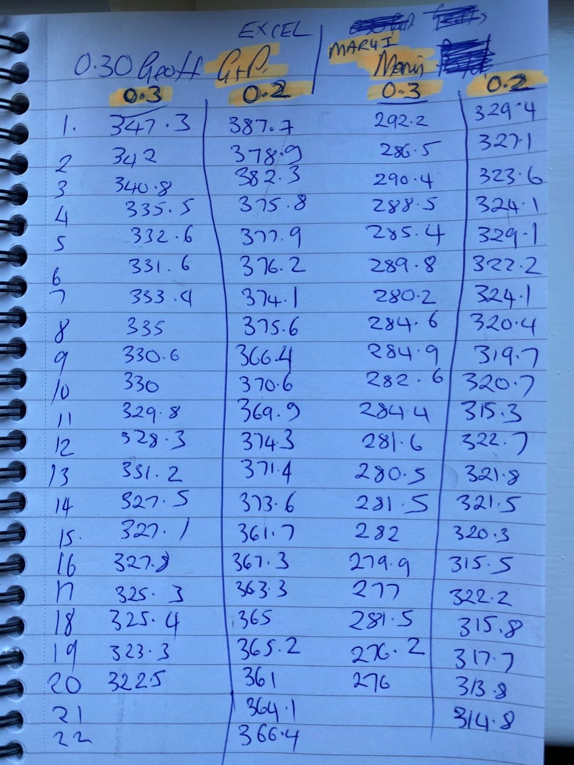

AlphaBear Posted October 31, 2020 Posted October 31, 2020 Oh my God! I just put two mags through my G&P bolt! It’s how can I put it eloquently running as hot as Mount Etna during a heat wave! I’ll update the spreadsheet in a bit. Basically I used Geoff’s 0.3 shooting 20 bbs with both the G&P bolt and then with the Marui bolt. Each time I made sure the mag was full of gas. The temperature was an ambient 20c. Then I switched to 0.2 Excel bbs ( hard as nails but old) and again quite surprised. So four tests done. The bottom line is the G&P bolt is running way too hot! The gas used was Abbey Ultra Predator gas in the red can even though it’s a green gas! Wild Weasel 1
Marroksteel Posted October 31, 2020 Posted October 31, 2020 The G&P unit is made for green gas and Hongkong's 2.0j limit so i would suspect it needs to be tuned down some for cqb
AlphaBear Posted October 31, 2020 Posted October 31, 2020 Here are the results. You can see how hot the G&P bolt (left side) is running compared to the stock Marui (right side). As I said the gas used was Abbey Ultra Predator gas. Geoffs Super Precision 0.3s and Excel 0.2s were used. Ill have a go with the normal Abbey green gas tomorrow and post up. I’ll get round to updating the excel too when I get a moment. Wild Weasel and Marroksteel 2

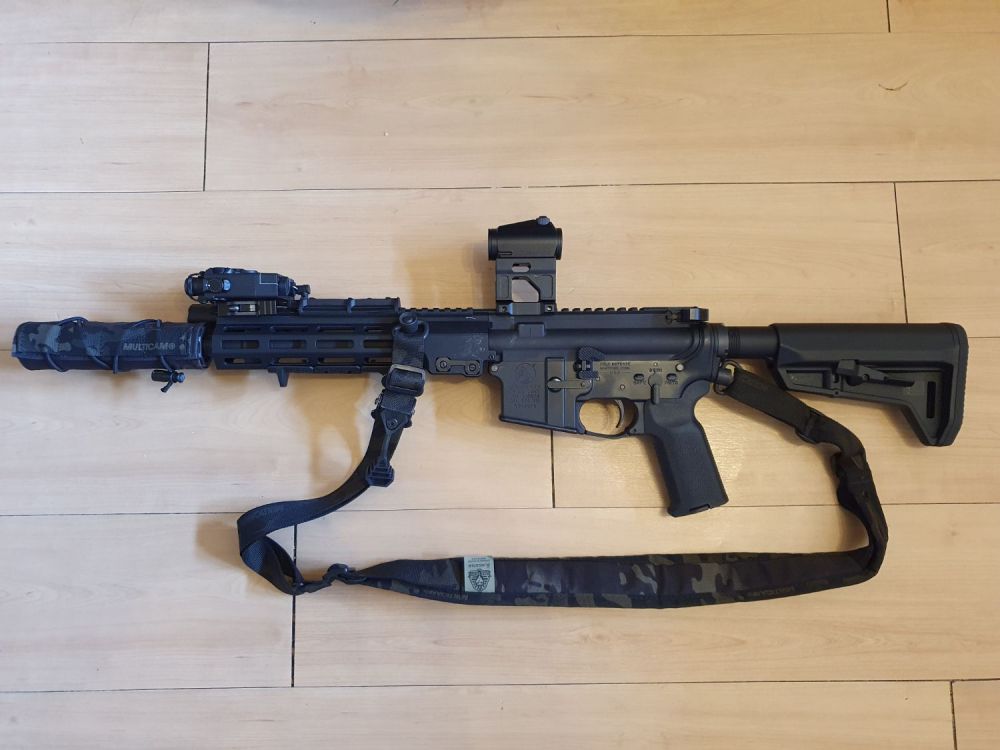

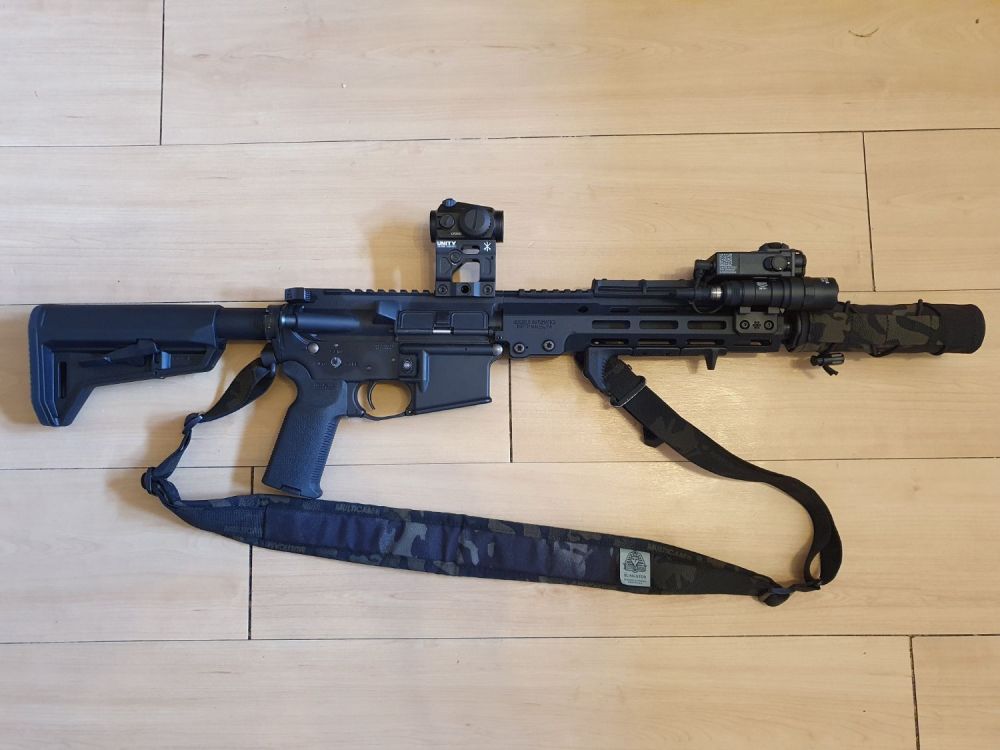

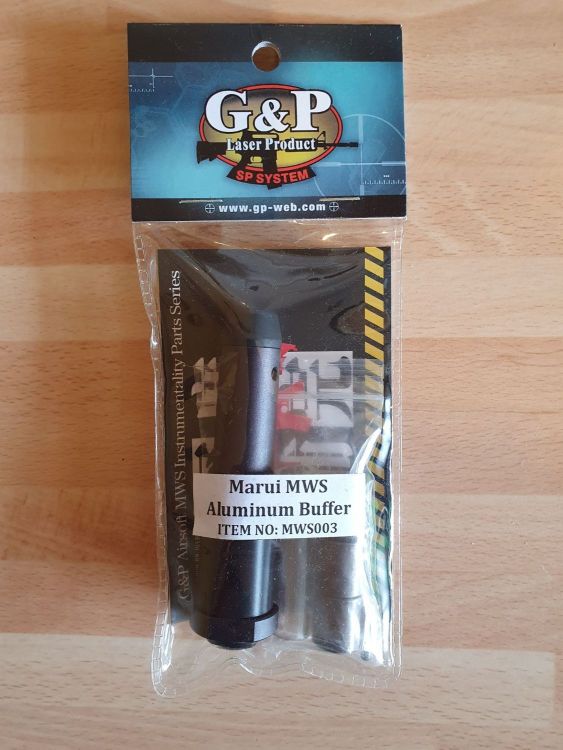

RMDavis Posted November 1, 2020 Posted November 1, 2020 Update on my URGI build... The genuine Magpul SL-K stock arrived from Brownells. Bought a clone Unity Tactical Mount, which although it looks pretty awkward having an optic mounted that high up IMO. However it works perfectly and having the optic mounted at this height is extremely comfortable! I also picked up a WADSN DBAL-A2 and a dual pressure switch to work alongside my M300 light. It's a snug fit but I managed to get everything on the rail where I wanted it. This DBAL-A2 is the polymer one which initially put me off, but it's much cheaper than the G&P version of which I've had two in the past and although they get rave reviews I was never that impressed with them. Secondly if I was that bothered with polymer over metal I'd never buy a TM pistol! ? Overall I'm really impressed with it and after putting quite a few bb's through the MWS zeroing the crossfire on it's new mounted, the DBAL-A2 seemed to gold its own zero. I will update this after a few games, but what with the new lockdown I doubt that will be for a while! After a recommendation from a mate I ordered a G&P aluminium buffer, this comes with three weights which you can add or remove as required. Again when I get chance I will record the various weights and compare them with the stock buffer. A couple of UAC sealing buffers to add to my spares list, currently trying to pick up a spare TM nozzle but looks like stock is zero everywhere! Lastly I've got a HAO Industries lightweight BCG on order after a very positive review from ATRG's blog. Will get that fitted with the G&P buffer and give my review also. Here's a few photo's, sorry for the crappy kitchen floor backdrop, it's howling outside and the best I could do on a Sunday morning! AlphaBear and jsmithski 2

Wild Weasel Posted November 1, 2020 Posted November 1, 2020 1 hour ago, RMDavis said: Update on my URGI build... The genuine Magpul SL-K stock arrived from Brownells. Bought a clone Unity Tactical Mount, which although it looks pretty awkward having an optic mounted that high up IMO. However it works perfectly and having the optic mounted at this height is extremely comfortable! I also picked up a WADSN DBAL-A2 and a dual pressure switch to work alongside my M300 light. It's a snug fit but I managed to get everything on the rail where I wanted it. This DBAL-A2 is the polymer one which initially put me off, but it's much cheaper than the G&P version of which I've had two in the past and although they get rave reviews I was never that impressed with them. Secondly if I was that bothered with polymer over metal I'd never buy a TM pistol! ? Overall I'm really impressed with it and after putting quite a few bb's through the MWS zeroing the crossfire on it's new mounted, the DBAL-A2 seemed to gold its own zero. I will update this after a few games, but what with the new lockdown I doubt that will be for a while! After a recommendation from a mate I ordered a G&P aluminium buffer, this comes with three weights which you can add or remove as required. Again when I get chance I will record the various weights and compare them with the stock buffer. A couple of UAC sealing buffers to add to my spares list, currently trying to pick up a spare TM nozzle but looks like stock is zero everywhere! Lastly I've got a HAO Industries lightweight BCG on order after a very positive review from ATRG's blog. Will get that fitted with the G&P buffer and give my review also. Here's a few photo's, sorry for the crappy kitchen floor backdrop, it's howling outside and the best I could do on a Sunday morning! I ended up with the wadsn dbal, does yours work on low power (green laser)? If you search for William Hicks on Facebook he's had extensive testing with the g&p buffer and he reckons the best setup is with a geissele automatics type 42 tungsten weight from Brownell's and has a video of him in 0°c mag dumping, zero cooldown. Also with a slight bit of movement in the buffers internal weights stops bolt bounce and jams. I've got the hao Econoline bolt enroute too, let us know when yours arrives and what you think please. Cheers. RMDavis 1
RMDavis Posted November 1, 2020 Posted November 1, 2020 49 minutes ago, ajumma said: I also kind of want one of these as a spare to much about with and to try and get to as high joules as possible. What is the optimal nozzle setup to run in it? Guns modify? I intend on using the TM nozzle and only have experience with that part. ATRG's review also uses the stock nozzle and he seemed impressed. https://atrg.blog/2020/10/19/accessory-review-hao-geissele-rebcg-ecoline-for-marui-zet-mws-gbbr/ 15 minutes ago, Wild Weasel said: I ended up with the wadsn dbal, does yours work on low power (green laser)? If you search for William Hicks on Facebook he's had extensive testing with the g&p buffer and he reckons the best setup is with a geissele automatics type 42 tungsten weight from Brownell's and has a video of him in 0°c mag dumping, zero cooldown. Also with a slight bit of movement in the buffers internal weights stops bolt bounce and jams. I've got the hao Econoline bolt enroute too, let us know when yours arrives and what you think please. Cheers. Thats good to know mate, I will certainly check that out! My dbal-a2 is red laser, ir laser, and white light, all functions appear to be working correctly. I will put up my thoughts when the HAO bolt arrives and see how it gets on with the G&P buffer. ? Wild Weasel 1

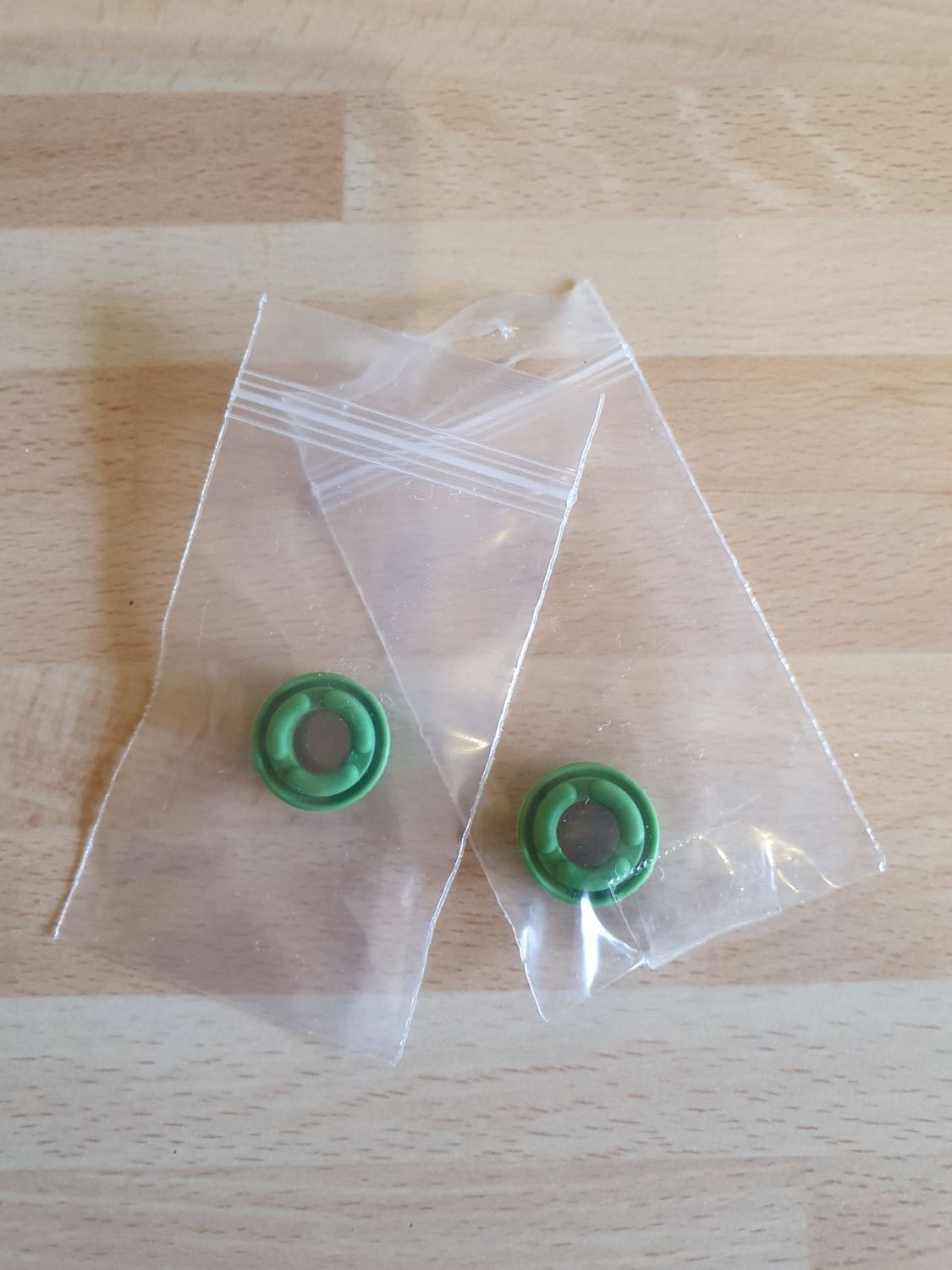

AtR Posted November 3, 2020 Posted November 3, 2020 On eagle6 there's 2 versions of nozzle return springs, one with 150% and another without any %. Which would be the better spares purchase for when my original goes and why? Thankyou.
Uncle Pauly Posted November 4, 2020 Posted November 4, 2020 22 hours ago, AtR said: On eagle6 there's 2 versions of nozzle return springs, one with 150% and another without any %. Which would be the better spares purchase for when my original goes and why? Good question. Personally, I use the DP Enhanced Nozzle Spring Set which is reportedly "more durable", but doesn’t specify any kind of % in terms of spring resistance. I bought it 'on a whim' whilst ordering some other parts (my stock TM spring was still fine at the time) and I've been running it for I think two years now on green gas all year round. No issues. There's also the GunsModify 150% Nozzle Reset Spring Set, which I think may be a newer product (?). No experience of using it myself. 150% seems like perhaps a little too much increase in spring tension for regular use all year, but I dunno. Perhaps the DP set (above) has a similar tension, it's just not stated. Lastly, there the Watermelon Hard Nozzle Spring which I think has a 300% tension. I don't think you'd want to be using that as standard. Bear in mind that the stock TM spring seems perfectly durable in most cases. I have mates who haven't swapped out the nozzle spring for 3-4 years, run green gas all year and haven't had any problems. It seems to be one of those stories that got mentioned on a forum somewhere and has grown legs, so that now everyone believes the MWS nozzle springs are made from cheese ? Hope that helps and I'm sure others here will have more to add. jackd787 1
jsmithski Posted November 4, 2020 Posted November 4, 2020 Important thing is to not twist the spring while installing the nozzle in the carrier. The TM spring is weaker than the DP enhanced (I fckin hate that word popping up on every piece of crap nowadays) spring but the DP works fine on my MWS. 300% probably does not even allow the nozzle to stay with the bucking for a split second.
