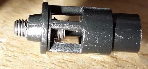

jsmithski Posted October 16, 2020 Posted October 16, 2020 Today I made a DIY npas using stock floating valve and m3x8mm set screw. Works just like any other npas but I think 8mm is too long and eventually 5mm screw would be enough. I was able to get consistent FPS so I think it makes no sense in spending money on the commercial stuff. This is my second npas (first I made for the vfc mp5 gbb), it’s a simple job anyone can do. P4radox 1

AlphaBear Posted October 16, 2020 Posted October 16, 2020 3 hours ago, jsmithski said: Today I made a DIY npas using stock floating valve and m3x8mm set screw. Works just like any other npas but I think 8mm is too long and eventually 5mm screw would be enough. I was able to get consistent FPS so I think it makes no sense in spending money on the commercial stuff. This is my second npas (first I made for the vfc mp5 gbb), it’s a simple job anyone can do. Well that’s quite interesting. Do you have any pics of the components you used and also the final assembly?
jsmithski Posted October 16, 2020 Posted October 16, 2020 17 minutes ago, AlphaBear said: Well that’s quite interesting. Do you have any pics of the components you used and also the final assembly? This is what you need to do.

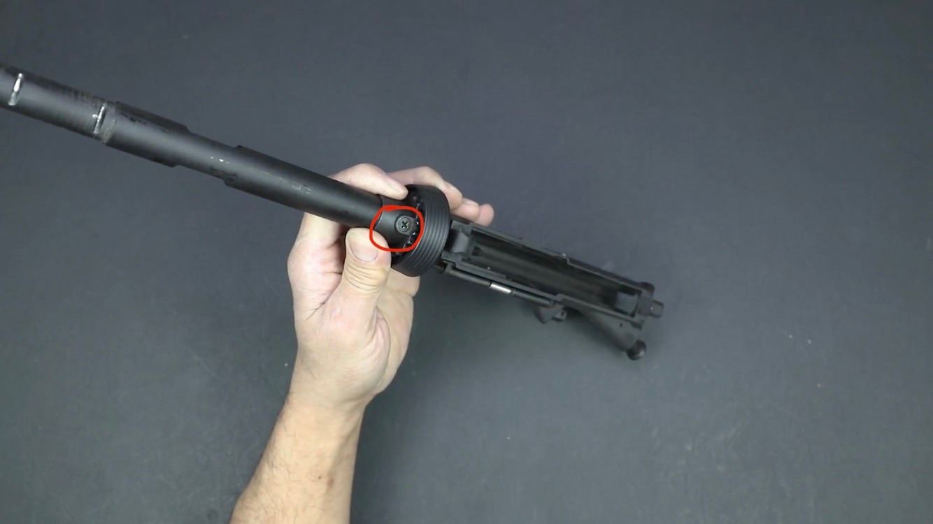

jsmithski Posted October 16, 2020 Posted October 16, 2020 Tech tip: if your original handguard wobbles, it is most likely a stripped screw at the bottom of the barrel. Using a few mm longer one will fix it, there’s much more room and the original screw is very short. Since original threading is short you will need use some force to screw in the longer one, but you can do that without a threading tool.
AlphaBear Posted October 16, 2020 Posted October 16, 2020 46 minutes ago, jsmithski said: This is what you need to do. Ahhhhh I see what you mean now. That’s kinda similar to the Angry Gun MPA nozzle I’m trying it. You can adjust the screw using an Allen key and it has a washer attached to the screw to limit the gas flow.
jsmithski Posted October 16, 2020 Posted October 16, 2020 9 minutes ago, AlphaBear said: Ahhhhh I see what you mean now. That’s kinda similar to the Angry Gun MPA nozzle I’m trying it. You can adjust the screw using an Allen key and it has a washer attached to the screw to limit the gas flow. Here there’s no washer, the screw positions the floating valve by pushing it off the nozzle spring retainer. Question to you all, what’s the trick to make the MWS sound like Inokatsu? If you ever heard how Inokatsu m4 sounds then you know what I’m talking about. Anyone has an idea?
AlphaBear Posted October 16, 2020 Posted October 16, 2020 Is this the floating valve which you have modified ?
jsmithski Posted October 16, 2020 Posted October 16, 2020 26 minutes ago, AlphaBear said: Is this the floating valve which you have modified ? Yes, the one on my pic is from the mp5, but that’s the same part just different shape. You insert the screw from the inside so that you can use an Allen key later to turn it just like the angry gun npas.
