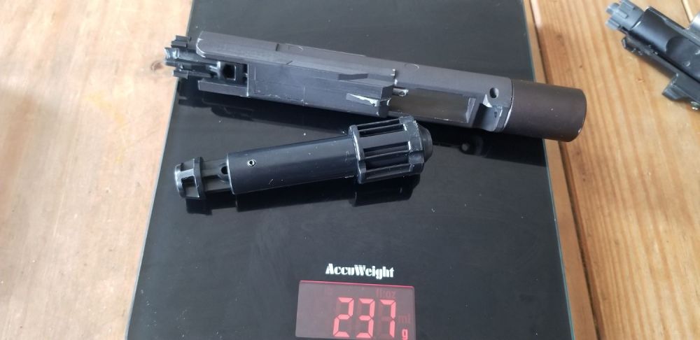

Anyone running an Angry Gun complete high speed bolt carrier with MPA nozzle?
With lower ambient temperatures fast approaching I was wondering whether a lighter bolt carrier would help me with my intention of using my MWS in every season!
Or is my money better spent elsewhere?
Any help/advice would be appreciated. ?
AG fit and finish seems variable (I am being nice about this)
At a minimum swap the piston head (AG one swells and jams up!) and put a dab of super glue on the end of the valve grub screw so if it does unscrew you won't accidentally fire t at someone! Mine has never lost adjustment...YMMV.
I would go for the Dynamic Precision bolt and either the TM or DP internals (DP have better springs in the nozzle, probably easier to buy it as a whole kit)
For winter;
all stock parts
propane dry
fresh (read supple) piston lid seal
Winter upgrade;
npas
lighter weight bolt
Aim to keep pressure drop to a minimum, so don’t try for silly FPS with an Npas, it only exacerbates cool down.
If your playing assault role there is no need for more than 1j.
Keep moisture away, minimum lube.

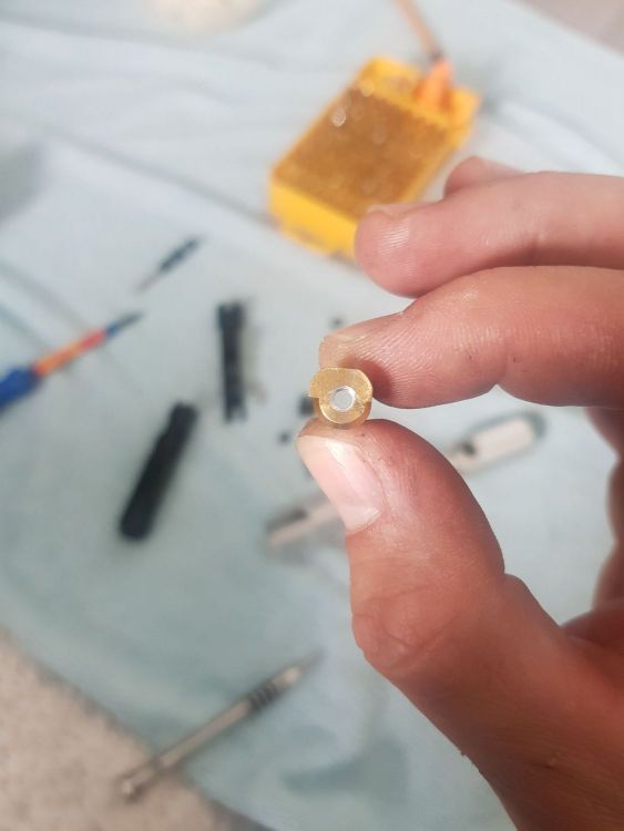

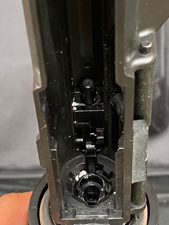

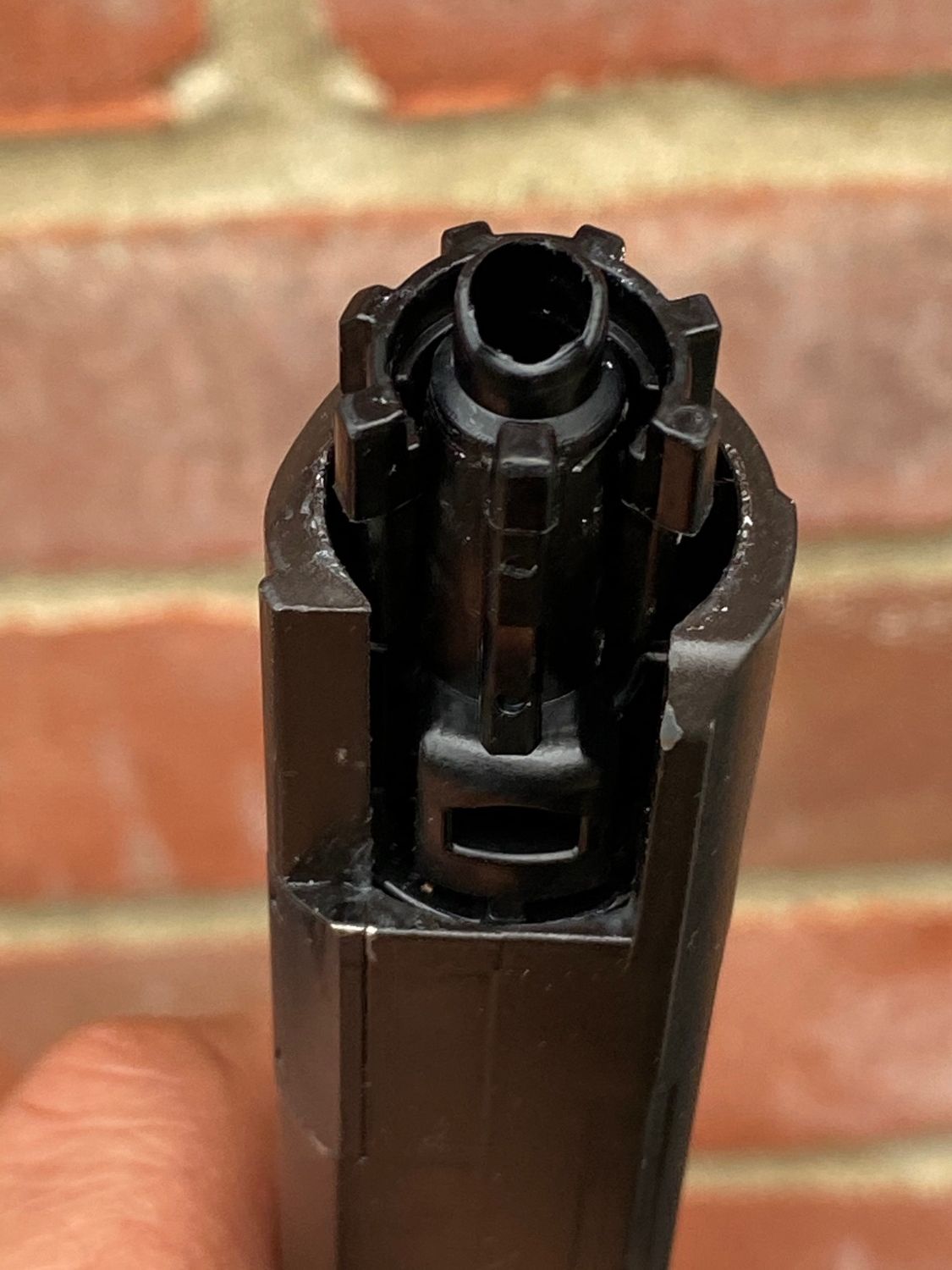

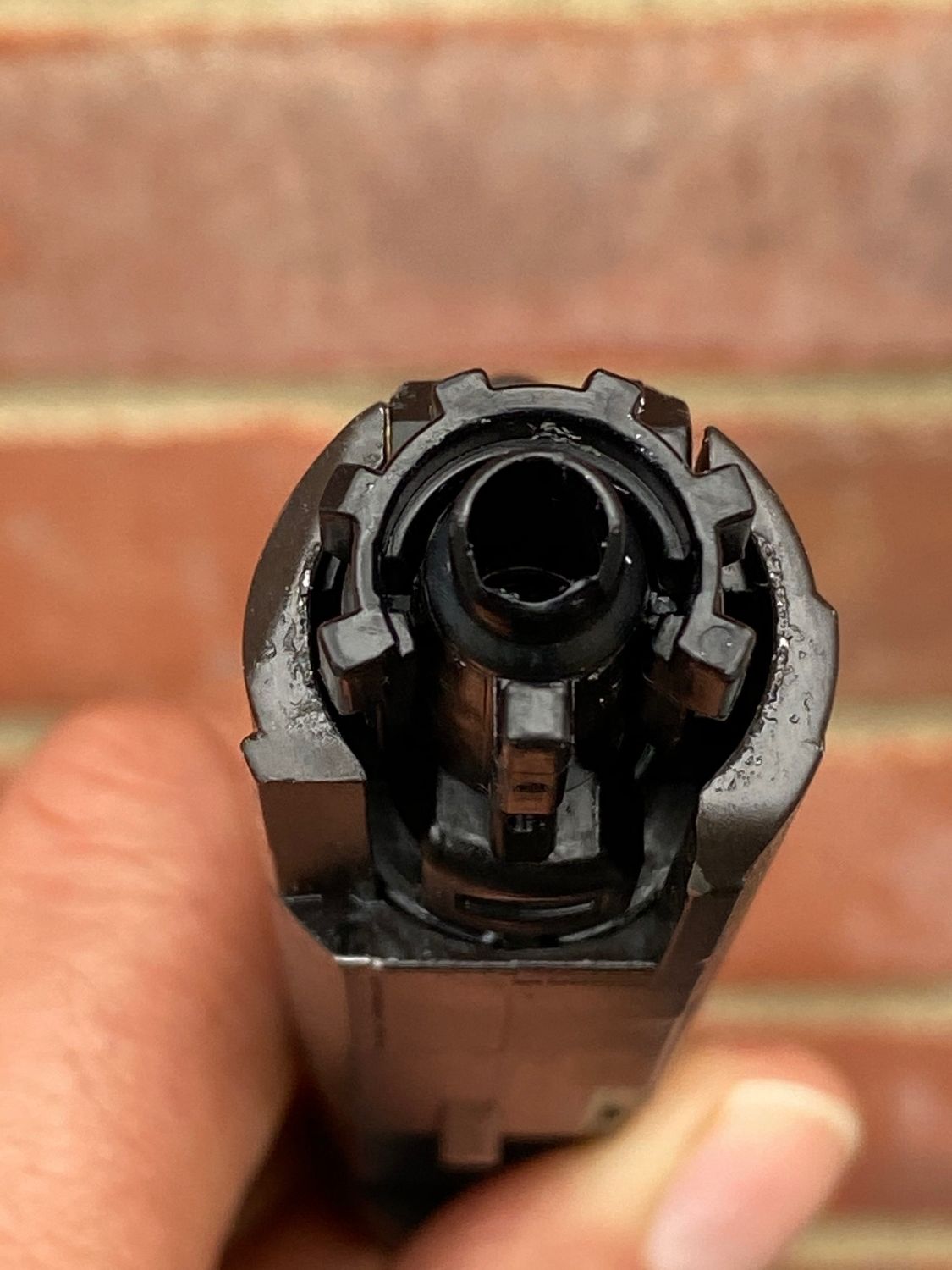

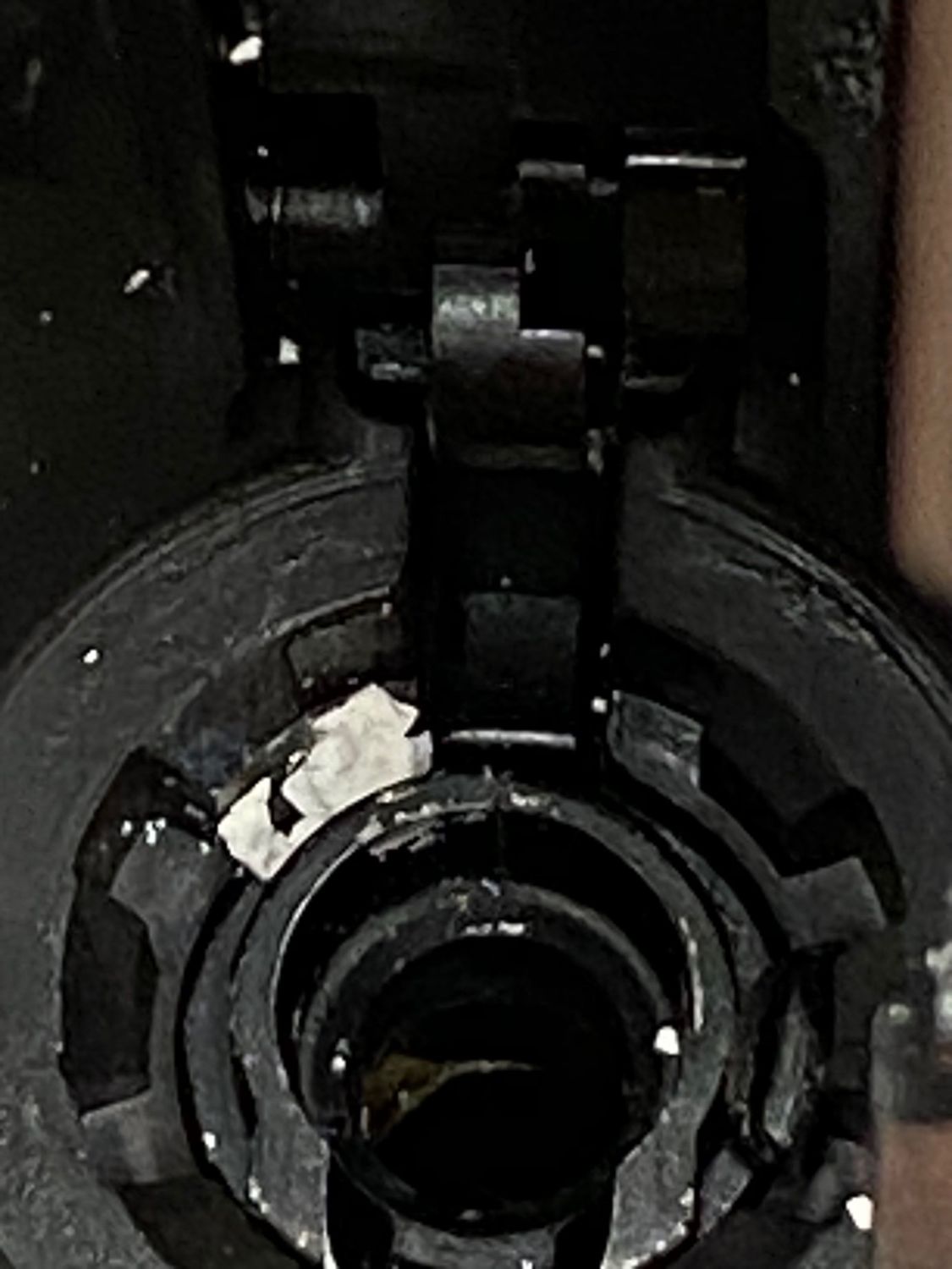

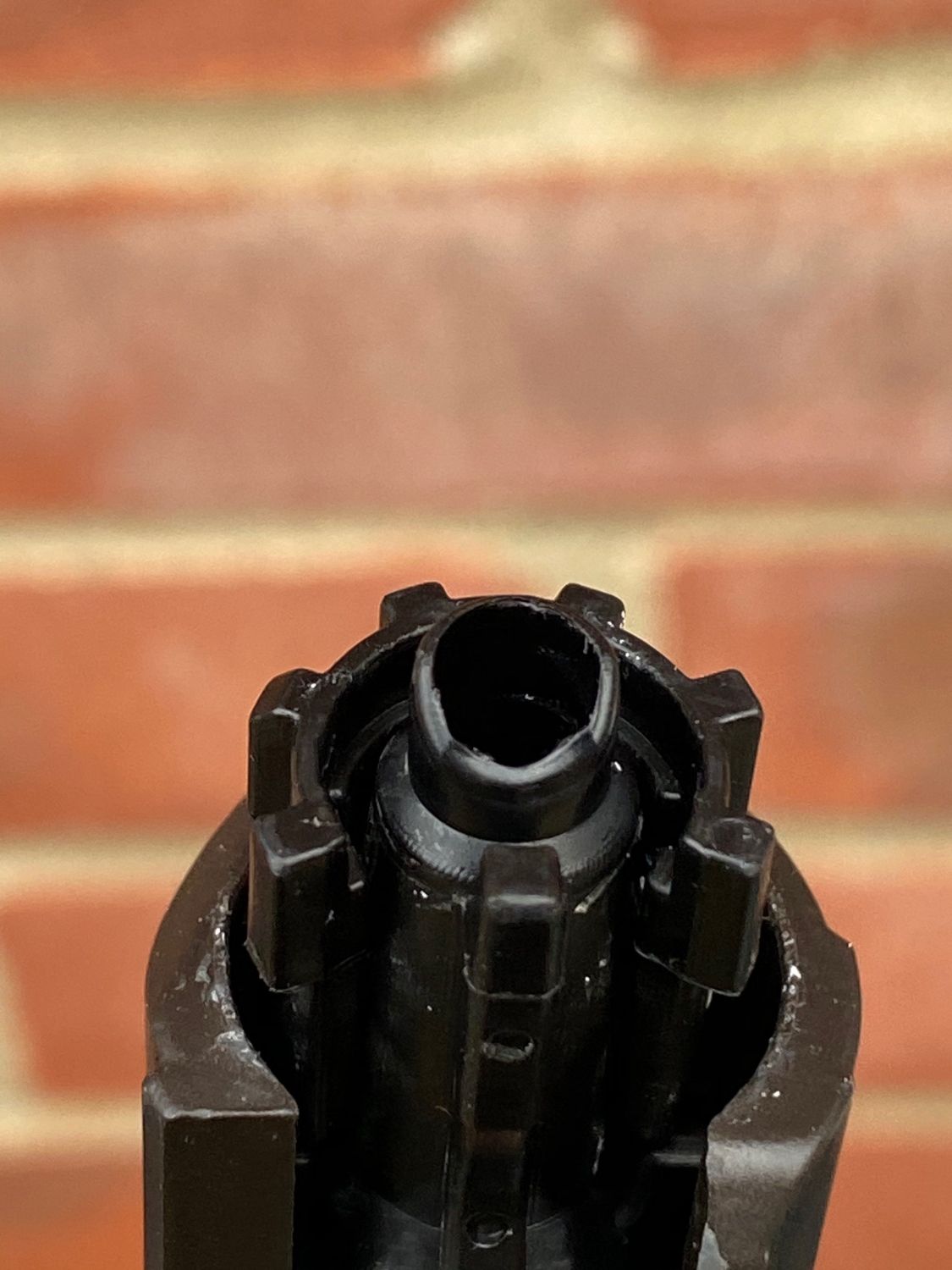

Well mixed feelings! The mws performed amazing for an hr until it stopped firing. Tired another mag and still nothing. Then gas came shooting out the breach. Turns out 6 to 7 bbs got jammed in the barrel. No idea how. There was chopped plastic everywhere . I used a cleaning rod to push them out. Cleaned the barrel. Put it back together. Tried it. It shoots about 10m and the bbs arc downwards. I expect the hop rubber is shagged to bits. No idea really truth be told. Also I’ve no idea how much damage I may have caused. Any advice appreciated.
Yes that’s very unlike an MWS.
Have you looked at the bucking?
Has the gun been modded?
PS still got mine for sale ?
Hi Dave, I’ve just got home now so I’ll take it apart. But first need to look at some online videos ?. Roll on eagle6.
I was using Nuprol RZR 0.28s so I’m wondering if a bad bb caused the jam.
Let me also take a pic of the nozzle and I’ll post that up. Hope I’ve not damaged it.
I've ran mine for about 3000 rounds now and just had my first problem with it. The top portion where the gas key would be on an actual AR snapped clean in half whilst firing, causing no additional damage luckily. AG told me that this is a common fault with older batches, but they've resolved it now by changing the material.
Only advice would be to keep AG and TM parts separate, some of the springs are different lengths and the fitment of things isn't very good between the two.

Looks like you prob just need a nozzle and some quality ammo.
It wouldn’t hurt to put a fresh bucking in.
They are dead easy to work on, only gets a little taxing when you dive in the trigger box, that’s if you can get it out ?
13 minutes ago, Davegolf said:
Nuprol ?☠️
I should have used my Geoff’s 0.3! Oh well. Hey ho. I’ll get a new nozzle and a new bucking. Do you have any available? If so let me know and I’ll grab them off you.
By the way does my existing nozzle looked shagged ?
Yes good stuff!
This is gonna be my first winter with so I cant serve with comprehensive experiences but faster and the engaging points better if you gonna invest I recommend the AngryGun high speed Buffer to balance the less recoil.

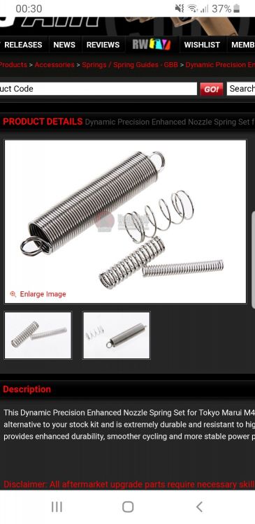

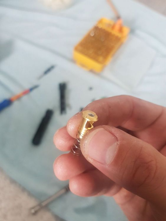

Hi guys.  I installed a set of springs from Dynamic precision and now my weapon fires every other time.  The first bbs shot goes off, the second bbs shot doesn't go out, and so on.  What is the problem, please tell me?  Maybe I did something wrong?
If after each shot I reload the weapon, then bbs will always fly out.

4 hours ago, RMDavis said:
That's good to hear, thank you.
I think I will pick up those two together and see how I fair. I'd imagine with both the AG carrier, and the high speed buffer there's barely any recoil!?
Yes the recoil less ,but its different ,return for faster and more snappy.
So finally the enjoyment factor is increased ,more consistant less gas consumption I like it!
Difficult to find out whats happened ,try to reassamble again!
I just took it all apart and put it back together again, all the same, everything also shoots every other time.
The potential problem with after market parts / third party parts is that even though they claim to be 100% compatible with a platform they may not necessarily be in real life.
What happens when you use the original Marui parts?
