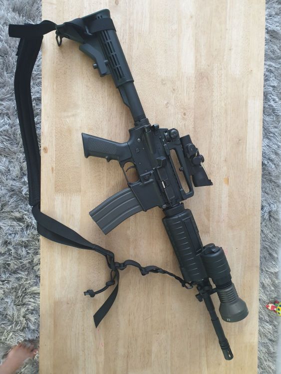

Hypokondrikern Posted August 30, 2020 Posted August 30, 2020 Thanks for the detailed research @JUSTICE_RAINS I was somehow most surprised by the minimal difference in range from a longer barrel. I was somehow convinced that my 370 barrel was the source for the added “umpf”, power and range I have experienced with the MWS. Note. my MWS is second hand and came only with 370 mm barrel so I have no idea of the feeling nor performance of the standard barrel length. But I’m now enticed by the idea of making a shorter build as it will be easier to transport, maneuver and weight less + won’t have the negative effect on range as I initially had perceived. I’d just like to hear from some others whether or not this is the right route? Do others have the same experience that a longer barrel only translates into added FPS rather than added power which lifts BBs further?

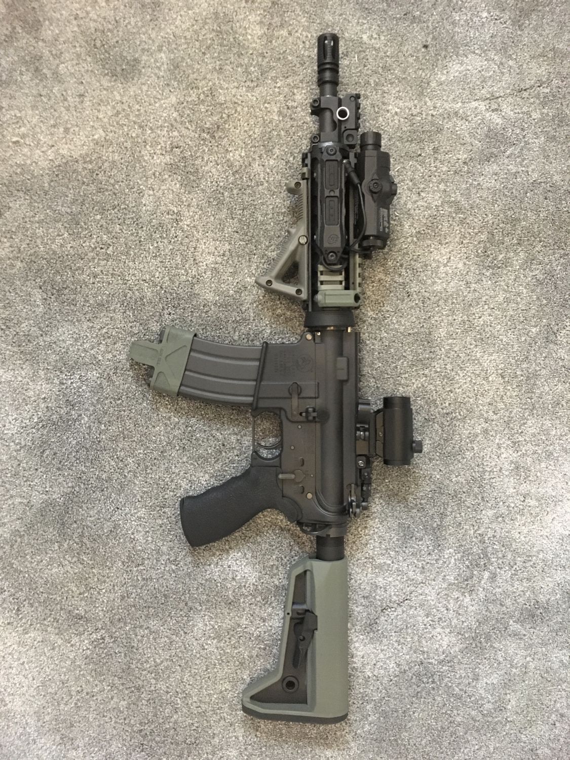

JSwan Posted September 5, 2020 Posted September 5, 2020 My MWS which I’ve had for a month or so now, skirmished with it once and what a fantastic gun! It’s got a Six G nub now after reading this thread and a modify tan bucking on the way SSPKali, RMDavis and Wo1f 1 2
