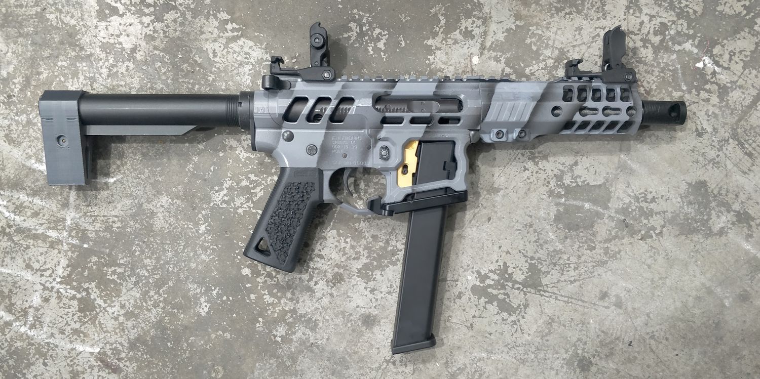

adas1223 Posted June 20, 2020 Posted June 20, 2020 did a commission 3d print of an MWS outerbarrel/collar (for ultralight builds) and i really liked the concept, so i made one myself for my pdw build. also a new 3d buffer tube arm brace, and tanker style muzzle device. this thing has RECOIL! Hypnosis, LVOA-D and RobHedley 3

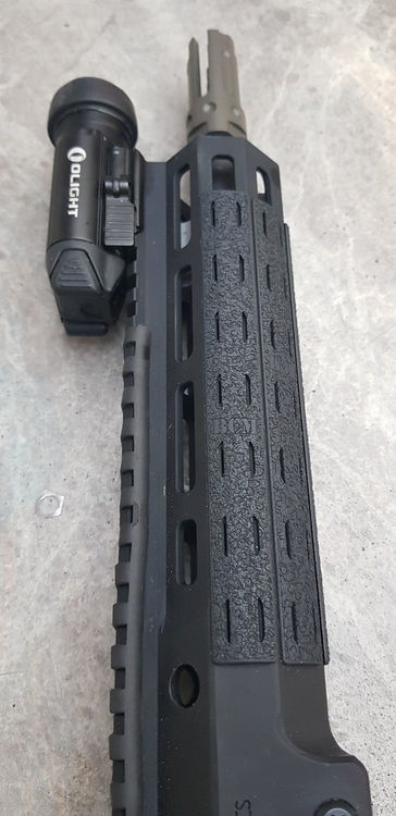

SSPKali Posted June 25, 2020 Posted June 25, 2020 21 minutes ago, Wild Weasel said: Just ordered some of these rail covers for same rail because they are very cool. How hard was it to get the rail over the barrel nut on yours? Mine took about 3-4 million pounds per square inch of pressure plus wiggling to get on our off probably due to using the wrong tool on the nut! Mine slid on fine with zero play, possibly the finest tollerences I have seen for a while! I added some good quality grease so I have a hope in hell of removing it at some point in the future. You will love the rail covers, if you ordered from Brownells don't expect them to be with you before 2weeks after order, I think Customs / ParcelFarce are a bit busy! Wild Weasel 1
