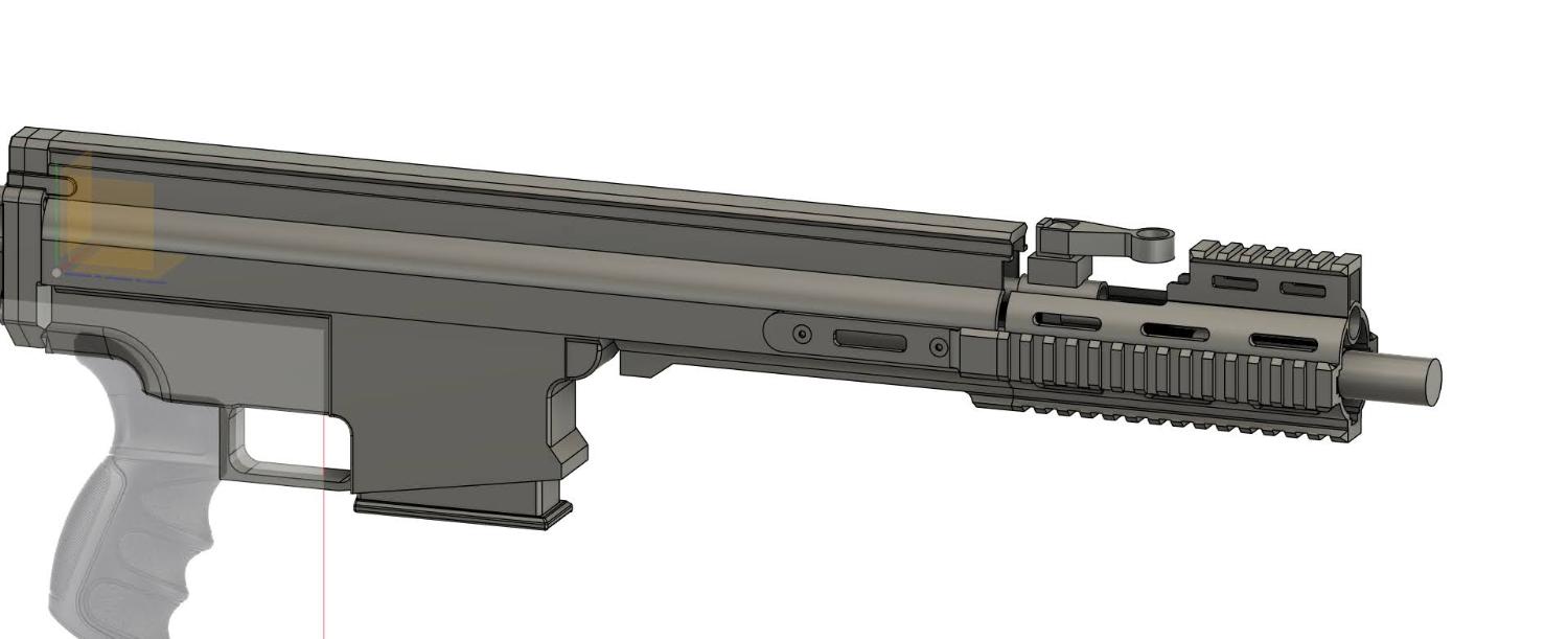

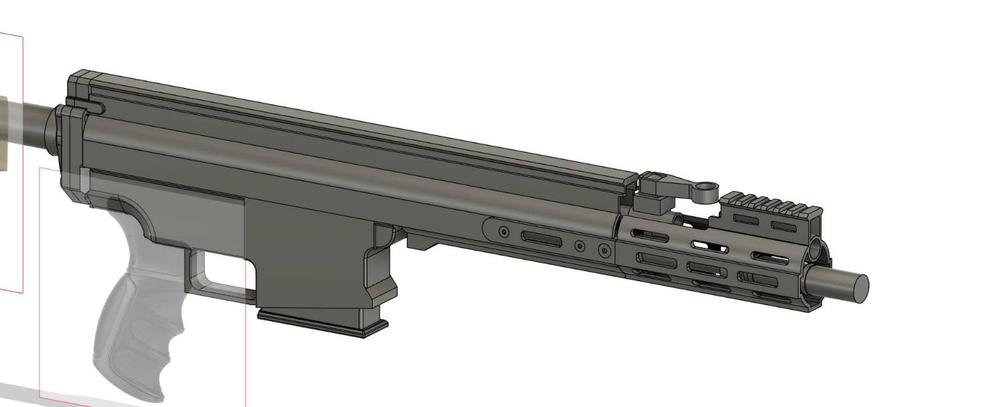

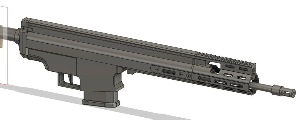

PopRocket123 Posted September 13, 2024 Posted September 13, 2024 This is what happens when you let someone with adhd who is incapable of making a decision design something. You get 4 different versions of the same thing Tackle, Egon_247 and GothicGhost 2 1

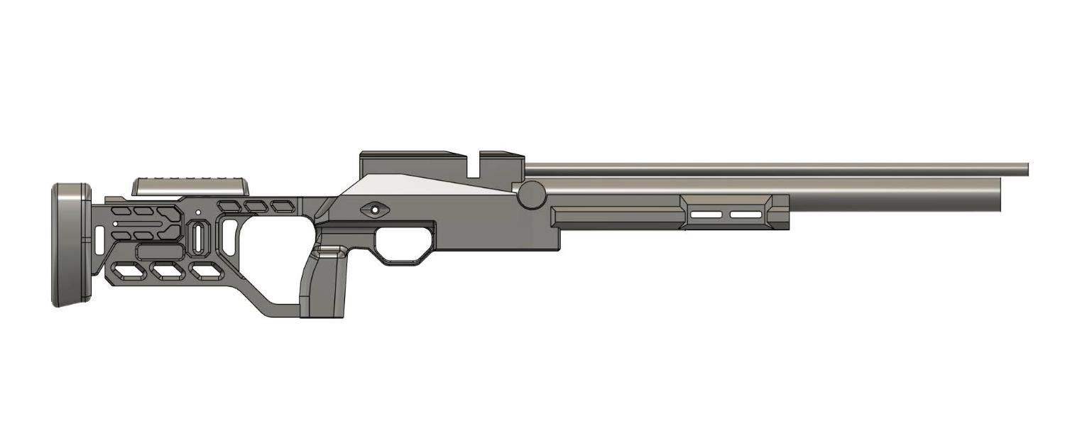

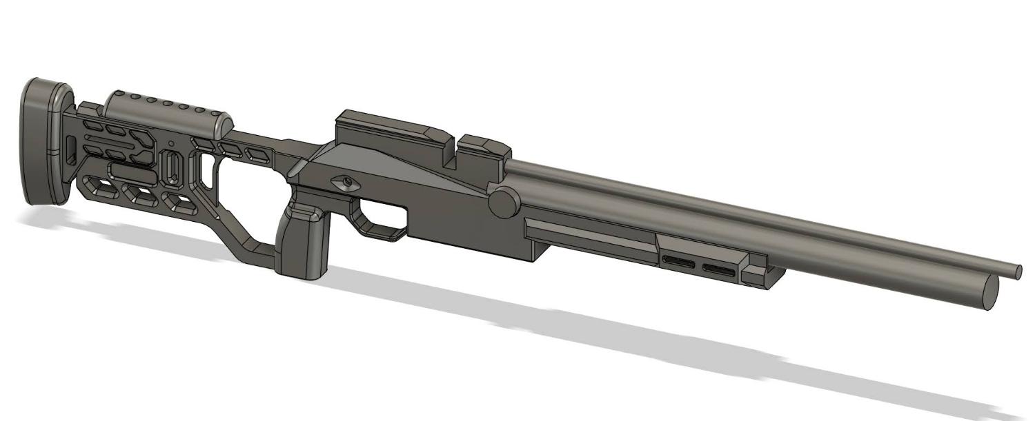

PopRocket123 Posted October 2, 2024 Posted October 2, 2024 This is actually for an air rifle but I'm really happy with how it's coming out. It's for the Reximex Pretensis and is based on the KRG Whiskey 3 chassis. Not bad for 3 days work. Now onto the boring stuff. Screw fittings etc. ButcherBill and mightyjebus 1 1
ButcherBill Posted October 2, 2024 Posted October 2, 2024 Will 3D polymer stuff be strong enough for this?
PopRocket123 Posted October 2, 2024 Posted October 2, 2024 2 hours ago, ButcherBill said: Will 3D polymer stuff be strong enough for this? I print in carbon fibre reinforced ABS which is plenty strong. You just have to think about the direction of the layers when you're working out print orientation. And in this case I'm going to need to split it to fit in the print bed. So I'm going to split it at 45° angles in order to maximise surface area when I stick it together ButcherBill 1

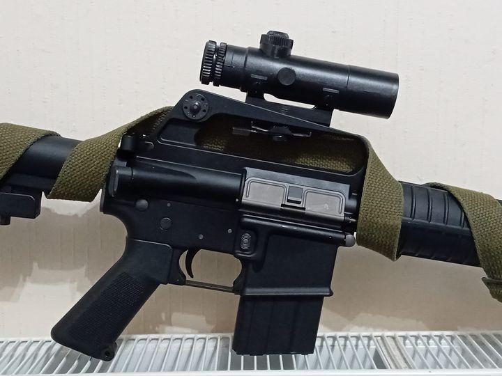

ButcherBill Posted October 4, 2024 Posted October 4, 2024 Technically a scale model but built this today... 4X20 scope for my AR15 family, just for the looks & on a budget. mightyjebus, PopRocket123, The_Lord_Poncho and 1 other 4
Speedbird_666 Posted October 4, 2024 Posted October 4, 2024 On 03/10/2024 at 00:47, PopRocket123 said: I print in carbon fibre reinforced ABS which is plenty strong. You just have to think about the direction of the layers when you're working out print orientation. And in this case I'm going to need to split it to fit in the print bed. So I'm going to split it at 45° angles in order to maximise surface area when I stick it together How stiff if that material? I've been slowly working on a benchrest stock design for my HFT500 (quoted £750 to get a custom one done) and was looking at using PPS-CF - but at £115 a roll it ain't cheap. I need to minimise flex otherwise there could be POI-shift issues.
PopRocket123 Posted October 5, 2024 Posted October 5, 2024 17 hours ago, Speedbird_666 said: How stiff if that material? I've been slowly working on a benchrest stock design for my HFT500 (quoted £750 to get a custom one done) and was looking at using PPS-CF - but at £115 a roll it ain't cheap. I need to minimise flex otherwise there could be POI-shift issues. I haven't printed anything this big before so we'll see how it comes out. I'm not expecting it to be on par with some of those custom stocks out there but it's only for a fairly cheap Reximex Pretensis so I doubt it's got good enough performance to see much difference. It'd be interesting to experiment to see if I can come up with something solid enough to be good for that
