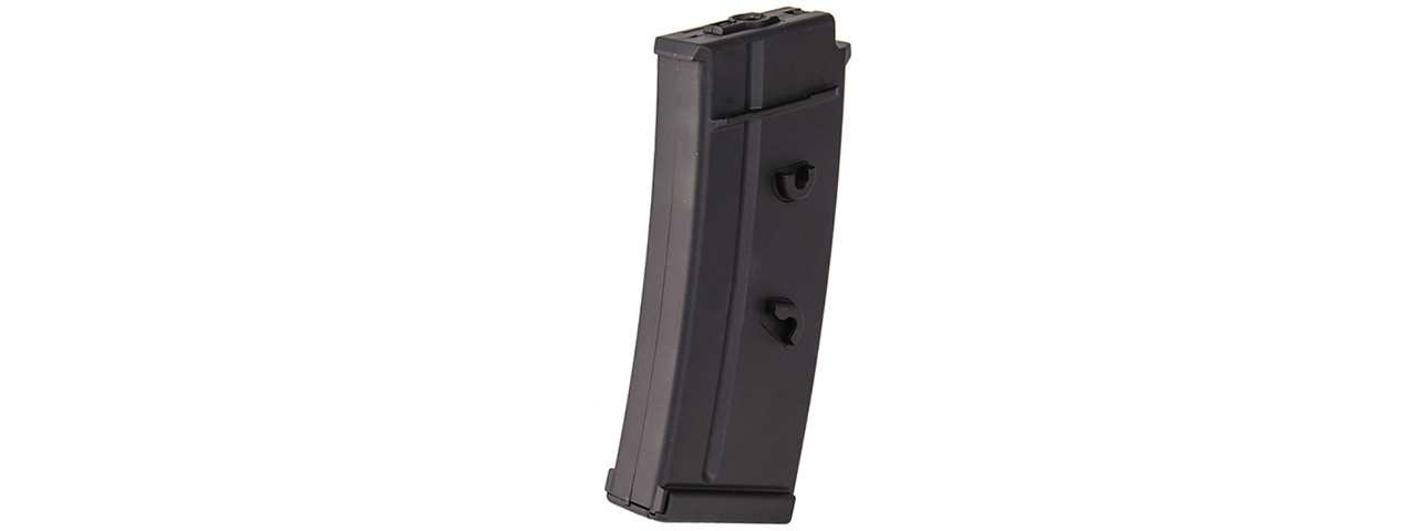

Can someone tell me if the little hook and curve catches allow you to snap your mags together so you can flip and reload quick? If not then what the fluqq are they for?
Yea that’s what they’re for, they go side by side so you don’t even have to flip it.
