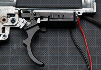

Specna G36s are (early pre-EFCS) ARES/S&T clones - they use microswitch triggers. They don't last a long as traditional trigger switches (although a debounce enabled Mosfet will help) but are easy enough to replace. From the sample of 1 I've had eyes on - the plastic on the Specna is much nicer than JG/CYMA, more 'polymer', less ABS feeling.
And remove the blowback shuttle - they are made of cheese and will break quickly (same with the ARE and S&T guns)

No mosfets in Specna G36s (OP was asking about the SA-G12 model) - just a microswitch which is not actually rated for the voltages/current that it will experience during Airsoft use.

Do we know if it can be replaced with a £5 V3 trigger unit?
If so, and given the QC spring taking the stress (literally) out of gearbox disassembly, I might still just very marginally lean Specna.  But the CYMA - bought from an actual UK airsoft retailer - is likely to just work and keep working.

If you are talking about a standard V3 Switch/shuttle assembly then no, I don't think so. The gearbox shell is not a standard V3 from what I can see around the switch area.
A simple cheapo Gate Nano-ASR (which is micro switch compatible with it's debounce function baked in) will remove the electrical stress on the switch though - it *should* significantly improve the life of the unit. Problem is, by the time you've paid £17-20 for a Mosfet (and not botched the install), you are only a few quid away from a better class of gun overall (i.e. Double Eagle etc.).
So - if I was buying a G36 for myself, I would opt for the Specna just for the better quality plastics and with the intention of stripping/lubing/shimming/mosfet etc from the outset.
But for a first AEG? Hands down JG/CYMA IMHO - from reputable dealer than chronos their guns before dispatch.
