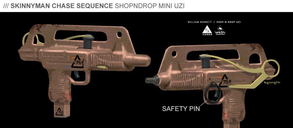

Ok. Ghost in The Shell 2017, there is a weapon that is a disposable one-use submachine. The one used in the movie is just an uzi that fires blanks with a shell to disguise it. I want to make a replica of that gun, but being faithful to the original design (image attached). It will be possible to be used just once, because the body I'm going to make won't be possible to be taken apart, so it can't be reloaded (not gas, battery, or bb's). I want to keep that part of the story in the weapon. So what worries me is just the guts of the weapon, because it just has to be pulling the trigger and that's it, because the actual weapon was just like that, simple, cheap.  I hope I've been clearer this time??

Judging by the scale those look like mini Uzis not full size Uzis. Your best bet maybe to go on a prop forum and ask if some one has made a replica or 3d printable file.  This might be a better base gun  https://bbguns4less.co.uk/products/blackviper-micro-uzi-electric-bb-gun-in-clear.html it just won't shoot very good. I just don't see this being a cheap build but good luck.
If you really are concerned about dimensions, then getting a KWS Mini UZI is probably best, but not the cheapest. Otherwise you're going to have to do a lot of work to get the right shape.
Having it only fire in 1 setting is odd, do you really need it to fire? What if something goes wrong and it doesn't work, are you going to throw it away and build another one? I get that in the movie that's how it functions, but you don't need to replicate it's function, just it's aesthetics surely...
If the real weapon in the movie fired, I can guarantee that it could be taken apart since it will be a live firearm. The picture above shows a clam style casing that comes apart.
If you can make the outer shell, sticking an AEP inside it would be the only option I think (other than going gas). They can be picked up for £50-£60 or so:

If it was me, I'd probably buy one KWC mini-uzi, vacuum form the shell using it, and use that to make the outer casing for as many as you need. Fix an AEP in each one, and seal it up. Then paint and finish. It wouldn't be particularly cheap though, and I think you'd struggle to make one from scratch for any cheaper.

OK, for that I'd ideally go with the KWC Mini-Uzi, cut the barrel down slightly, chop the sights off the top and use very thin kydex to mould two clamshell halves to stick around it, hoping that you'd pick up the details.  I wouldn't be that hopeful though, I'd expect they vacuum formed that movie one.
Then modify the charging knob, although it's got more travel than shown on that movie prop.  Fill the magazine with BBs and epoxy it in place.  You'd still need to put a CO2 bulb in, but you'd only get the one mag out of it.
I'm not sure how you'd do that yellow safety pull-out, as it goes right through the shooty bits.

There are 3 core Uzi designs - Uzi, Mini Uzi & Micro Uzi.  In Ghost in the shell they used Mini Uzis and the Skinny man version is a mini Uzi inside a shell.
The original movie prop isn't sealed, its a two piece shroud that's screwed/bolted in place.
https://en.wikipedia.org/wiki/Uzi#Mini_Uzi_carbine
http://www.imfdb.org/wiki/Ghost_in_the_Shell_(2017)#Skinny_Man_Uzi
