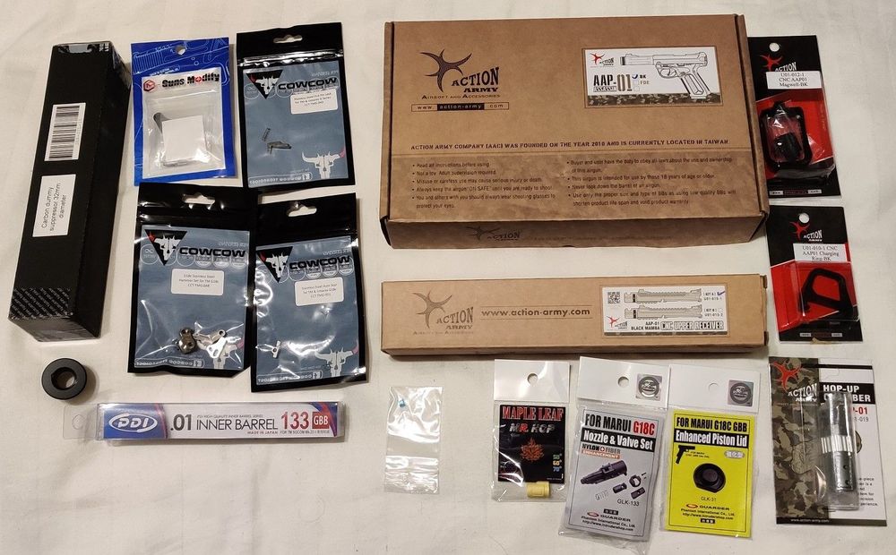

I think I’ll leave the the stroking to my cat (no pun intended lol). The pistol seems good enough as is. As I have a H key and a flamingo pink rubber I’ll Chuck those in. I guess there is no point swapping out the inner barrel with a stainless steel tight bore right? Unless there is a crazy jet one??
Everything apart from the short stroke kit has arrived now (knew I should have ordered the black rifles one). The CowCow trigger is simply marvellous to behold but I naively read people saying it was a "drop in" fit and assumed it would be easy, looks like an entire take down on the lower half to swap it over. At least I'll know how it all works when I'm done!
I've always read 'drop in' as 'doesn't require modification', not that it isn't a ball ache ?

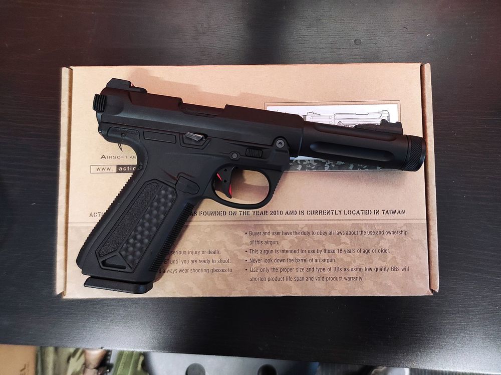

Spent the evening putting some bits in.
Barrel, bucking, h plate, went in no issue, really like the hop unit design, feels so much better put together than a hi capa.
CowCow trigger, looks great, no sloppiness but have lost the use of both safeties, not a problem for me but no idea (or even cares) why.
Hi capa 140% nozzle spring, OMG what a difference, stock nozzle spring is ass and well worth the £2 to upgrade.
Fibre sights, it's 2mm fibre and the sights are plastic, me with 1.5mm fibre had to be very careful, got it in but in time will swap for 2mm.
Didn't video any of it as I wasn't confident and rightly so, had it in bits and resorted to YouTube for a rebuild guide. Will probably do a build overview though but nobody cares about a nobodys build so not a high priority.

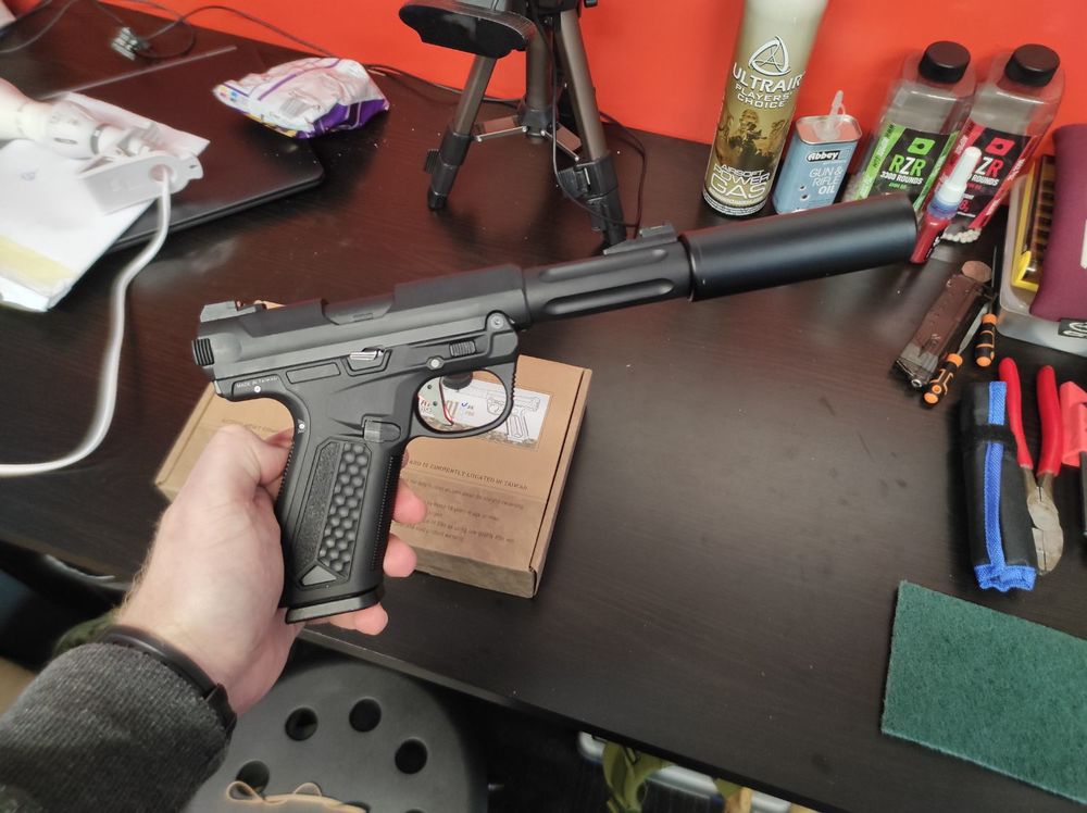

11 minutes ago, Steveocee said:
Subtle isn't she?
Oh yeah you wouldn’t even notice that In your jeans pocket mate..?
What suppressor is that May I ask?
It's a cheap M-ETAL one from Skirmshop
https://www.skirmshop.co.uk/100x32mm-dummy-sound-suppressor.html
I opened it up, removed the spring from the middle, cut the 2 foam inner parts (as per an old KM mk23 suppressor video) and then used them to sandwich a scouring pad strip I stuffed in to make an "O" (FoamScourerFoam). Will find out how good it works when the primary turns up, I want to get the pressure down low for a quiet (obviously not mk23 quiet) but fast follow up setup as I'd like to use this at the local skirmish outdoor site, they have a village, netting maze, castle, outdoor speedball field I think it would do really well at.
