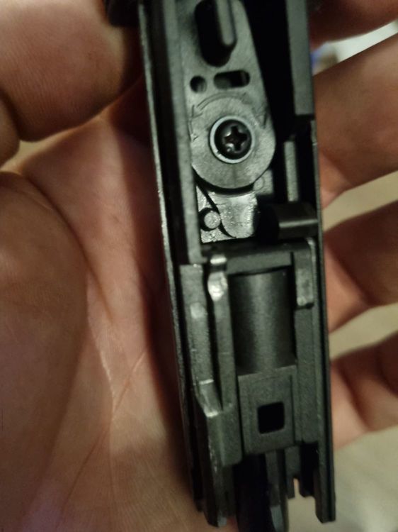

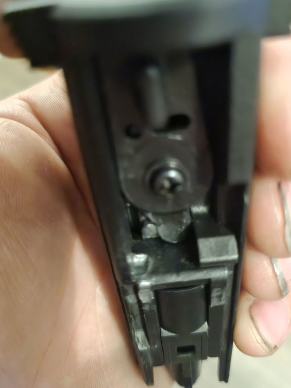

Spartan09 Posted October 17, 2021 Share Posted October 17, 2021 Also.. forgot to upload pics of the damage done to the blowback unit.. not sure if this will be serviceable with a new hammer, or if it will also need replacement.. Link to comment Share on other sites More sharing options...
Spartan09 Posted October 19, 2021 Share Posted October 19, 2021 found an action army hammer in stock with tango down airsoft and ordered it. hopefully it will be here by the end of the week so i can rebuilt it ready for the weekend. Link to comment Share on other sites More sharing options...

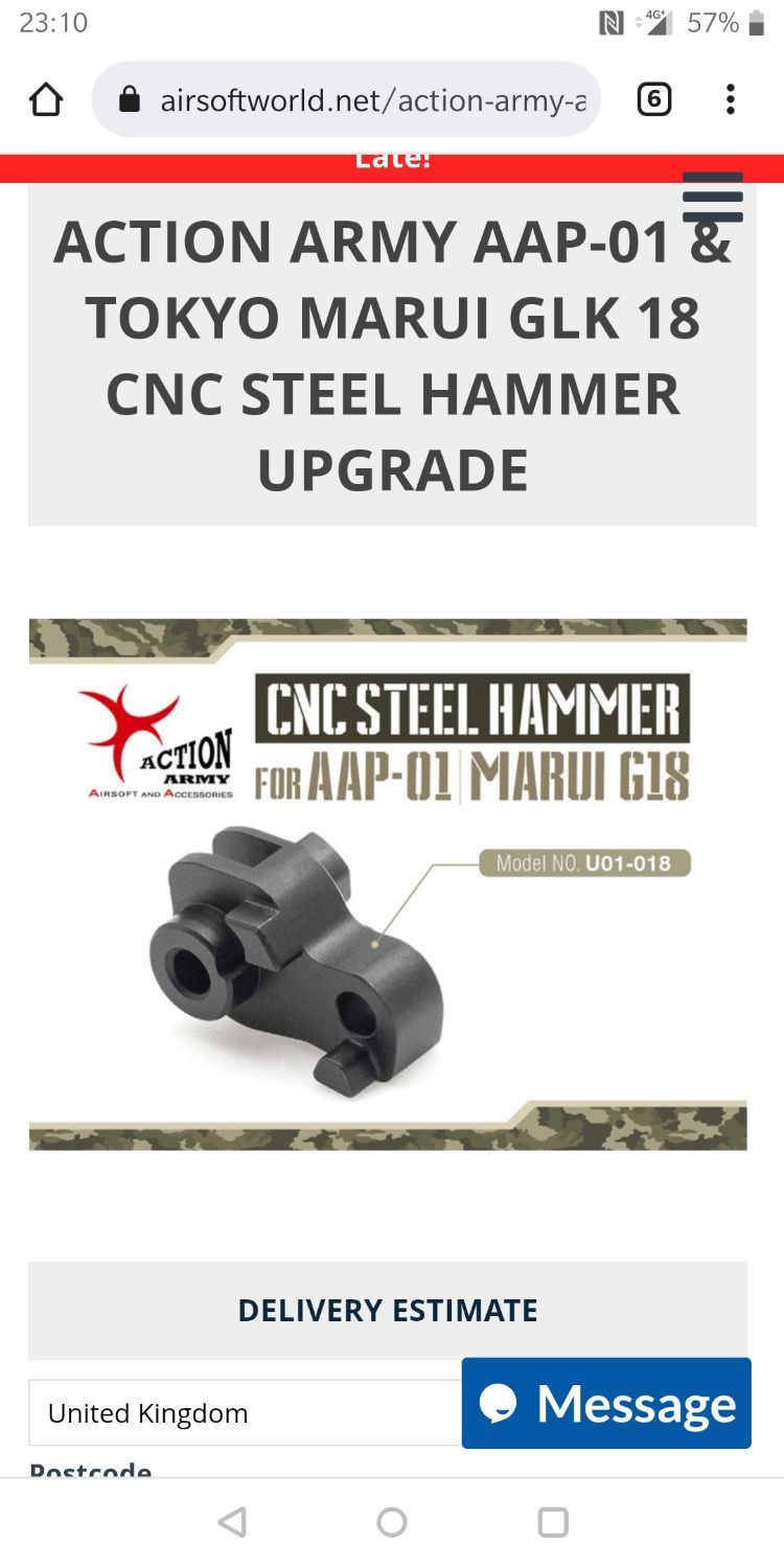

Fatboy40 Posted December 13, 2021 Share Posted December 13, 2021 6 hours ago, leadly said: ... my AAP-SMG has shit it's hammer AGAIN by the looks of it. I replaced it with the updated AA version... The Action Army CNC Steel Hammer or the stock version 2 hammer found in the newer AAP-01's? Link to comment Share on other sites More sharing options...
leadly Posted December 13, 2021 Share Posted December 13, 2021 This exact bag of shite. Fatboy40 1 Link to comment Share on other sites More sharing options...

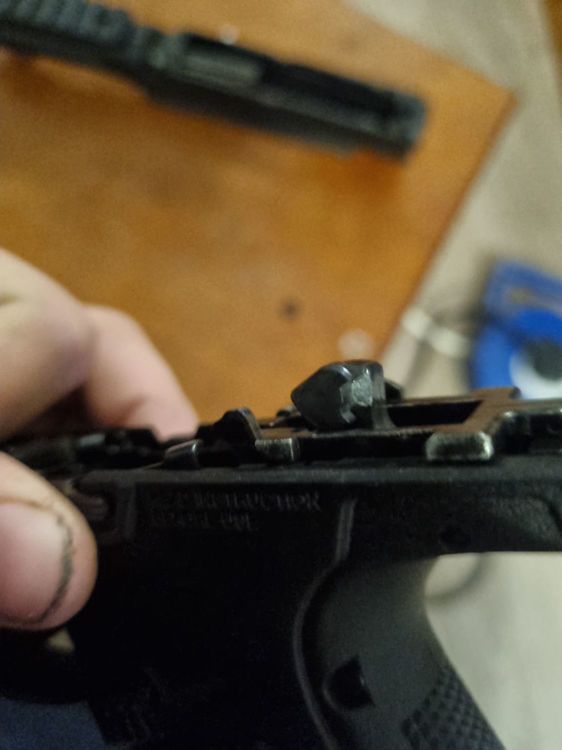

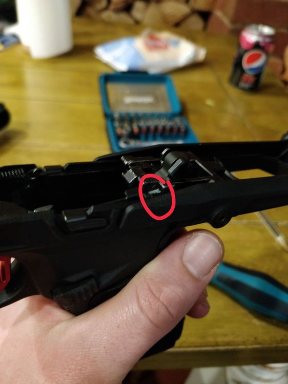

Albiscuit Posted January 12, 2022 Share Posted January 12, 2022 So i have finally put my melted AAP back together with the new hammer and trigger parts but something is catching now. When I pull the slide back to cock it most of the time its fine but sometimes it catches on something. I cant seem to work out exactly what its hitting, anyone had a similar issue? Link to comment Share on other sites More sharing options...
