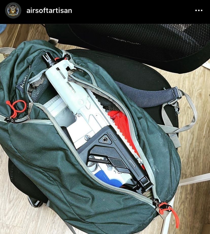

Wavey_Gravey Posted July 7, 2022 Posted July 7, 2022 Does anybody know of a ‘PDW’ style short buffer tube similar to the LWRC one, that is available for the MWS? As part of my downsizing I’m also shrinking the rifle to fit in a backpack, not keen on sliding / collapsing stocks.

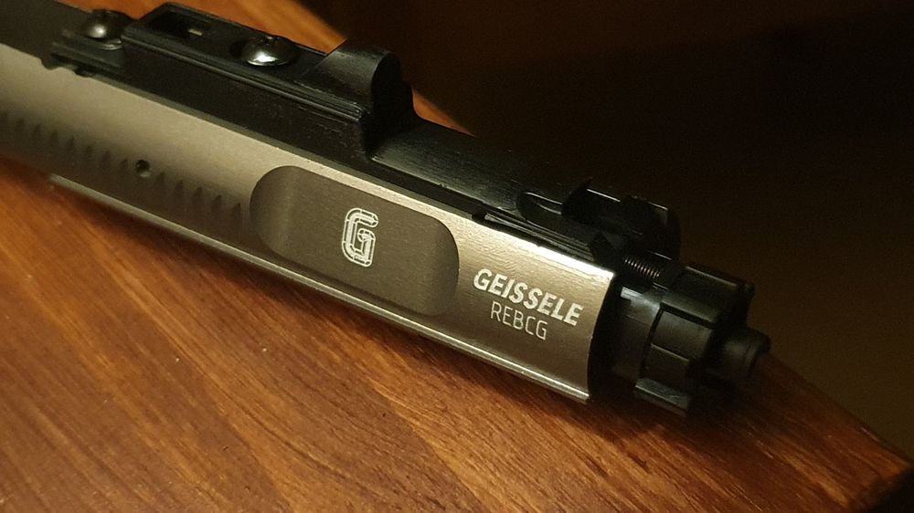

SSPKali Posted July 8, 2022 Posted July 8, 2022 Fitted the Hao heavy bolt end and G&P buffer spring (as the very old stock one is weak and shrinking!) to the stock MWS bolt carrier yesterday. Using the AG High Speed buffer weight (Alu) with the Hao end there is definitely more of a thump to the recoil but the TM mags were still giving ~120 shots before any obvious drop in FPS. Would still clear 140 BBs and lock back ? Action was nice and snappy and even full auto was fast. Now to find an AG Steel buffer weight to try it with…

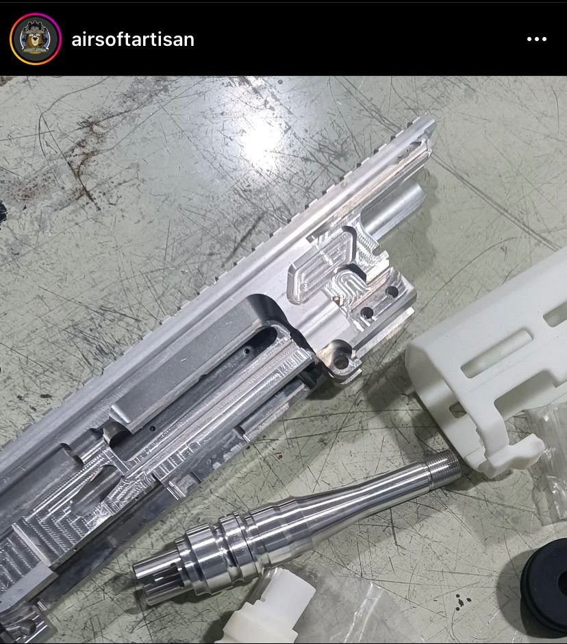

Wavey_Gravey Posted July 10, 2022 Posted July 10, 2022 MCX, it will be a kit to slap your internals into. M4ELATR0M 1
StayOnTarget Posted July 11, 2022 Posted July 11, 2022 20 hours ago, Wavey_Gravey said: MCX, it will be a kit to slap your internals into. Please god tell me this isn't an MCX Rattler kit...I don't think my bank account could take it ????
Wavey_Gravey Posted July 11, 2022 Posted July 11, 2022 1 hour ago, StayOnTarget said: Please god tell me this isn't an MCX Rattler kit...I don't think my bank account could take it ???? Haha my thoughts exactly! Unconfirmed but seems likely you’ll be able to pick and choose barrel / handguard length seeing as Airsoft artisan already make a large amount of MCX kit. StayOnTarget 1

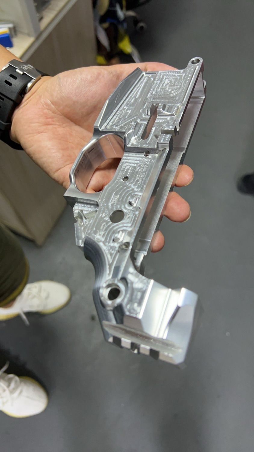

StayOnTarget Posted July 13, 2022 Posted July 13, 2022 14 hours ago, Crazy_Crystal said: Tbh I'm now torn between saving up for the L119A2 Hao kit or this.... both look like they're impressive kits anyway. I was thinking are they making the lower for the MCX too? If all you can do is replace the upper you're going to need to swap out the buffer tube for a RIS attachment to fit a fold stock. If that is the case I'm sticking with my Virtus/Rattler/m13 AEG. I keep wondering why they've not just done a Rattler of their own or even a Canebreak?
Wavey_Gravey Posted July 13, 2022 Posted July 13, 2022 (edited) Lower is coming too, like I said, it will be kit to drop in your internals. *Edit - New pic. Edited July 13, 2022 by Wavey_Gravey
Speedbird_666 Posted July 13, 2022 Posted July 13, 2022 6 hours ago, Wavey_Gravey said: Lower is coming too, like I said, it will be kit to drop in your internals. Jesus, that's impressive - I almost want to buy an MWS just so I can put an LVAW/Black Mamba build together...

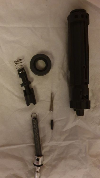

M4ELATR0M Posted July 14, 2022 Posted July 14, 2022 So I ordered two more nozzle-housings, some springs - in case I break any during fitting - and am now the proud daddy of a fully functional, bolt-locking, smooth rocking G&P carrier assembly while using the 50rds ProWin mags! Easiest solution was the first I tried and it worked flawlessly: - G&P SAI forged bolt carrier - G&P nozzle return spring and nozzle internals (come stock with the complete carrier) - ProWin nozzle housing - Dynamic Precision springset - some oil In case anyone ever needs help, ask me.
Davegolf Posted July 15, 2022 Posted July 15, 2022 @M4ELATR0M so what was causing your running issue?
M4ELATR0M Posted July 15, 2022 Posted July 15, 2022 2 minutes ago, Davegolf said: @M4ELATR0M so what was causing your running issue? After all it was a slight difference in the construction of the nozzle-intake. The G&P - and most aftermarket nozzles - have a slight bulge in front of the hole where the gas goes in. That bulge hits the gasket rubber of the ProWin mags ever so slightly since they are couple of mm's taller than stock to seal better with the nozzle-intake. That's it.
Davegolf Posted July 15, 2022 Posted July 15, 2022 All the superior parts causing problems then ? I jest, for the record magazine do not need taller gas routes 'for a better seal', all this does is exert excessive upward pressure on the working parts. If i have the right 'bulge' in mind, that is another upgrade for a problem that didnt exist in the MWS - poor BB pick up. So did you modify any of the aftermarket parts to work properly?
M4ELATR0M Posted July 15, 2022 Posted July 15, 2022 2 hours ago, Davegolf said: All the superior parts causing problems then ? I jest, for the record magazine do not need taller gas routes 'for a better seal', all this does is exert excessive upward pressure on the working parts. If i have the right 'bulge' in mind, that is another upgrade for a problem that didnt exist in the MWS - poor BB pick up. So did you modify any of the aftermarket parts to work properly? No modifications needed. - Would have mentioned that earlier if that was the case. The sealing of the ProWin mags in combination with the stock TM bolt carrier assembly is "better" - and does infact not interfere with the mechanism. Ergo: no upwards pressure. It does however put the aforementioned pressure on aftermarket parts like the G&P carrier because of the buldge. The feeding was flawless with all parts - stock and aftermarket - on any combo that I have tested so far by the way.
