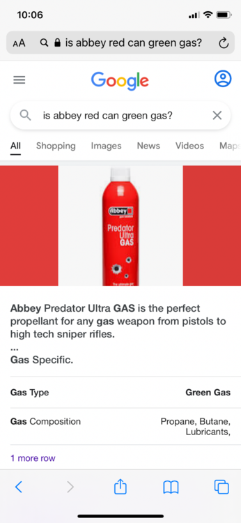

Reap Posted July 5, 2021 Share Posted July 5, 2021 (edited) 12 hours ago, ajumma said: Red gas runs at higher pressure than green/nuprol 2.0, so I would be wary of accelerated wear on weak parts like the nozzle spring and buffer. Aside from those though, it’s perfectly safe to use red gas depending on the ambient temperature. I used Nuprol 3.0 between 4 and 12°C with great success. I stuck to nuprol 2.0 between 12-20 though with no problems! Isn’t the red can of abbey equivalent of green gas? Edited July 5, 2021 by Reap Added picture Link to comment Share on other sites More sharing options...
EDcase Posted July 5, 2021 Share Posted July 5, 2021 (edited) 2 hours ago, Reap said: Isn’t the red can of abbey equivalent of green gas? They're both the same gas but the red is at higher pressure which can cause damage if used in a weapon not designed for it. (ie. TM) Edited July 5, 2021 by EDcase Link to comment Share on other sites More sharing options...
