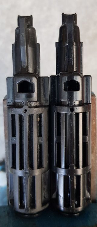

AlphaBear Posted April 29, 2021 Posted April 29, 2021 5 hours ago, GothicGhost said: Also UPS came and thanks to this thread I am £600 down and still more stuff I need to order ?? Well serves you right for reading this thread lol What are your plans for the CQBR? 4 hours ago, SSPKali said: I would but they are all assembled as I have been testing them! One day when I am bored I will EDIT I have measured the very old and worn TM one and the "old" but less used DP one - the DP is 0.41mm longer over all. New pic is the TM (left) and Old DP (right) side by side. It seems that the lightweight bolt has worse issues with low fps randomness. I think that certain combinations of bolt and nozzle mean the the BB can be seated too deep in the bucking meaning less fps and hop. New TM bucking with 4 clicks on the adjuster...may need one or two more but I only have a 10m range! DP nozzle with DP valve and G&P stop (low) in a DP lightweight bolt is giving 260fps (0.30g, ASG gas, 14degC) Same set up with G&P stop in the mid position = 315fps. No weird drops in power, all nice and consistent TM bolt with AG Mk2 complete nozzle is giving 270fps +/-5fps. Plenty of adjustment either way to compensate for the weather and ammo weight. I have the TM and AG Mk1 nozzles as spare spares should I trash the other two! The strange results with the TM nozzle are more than likely down to the wear on the front end of the nozzle... I would expect each shot to drop by an FPS or 2 simply due to the reduction in the volume of gas and hence less pressure in the mag. The erratic behaviour implies there is as compression issue that's for sure.... Also make sure the sealing buffer (the rubber washer) is properly lubed up each time you take the bolt apart... SSPKali 1

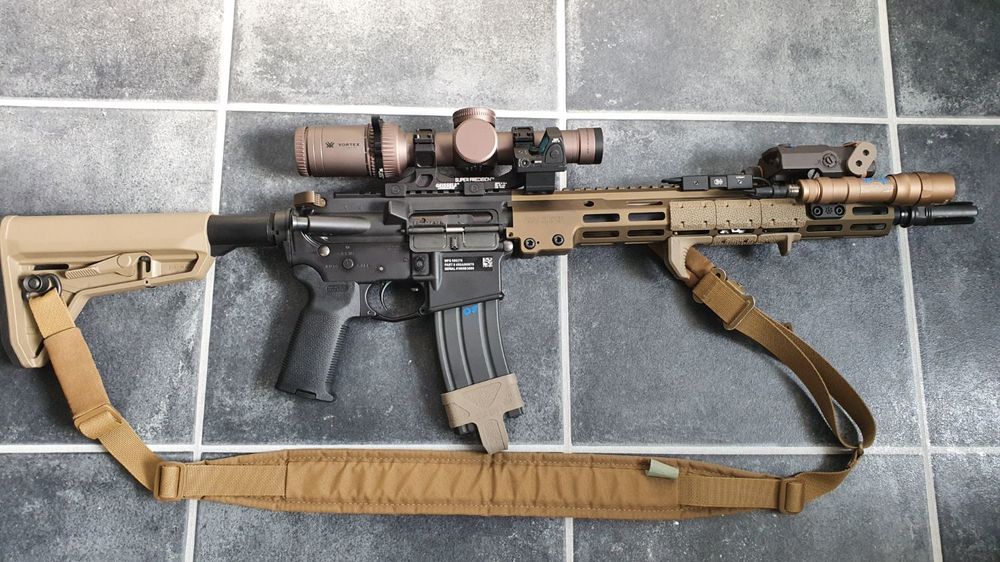

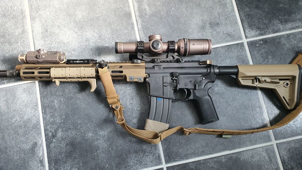

Popular Post quango2k Posted April 30, 2021 Popular Post Posted April 30, 2021 She is complete.....for now. Groot, GeorgePlaysAirsoft, Wild Weasel and 3 others 1 5
GothicGhost Posted April 30, 2021 Posted April 30, 2021 That's really nice....I need more money for my dream build.
