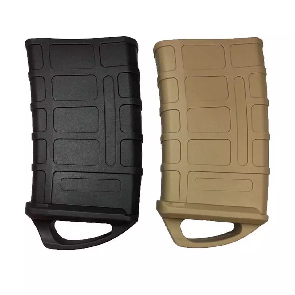

Hypokondrikern Posted December 6, 2020 Posted December 6, 2020 On 04/12/2020 at 20:17, jsmithski said: Anyone tried these rubber covers with TM MWS mags? just ordered 2 in black with a more simple design. I’m planning to use them on my 20 rounders to make them look like short pmags. I’ll also be taking off the “ranger plate” and cut a hole for gas filling.
jsmithski Posted December 6, 2020 Posted December 6, 2020 6 minutes ago, Hypokondrikern said: just ordered 2 in black with a more simple design. I’m planning to use them on my 20 rounders to make them look like short pmags. I’ll also be taking off the “ranger plate” and cut a hole for gas filling. These ones?

Hypokondrikern Posted December 6, 2020 Posted December 6, 2020 21 hours ago, jsmithski said: These ones? yes!

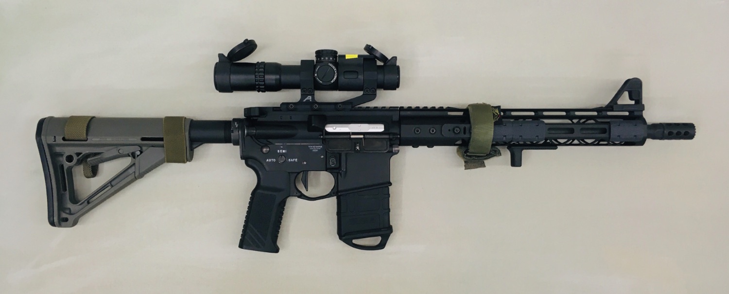

Hypokondrikern Posted December 8, 2020 Posted December 8, 2020 I can’t really decide what route to go for. Pixilus 1

Davegolf Posted December 8, 2020 Posted December 8, 2020 Also check if the problem is just one mag causing the issue, it may have damaged feed lips. @Hypokondrikern surely it’s down to your play style, both could be useful if your at assault FPS levels, MRO for active gaming upto medium ranges, and the short dot for more sneaky play / medium long ranges. Def the latter if you are at DMR FPS.

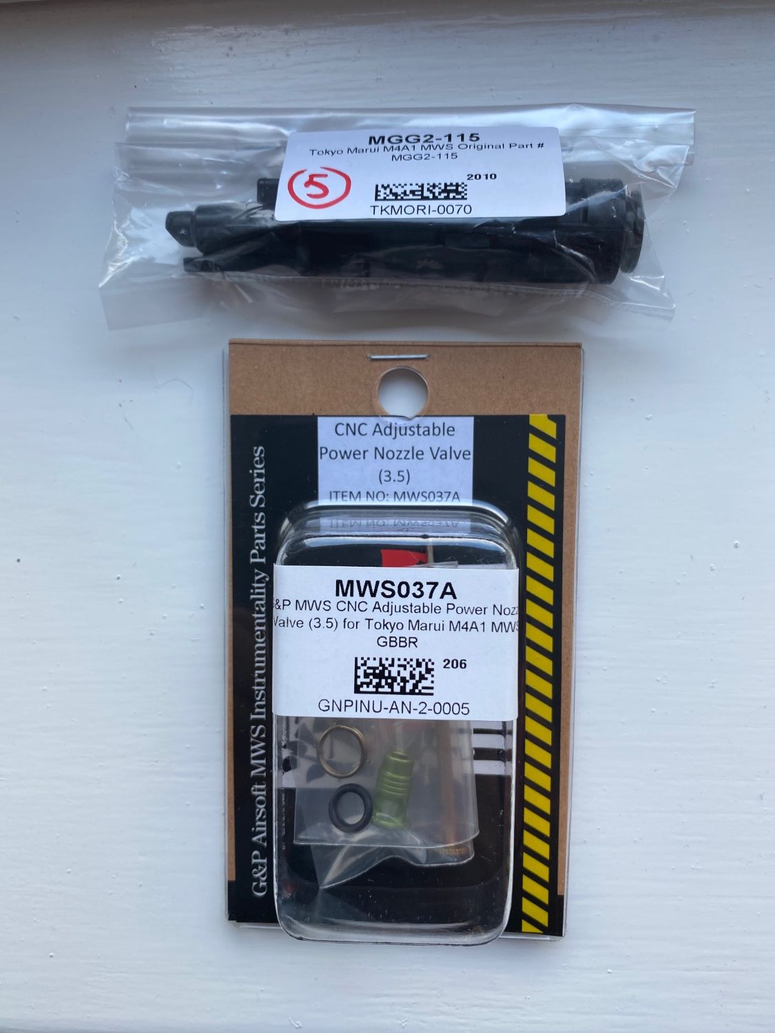

AlphaBear Posted December 10, 2020 Posted December 10, 2020 Got these two bits from Redwolf in HK. A spare Marui nozzle (rare as rocking horse poop) and a G&P valve. I’ll stick that into the G&P bolt to see if I can tame it’s it was running way too hot for my liking. Postage took 4 week using airmail so didn’t mind the wait. Cheap as chips too using that option. Happy days. Wild Weasel 1

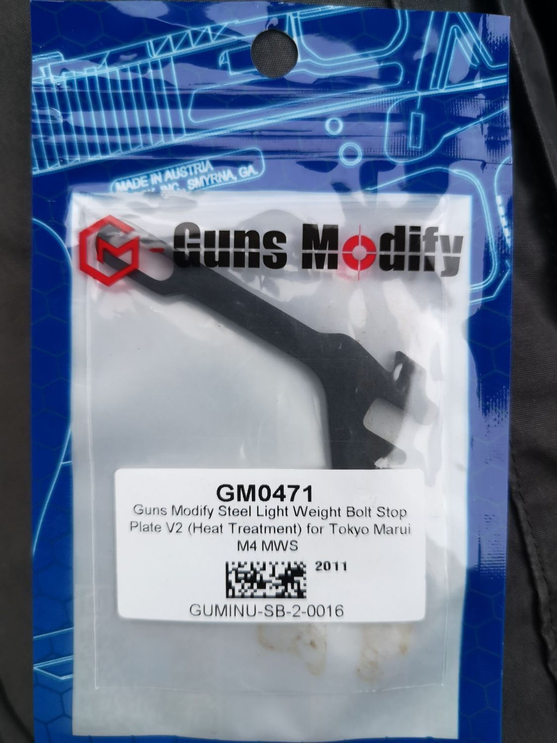

Wild Weasel Posted December 10, 2020 Posted December 10, 2020 (edited) Now then MWS tribe, Can anybody share any experience that they've had with this particular part as I'm thinking of swapping out the original as I'm still not happy with my bolt lock reliability. I'm going to wait to buy the ag maritime bolt catch before fighting with the trigger box removal again (someone please tell me that gets easier) as I plan on doing both in a one-year. Cheers crew! Using hao lightweight bolt TM weight and GnP buffer (empty) on mapp gas now. On 25/04/2020 at 12:50, Hypokondrikern said: I bought a set made by Gunsmodify from Red wolf airsoft. This set has served me well. P.S Redwolf has quite a lot of other parts as well which might be of interest. Otherwise go check out Rainbow8.com Did anyone try the lightweight bolt stop plates from Angry gun and Gunsmodify? Did you get a lightweight bolts top plate to try? http://www.gunsmodify.com/news/detail-id-59.html Edited December 10, 2020 by Wild Weasel Added website link

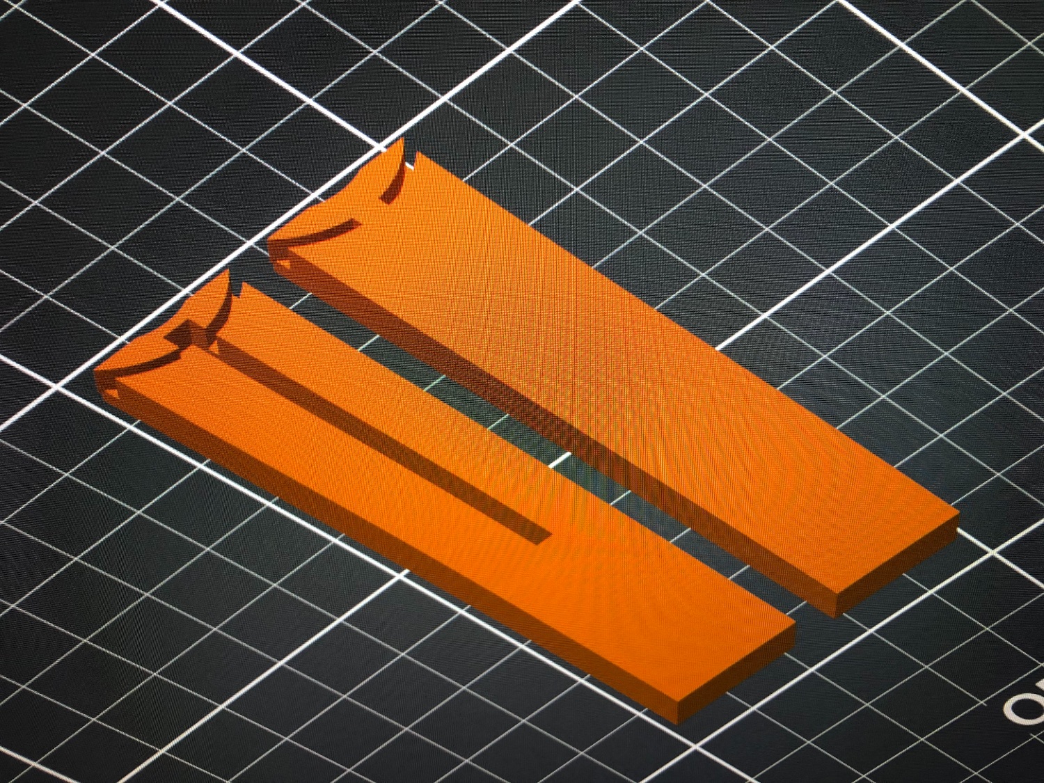

Supporters sp00n Posted December 10, 2020 Supporters Posted December 10, 2020 First iteration of a rail nut spanner for the TM mk18 (the one with the central cut away is for a peace of 4mm key steel) Wild Weasel 1
Hypokondrikern Posted December 10, 2020 Posted December 10, 2020 9 hours ago, Wild Weasel said: Now then MWS tribe, Can anybody share any experience that they've had with this particular part as I'm thinking of swapping out the original as I'm still not happy with my bolt lock reliability. I'm going to wait to buy the ag maritime bolt catch before fighting with the trigger box removal again (someone please tell me that gets easier) as I plan on doing both in a one-year. Cheers crew! Using hao lightweight bolt TM weight and GnP buffer (empty) on mapp gas now. Did you get a lightweight bolts top plate to try? http://www.gunsmodify.com/news/detail-id-59.html I have been interested in this item for a long time. Actually, I bought it twice from JK Army but was refunded as it was no longer in stock. Maybe a sign... @Davegolf true, I haven’t really decided what the platform is for me. I think just need to play more and tinker less. But I enjoy having a scope on the MWS as the accuracy and range is superb. It’s just a tad cumbersome and I’m slower with it than with the dot. The lamp is something I might ditch altogether though, as it feels very field specific or more like a real firearms utility.

AlphaBear Posted December 12, 2020 Posted December 12, 2020 G&P tend to run a tad hot. Well my stock G&P carrier bolt group did. That’s why I got the G&P adjustable valve to tame it down. I’ll get round to doing it once I muster up the enthusiasm and report back.
