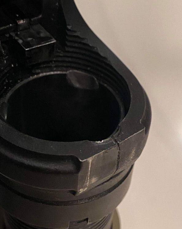

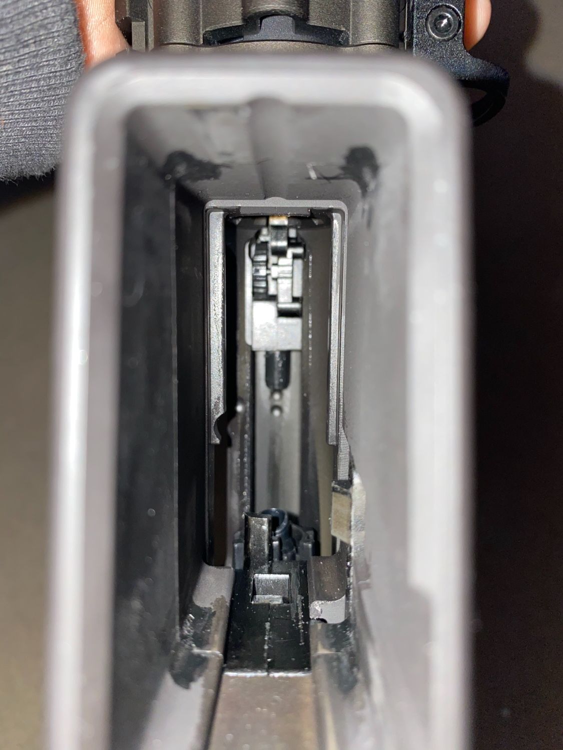

Wild Weasel Posted November 22, 2020 Share Posted November 22, 2020 (edited) 11 hours ago, Davegolf said: Is your buffer tube screwed in too far? I've just been on to William Hicks who got me started on this GnP buffer thing - https://www.instagram.com/p/B-YS5wfnIkX/?igshid=xsep5da90p6o the problem in short was bolt lock could not be achieved because one, I'm a twatt and two, I had the buffer tube wound out far too far as I could not get bolt lock and ended up winding out to far causing the GnP buffer to get stuck - I'm now wound all the way in and it has solved my problem. He recommends a rubber washer at the bottom of the TM original buffer tube to prevent the rubber on the buffer being chewed up too. Another point he made to me was check the BCG screws are tight or you can end up like his mate here... Edited November 22, 2020 by Wild Weasel Added ig link RMDavis and CoCost 2 Link to comment Share on other sites More sharing options...

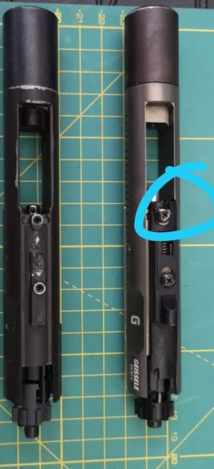

jsmithski Posted November 22, 2020 Share Posted November 22, 2020 3 hours ago, Wild Weasel said: I've just been on to William Hicks who got me started on this GnP buffer thing - https://www.instagram.com/p/B-YS5wfnIkX/?igshid=xsep5da90p6o the problem in short was bolt lock could not be achieved because one, I'm a twatt and two, I had the buffer tube wound out far too far as I could not get bolt lock and ended up winding out to far causing the GnP buffer to get stuck - I'm now wound all the way in and it has solved my problem. He recommends a rubber washer at the bottom of the TM original buffer tube to prevent the rubber on the buffer being chewed up too. Another point he made to me was check the BCG screws are tight or you can end up like his mate here... This can happen when you screw in the buffer tube to much or you use green gas and the bolt travels with a higher speed and force. For the top screw there’s not much you can do (I’ve compressed the buffer tube spring to make it stiffer), for the two side dents you need to either screw out the buffer tube or cut off few threads like I did so it does not protrude that much making contact with the bolt. Wild Weasel 1 Link to comment Share on other sites More sharing options...
Wild Weasel Posted November 22, 2020 Share Posted November 22, 2020 1 hour ago, jsmithski said: This can happen when you screw in the buffer tube to much or you use green gas and the bolt travels with a higher speed and force. For the top screw there’s not much you can do (I’ve compressed the buffer tube spring to make it stiffer), for the two side dents you need to either screw out the buffer tube or cut off few threads like I did so it does not protrude that much making contact with the bolt. Now that I have a reliable bolt lock I'm going to pack out the bottom of the buffer tube with washers to compress the spring a bit more a' la' hsb buffer style. Link to comment Share on other sites More sharing options...

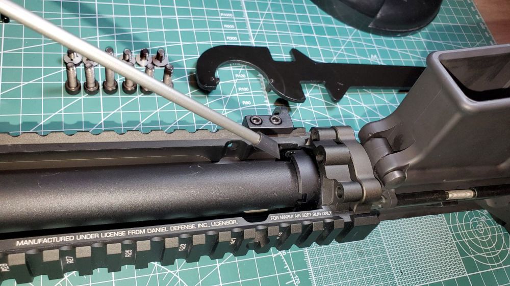

AlphaBear Posted November 23, 2020 Share Posted November 23, 2020 7 hours ago, Kerberos said: Yes, I've removed the side screws and the rear screws on the mk18 rail. Normally it would just be able to slide off on my old Madbull 12.5 RIS II, but for the TM there's a barrel nut inside the rail, so my normal castle nut wrench can't fit in Great Scott!!! So that’s TM’s take on a MK18 rail??? On the look of it that looks ridiculous. Why on earth would they design it in such a way that makes taking the barrel out difficult. There must be something which is missing here??? Surely they could not have been this dim too make it so awkward to change a hop rubber as an example? In a licensed MK18 rail that barrel nut locks the outer barrel in place making it free float but that does not seem to be the case here!!!! Really weird!!! Have you asked anyone on the Marui Recoil/GBB/GBBR Facebook group? Link to comment Share on other sites More sharing options...
Davegolf Posted November 23, 2020 Share Posted November 23, 2020 Yes you are correct @AlphaBear, better of buying an MWS and retro fitting a MK18 kit AlphaBear 1 Link to comment Share on other sites More sharing options...
Captain Darling Posted November 23, 2020 Share Posted November 23, 2020 7 hours ago, Kerberos said: Yes, I've removed the side screws and the rear screws on the mk18 rail. Normally it would just be able to slide off on my old Madbull 12.5 RIS II, but for the TM there's a barrel nut inside the rail, so my normal castle nut wrench can't fit in h Yes, I have managed to remove mine with a electric heat gun and 'special tool' I fabribodged at work from some (I think) 26mm OD conduit as seen the the attached pic. It was quite the horror show, but came off pretty easily once I had got it all clamped in a vice with an AR receiver clam. I shall be letting the tool go with the set when I flog the MK18 rail, barrel nut, flash hider, front sling loop point, rear stock and sights. Link to comment Share on other sites More sharing options...
Arassuil Posted November 23, 2020 Share Posted November 23, 2020 11 hours ago, Kerberos said: Yes, I've removed the side screws and the rear screws on the mk18 rail. Normally it would just be able to slide off on my old Madbull 12.5 RIS II, but for the TM there's a barrel nut inside the rail, so my normal castle nut wrench can't fit in I was doing my daily GBBR rounds and have responded to your reddit post also, but same thing here: This is the same rail that is on the MK18 NGRS and no, you cannot get a wrench around it. I got mine off by using flat head screwdriver in one of the square recesses and a mallet and start tapping down on it (anticlockwise/lefty loosey). It's aliminium and there's no thredlock, but it is tight and mine requried a few solid taps, enough so that it dented it. Link to comment Share on other sites More sharing options...

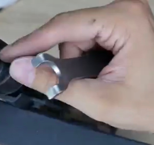

jsmithski Posted November 23, 2020 Share Posted November 23, 2020 You need something like this Link to comment Share on other sites More sharing options...
AlphaBear Posted November 23, 2020 Share Posted November 23, 2020 9 minutes ago, Arassuil said: I was doing my daily GBBR rounds and have responded to your reddit post also, but same thing here: This is the same rail that is on the MK18 NGRS and no, you cannot get a wrench around it. I got mine off by using flat head screwdriver in one of the square recesses and a mallet and start tapping down on it (anticlockwise/lefty loosey). It's aliminium and there's no thredlock, but it is tight and mine requried a few solid taps, enough so that it dented it. The mind boggles 😳. I still can’t get my head around how TM came up with such a design. Also is this the same way in which a NGRS rail also comes off? Link to comment Share on other sites More sharing options...
Arassuil Posted November 23, 2020 Share Posted November 23, 2020 from the picture, it's the same rail they use on the Mk18 NGRS which I have. It's not an issue on the NGRS as you swap barrels and rubbers from the inside. I'm surprised they used the same design on the MWS though due to how you have to change the rubbers Link to comment Share on other sites More sharing options...
