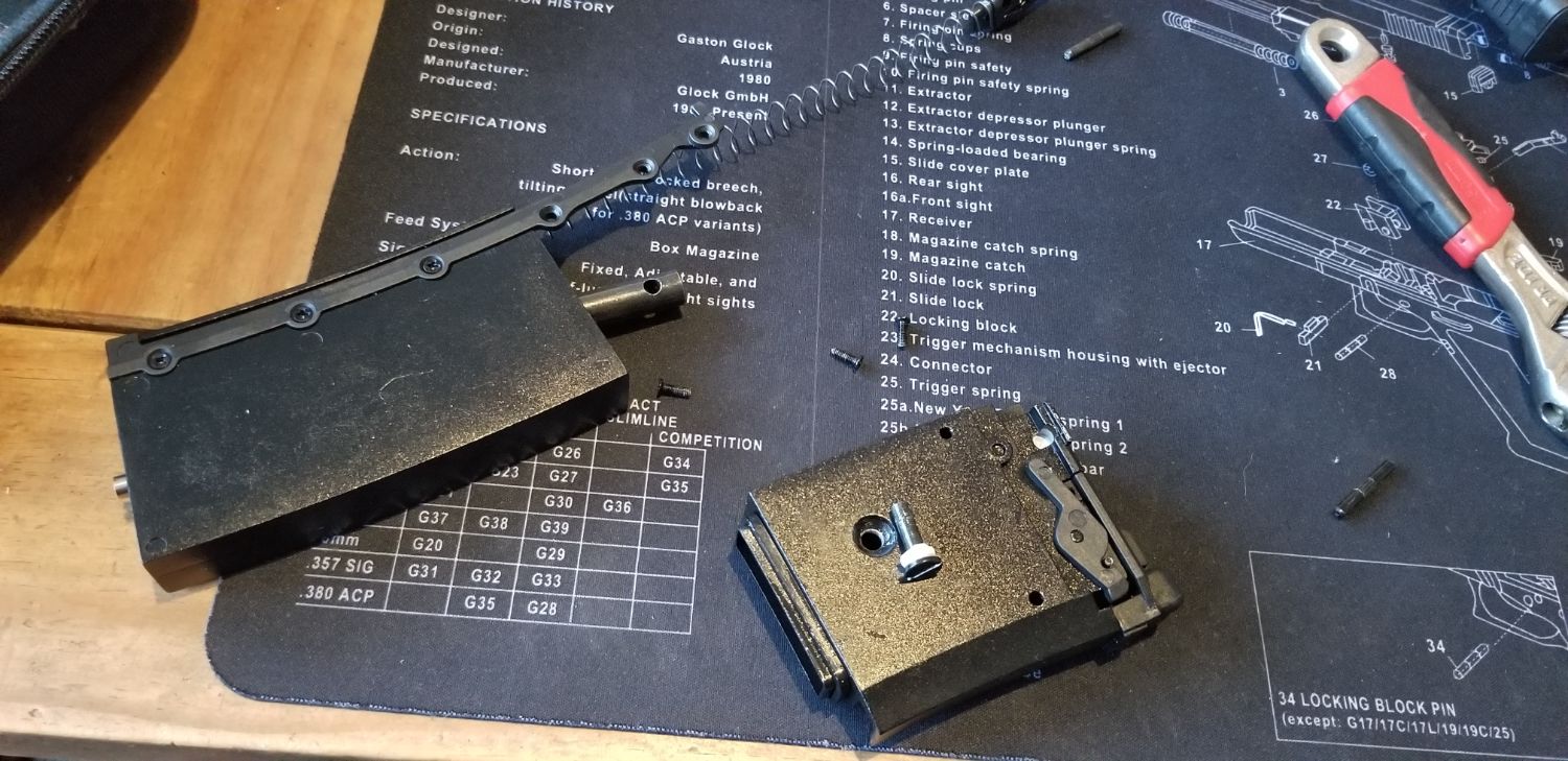

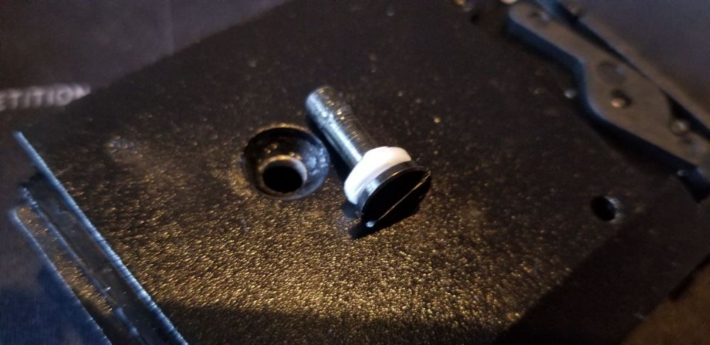

PMag update 2.0
Just solved the leakage problem!
I need a few more days to make sure its reliable ...
Probably they not gave proper attention for screw in....

Hi ,
I was problem with o-ring union middle mag .. use PTFE to repair .
If you have dudes to PMAG , I did a lot of test to better performance

Yes that O-ring is a piece of sheet....
But after 16 hours its still keeps in the 11g propane !
I will drop on the scale again few days later.

I check leak introducing mag under water ... I wait 5-10min and see that it´s ok

I had the same problem. Sneaky leaks. Greased all o-rings. Still leaky. Found this screw and lubed it - so far all fine.
how was it to reassemble the upper and lower part? Looks like a pain

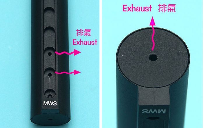

Also - G&P has a buffertube with the selling point of holes for exhausting air / gases. Could someone explain to me how this would be beneficial or whether it’s just a gimmick?

Yeah..the reassamble is not pleasant but not difficult as it looks like...so the screw engage to the overhanging rod ,just need to find the good angle.
Pmag update 2.5 :
(2nd Day)still keeps!

It is supposed to give a smoother operation of the bolt and seem to work as intended. Look at my previous post about their complete kit for the MWS. The sound is incredible.  Yet ... the holes are mysterious to me...

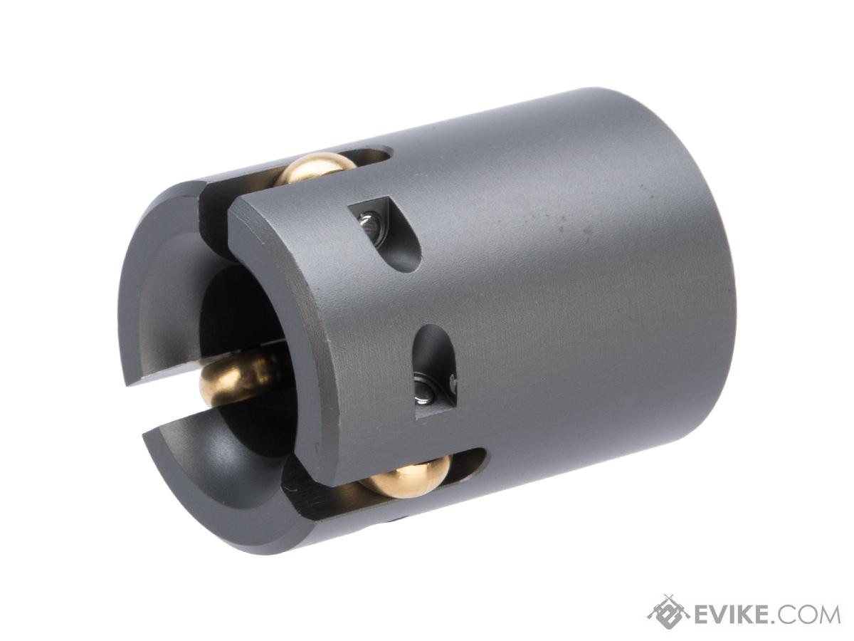

Going down the rabbit hole...... at least I'm in California and the weather is good year round.
And if you can get etsy stuff shipped to the United kingdom this my be a nifty item.
https://www.etsy.com/listing/855357705/speed-loader-adapters-compatible-with?ref=shop_home_active_1&variation0=1505309745
