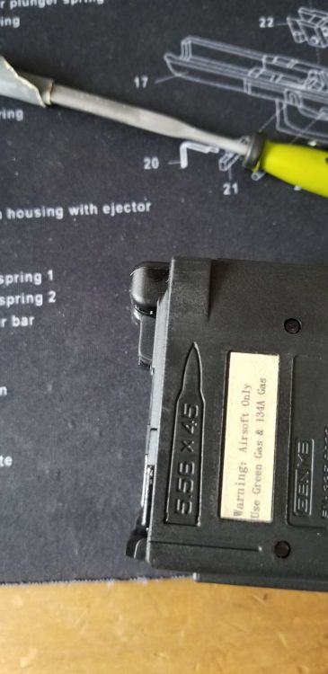

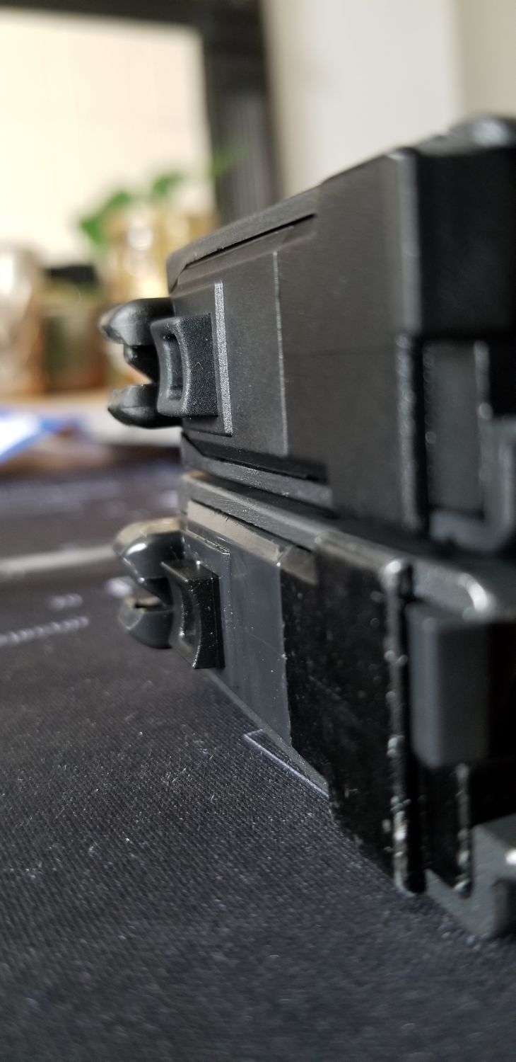

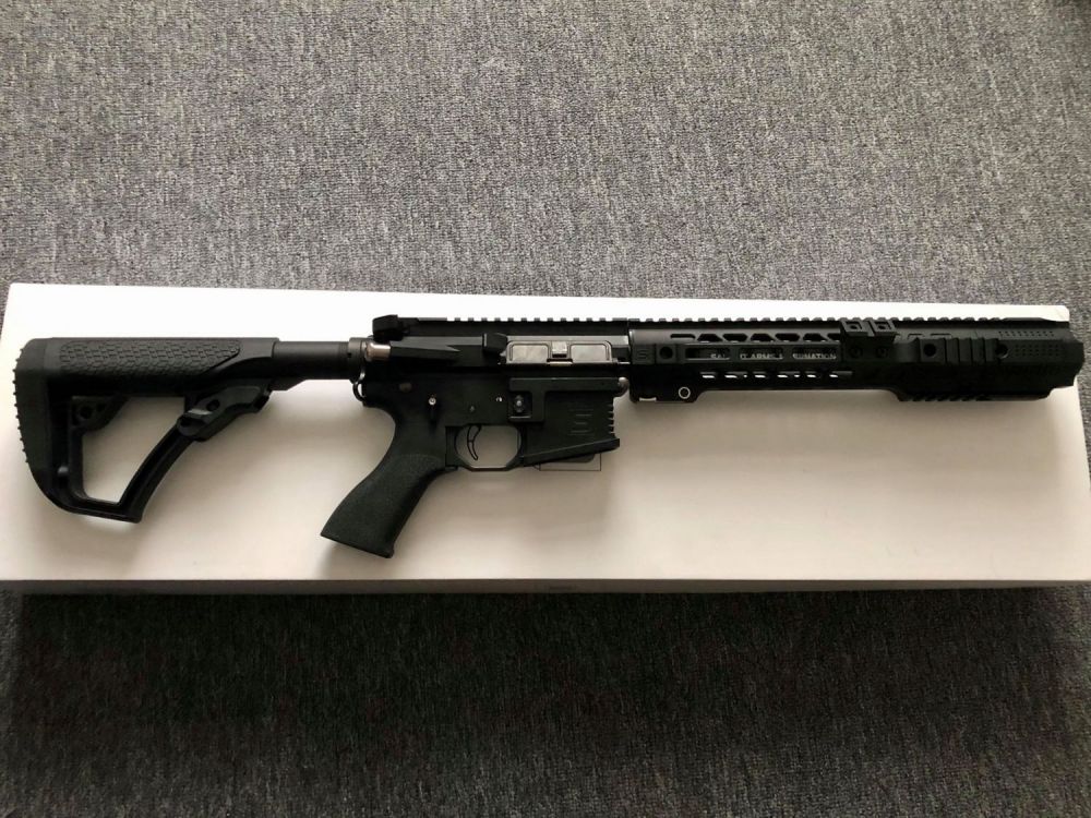

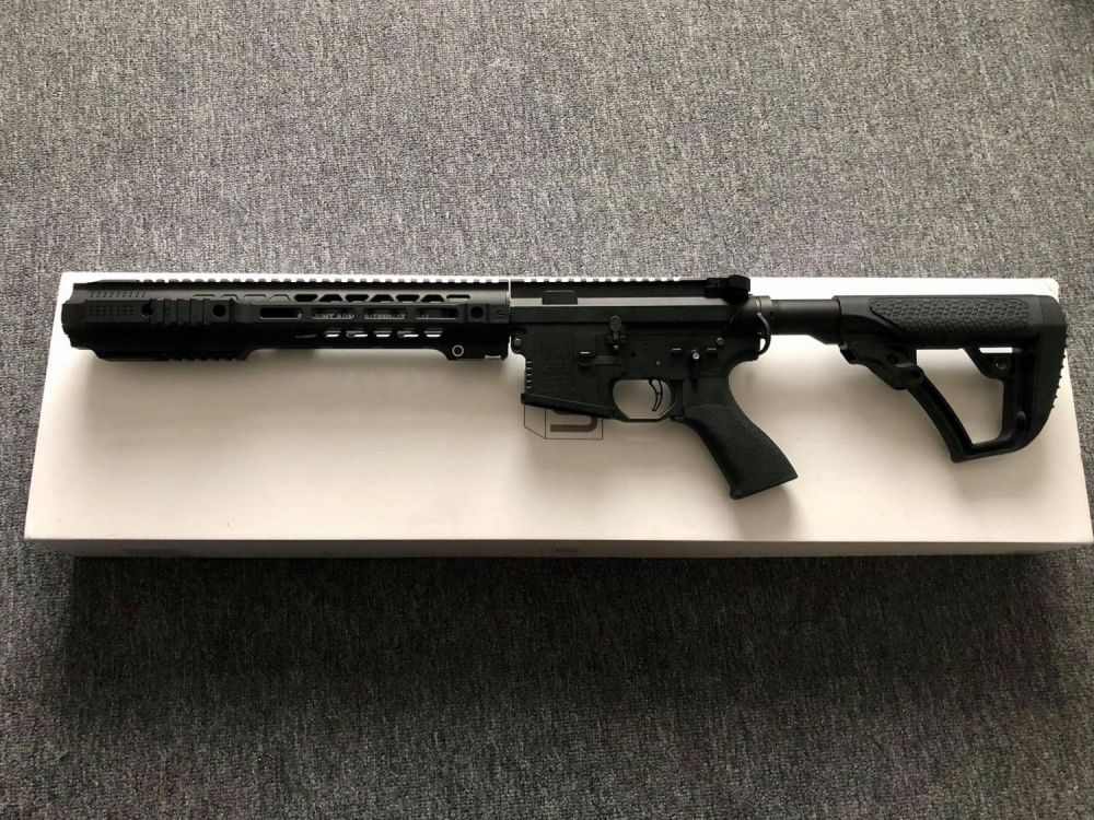

P4radox Posted July 26, 2020 Posted July 26, 2020 Just got the new SAA Pmags yesterday, This is the updated version much better than the previous reviews ,was tested today in under proper war circiumstances, maybe the empty lever still needs some modification but haven't got serious problems with them, I need more time and tests before tell anything definitive ! (1st pic-> lower is the orginal one)

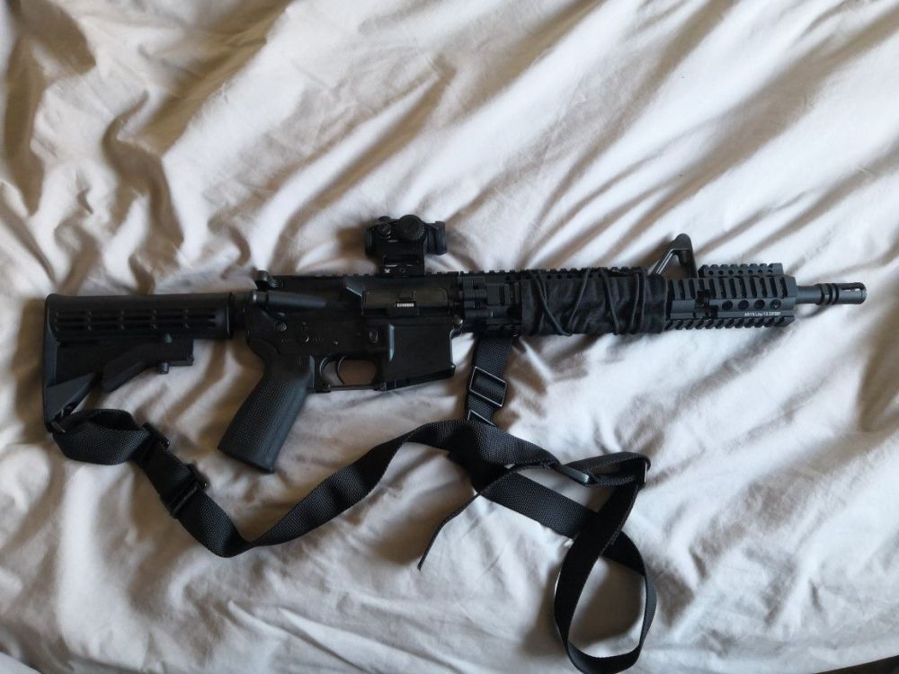

RMDavis Posted July 27, 2020 Posted July 27, 2020 First game out with the MWS/Mini Urgi build, and what can say about this truly fantastic RIF that every other owner hasn't already said!? Apart from the fact it's all bloody true! ? I should of moved over to a GBBR a long time ago, and anyone on the fence reading this thread I urge you to take the plunge! The performance and consistency is incredible, and with a zero'd Vortex Crossfire it's so much fun to use. Taking out a guy who's using a HPA minigun, with a single shot is extremely satisfying... ? (skirmish fun times) SSPKali, AlphaBear, Davegolf and 1 other 3 1

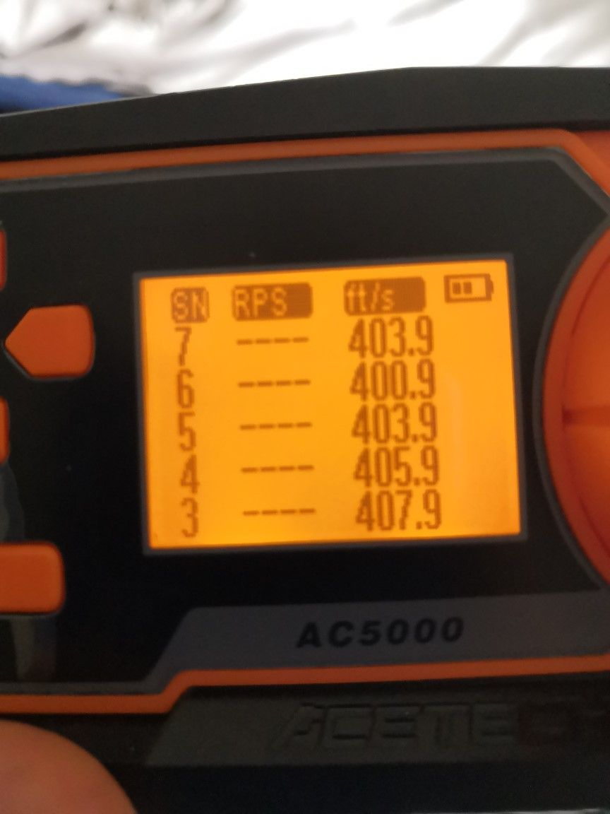

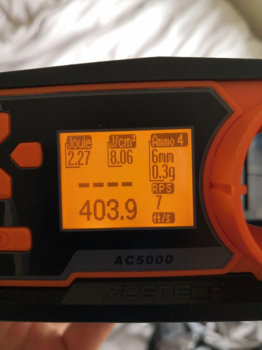

Arassuil Posted July 28, 2020 Posted July 28, 2020 No Problem and am Happy to help. I had a bit of time over lunch so here's a bit more information. I installed it just before the pandemic so I've only been able to field it twice so I don't know about long term, but threadlock wasn't needed. I set it in the morning and checked it during the lunchtime break and it did not need readjusting. Attached are a few pictures. The BCG with the valve installed and where it sits to get my desired FPS. I also maxed it and crono'd some rounds to give an idea of the max fps of this 4.5 valve. To get the variables out of the way, this is standard TM BCG (except for springs), 6.03 370mm barrel, Modify tan rubber, CNC'd hop arm with some hop applied. Mag was probably half full. Lastly, the MWS in question Hypokondrikern 1

SSPKali Posted July 28, 2020 Posted July 28, 2020 3 hours ago, Arassuil said: Attached are a few pictures. The BCG with the valve installed and where it sits to get my desired FPS. I also maxed it and crono'd some rounds to give an idea of the max fps of this 4.5 valve. To get the variables out of the way, this is standard TM BCG (except for springs), 6.03 370mm barrel, Modify tan rubber, CNC'd hop arm with some hop applied. Mag was probably half full. That is really consistent! my RA silver NPAS manages +/- 6fps and after 10 shots it really drops due to mag cool down. Got my AEG +/- 1fps but pretty sure a GBBR won't do that (or need to) Just tested it and on 0.28g it is between 278 and 290fps (one outlier at 294fps, so still under site limit) DP lightweight bolt, AG nozzle, DP springs and the RA NPAS almost all the way closed. Modify Tan bucking hopping 0.32g and a Crazy Jet 250mm barrel. No idea on bore as previous owner installed it.
