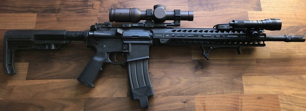

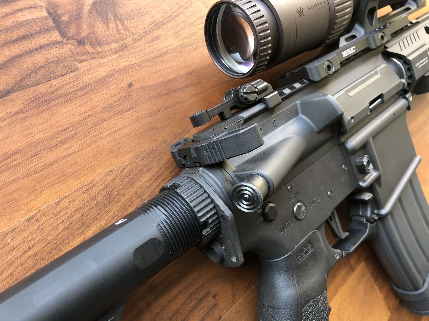

Popular Post LVOA-D Posted May 4, 2020 Popular Post Posted May 4, 2020 Got a care package in the mail from Poland today so I am finally able to "finish" my Strike Industries build . Was only missing the takedown pins, buffer tube and adjustable scope mount, really happy with how the build turned out! Wild Weasel, alxndrhll, PopRocket123 and 6 others 2 7

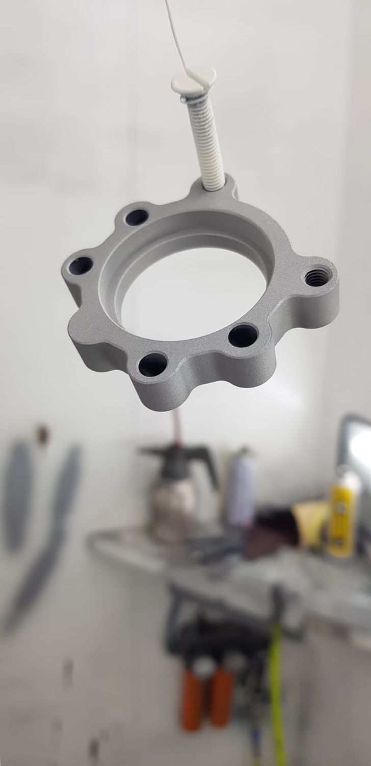

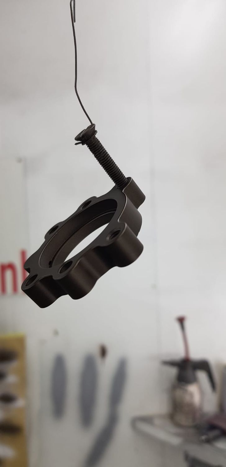

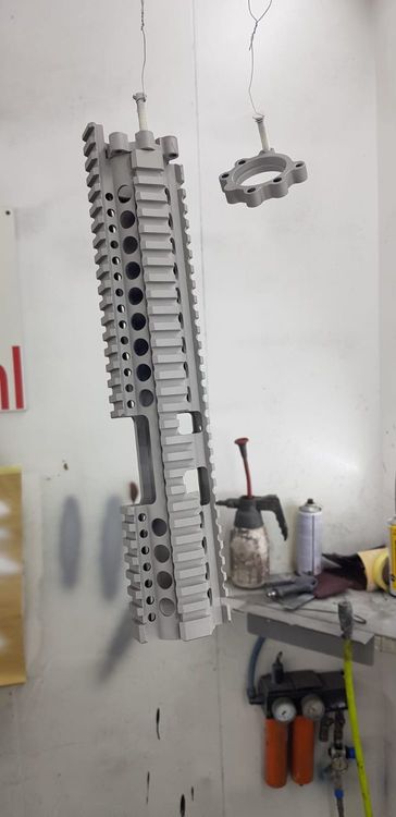

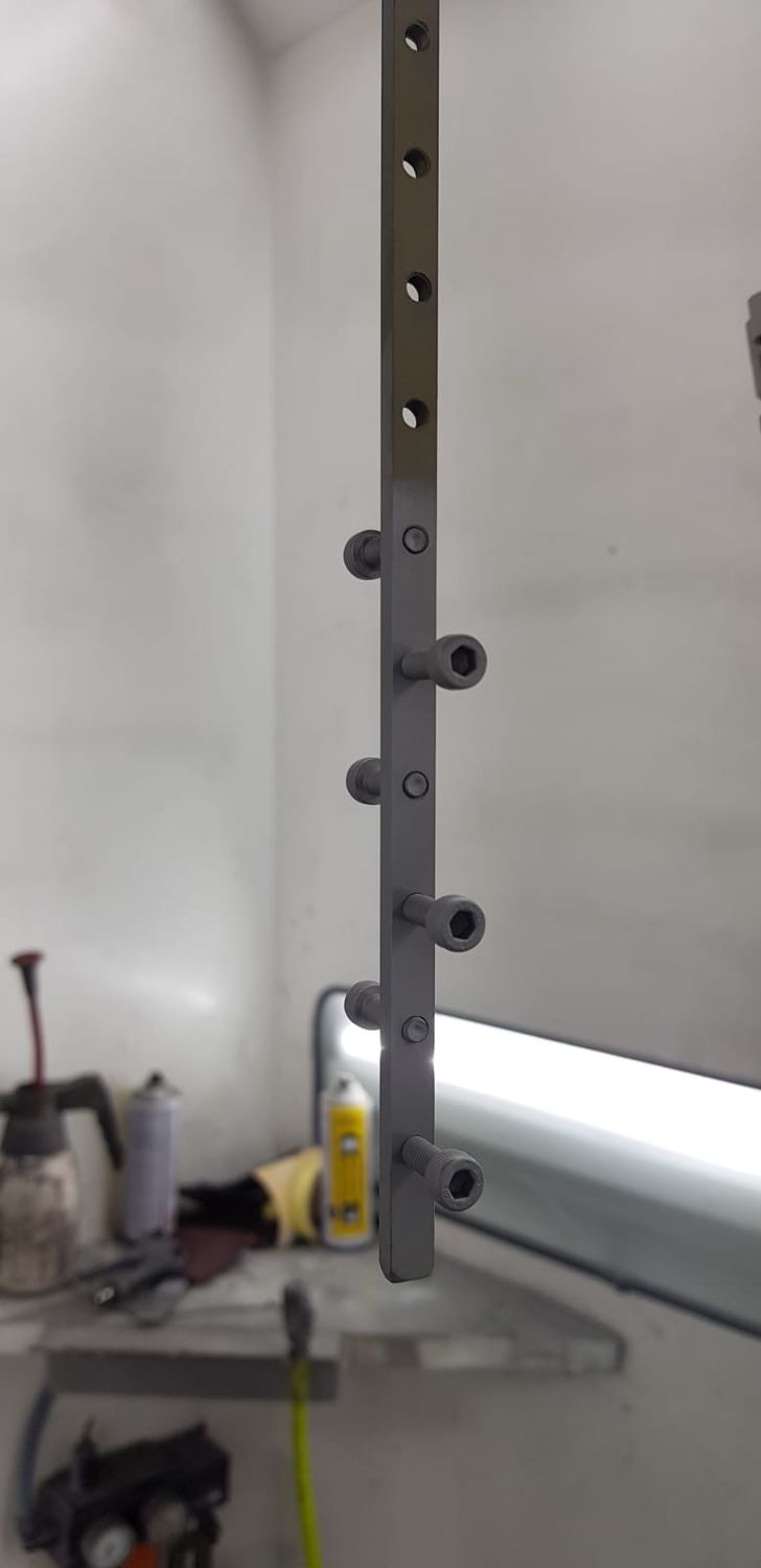

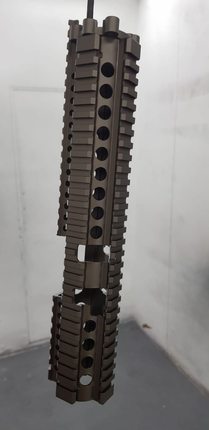

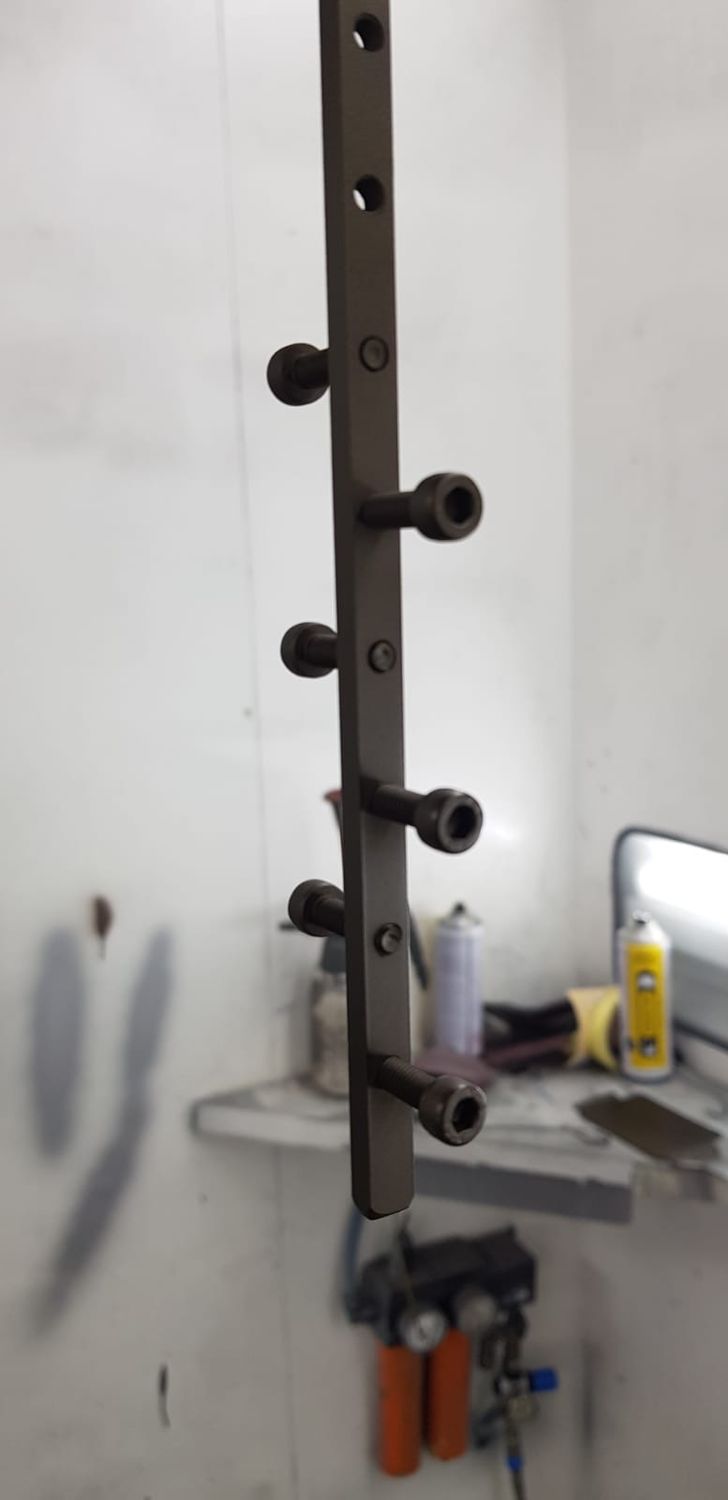

LVOA-D Posted May 5, 2020 Posted May 5, 2020 Sorry for hijacking this thread with my photobombs but I got my Madbull RIS II FSP rail cerakoted and picked it up today, looks absolutely stunning if I say so myself! It's for my 2nd MWS build, Block II FSP replica. Unfortunately I still do not have my FDE stock yet, last part I am missing for the build. Anyways, here are some pictures of my rail getting Cerakoted, was a black rail to start with but forgot to take pictures of it SSPKali 1

LVOA-D Posted May 6, 2020 Posted May 6, 2020 18 hours ago, Davegolf said: Nice, which Cerakote'ers are you using? Considering I am based in The Netherlands I had it done by Camogun. Must say, even though for the majority of this forum it's not really useful information, but they are great. Was my first time Cerakoting and my first experience with them and they've been sound. Mailed back and forth to decide on a color, decided to send the rail in via the post and a few days later I was bombarded with these great pictures. Picked it up a few days after and had a nice chat with one of the owners who explained all the options they had for Cerakoting so all in all, I can really recommend them! RobHedley 1

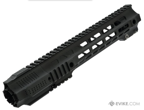

Seven Posted May 9, 2020 Posted May 9, 2020 I've finally decided to pull the proverbial trigger and get me one of these bad boys, CQBR version. Already ordering parts! Just ordered myself a licensed EMG/SAI QD Rail with JailBrake, pictured below. Will be picking up a Magpul MOE stock too. Just need to find myself a nice skeletonised pistol grip and foregrip and i'll be all set I think... not including optic of course. Kinda excited!
