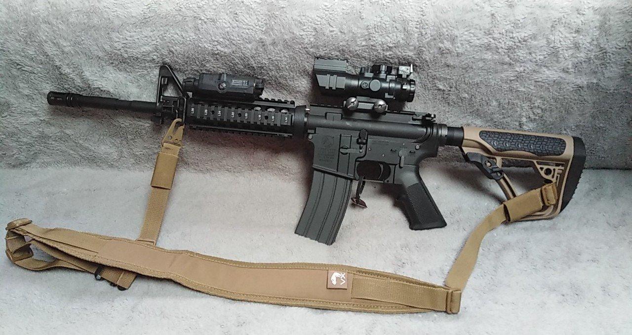

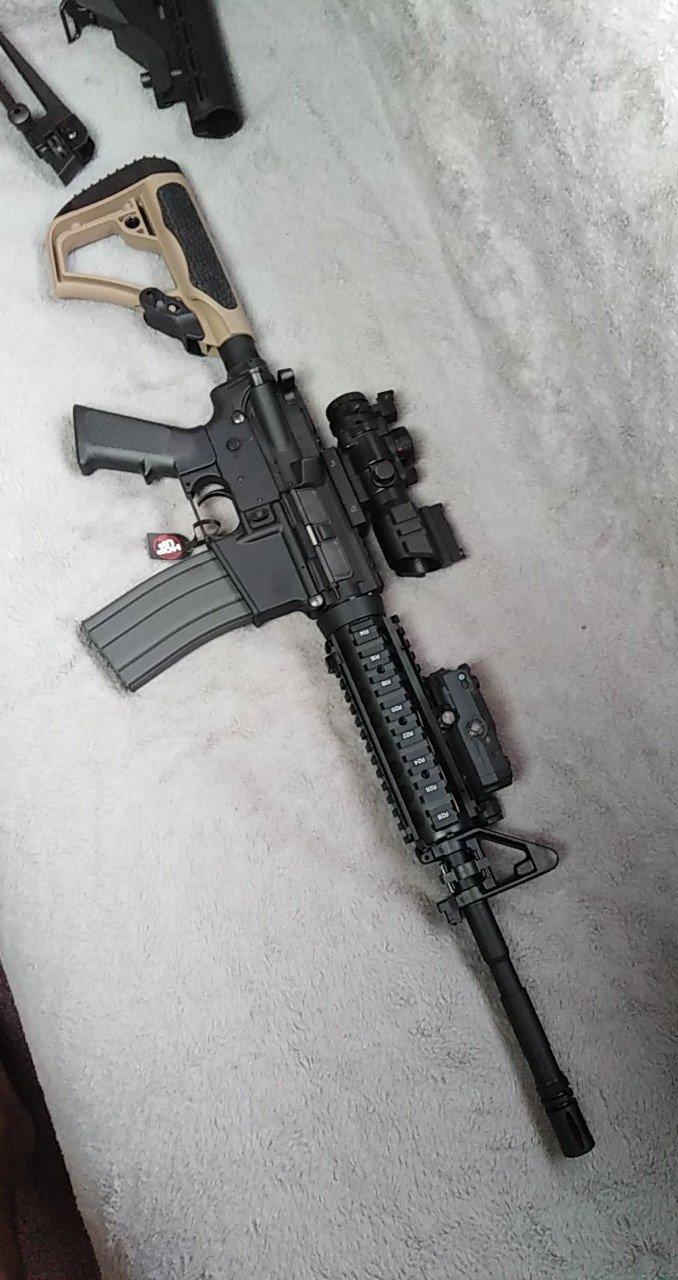

Mitchwalk3r Posted March 25, 2020 Posted March 25, 2020 Well this just got expensive. Started off life as an M4 carbine already had the mws handguard fitted and a friend has done the 'biro mod' as well as a few other bits before I take delivery and really make it my own LVOA-D, RobHedley and GothicGhost 1 1 1

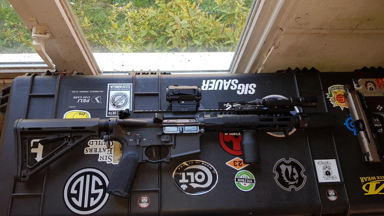

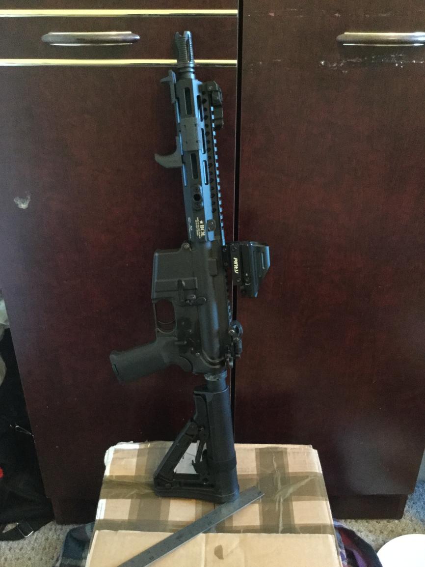

hunter511 Posted March 26, 2020 Posted March 26, 2020 Latest glamour shot of the soon to be finally completed BCM recce style cqb build. LVOA-D 1

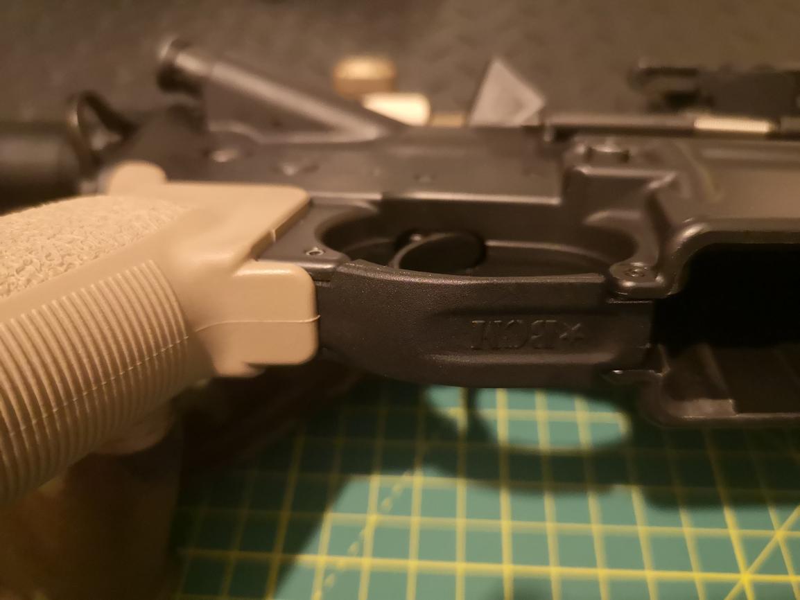

Whisky1 Posted March 26, 2020 Posted March 26, 2020 Hey guys, So being locked up and doing alot of plinking I've been getting quite abit of bite' from the trigger guard. So my question is are mws trigger guards real steel compatable? Also do we know what parts are real steel compatable, be good to have a list. Thanks alot guys!!
Softcore Posted March 27, 2020 Posted March 27, 2020 13 hours ago, hunter511 said: Latest glamour shot of the soon to be finally completed BCM recce style cqb build. Beautiful, love the mcmr rail, what manufacturer is it? C&C Tac, DyTac or AngryGun?

Guest Posted March 27, 2020 Posted March 27, 2020 8 hours ago, Whisky1 said: Hey guys, So being locked up and doing alot of plinking I've been getting quite abit of bite' from the trigger guard. So my question is are mws trigger guards real steel compatable? Also do we know what parts are real steel compatable, be good to have a list. Thanks alot guys!! @Cyberlawyer

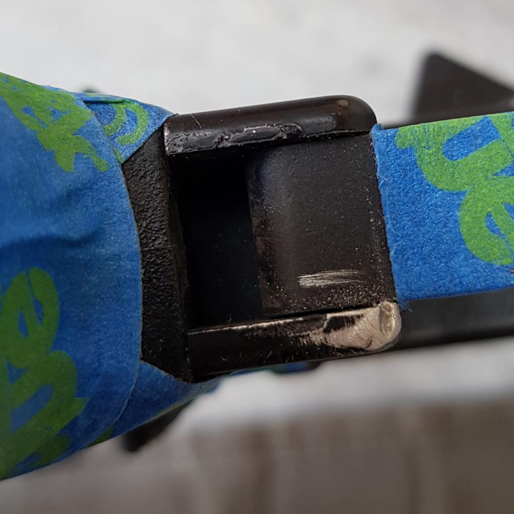

Cyberlawyer Posted March 27, 2020 Posted March 27, 2020 I can’t say if real steel trigger guards fit, but real steal grips will (although you need to use the original MWS bolt to attach them). I had a problem with the attachment point from the trigger guard digging into my middle finger. I don’t think a different trigger guard would have fixed this as the issue was actually the bracket where the trigger guard attaches with the roll pin. I fixed it by using some ‘Sugru’ to fill the void and hide the sharp bit. It’s a neat job and looks factory. ill try and take a picture later today. GothicGhost, SSPKali and Whisky1 2 1
SSPKali Posted March 27, 2020 Posted March 27, 2020 26 minutes ago, Cyberlawyer said: I had a problem with the attachment point from the trigger guard digging into my middle finger. I don’t think a different trigger guard would have fixed this as the issue was actually the bracket where the trigger guard attaches with the roll pin. I fixed it by using some ‘Sugru’ to fill the void and hide the sharp bit. It’s a neat job and looks factory. ill try and take a picture later today. I have the same issue, seems the previous owner scuffed it and left a burr on there. Will break out the Sugru later and post some pics too....because I have sod all else to do.
hunter511 Posted March 27, 2020 Posted March 27, 2020 @Softcore Angry gun BCM bolt, barrel, mcmr 8 rail and surefire blast warden. Furniture is RS stuff and the scout light setup is all genuine as well.
Softcore Posted March 27, 2020 Posted March 27, 2020 @hunter511 Did you need a barrel nut adapter? How good does it sit on the barrel nut? Any wobble? I'm currently contemplating on getting a 13 inch mcmr clone, either AG or C&Ctac, and was wondering if it would fit the stock mws 14.5 inch socom barrel.
PopRocket123 Posted March 27, 2020 Posted March 27, 2020 15 hours ago, Whisky1 said: Hey guys, So being locked up and doing alot of plinking I've been getting quite abit of bite' from the trigger guard. So my question is are mws trigger guards real steel compatable? Also do we know what parts are real steel compatable, be good to have a list. Thanks alot guys!! I can't tell you if they're compatible but the comfiest by far that I've found are the plastic MAGPUL style ones. Everything else always has a sharp edge to it
Mitchwalk3r Posted March 27, 2020 Posted March 27, 2020 Literally only had the gun a few hours and already made some external changes. Originally the TM M4A1 CARBINE. With an mws handguard, Daniels defence stock, PEQ, acog 3x sight and viper tan sling
hunter511 Posted March 27, 2020 Posted March 27, 2020 3 hours ago, Softcore said: @hunter511 Did you need a barrel nut adapter? How good does it sit on the barrel nut? Any wobble? I'm currently contemplating on getting a 13 inch mcmr clone, either AG or C&Ctac, and was wondering if it would fit the stock mws 14.5 inch socom barrel. You should be fine mate. Mine went straight on. I did IIRC need some barrel shims just to snug it up. That said now I think about it it's a laylax 8way barrel in there as AG aren't making a BCM 9inch outer. On monday I'll try and have a play about with the actual Tm barrel.
Wild Weasel Posted March 27, 2020 Posted March 27, 2020 23 hours ago, Whisky1 said: Hey guys, So being locked up and doing alot of plinking I've been getting quite abit of bite' from the trigger guard. So my question is are mws trigger guards real steel compatable? Also do we know what parts are real steel compatable, be good to have a list. Thanks alot guys!! I fitted a rs BCM gunfighter trigger guard to mine, I had to do a small amount of filling on the trigger guard at the front on top to get the small hex screw hole to line up, also the drift pin that came with it is too large diameter so be nice to your existing mws one to re use. Make sure you support the "wings" when you tap this through or you risk breaking them off!

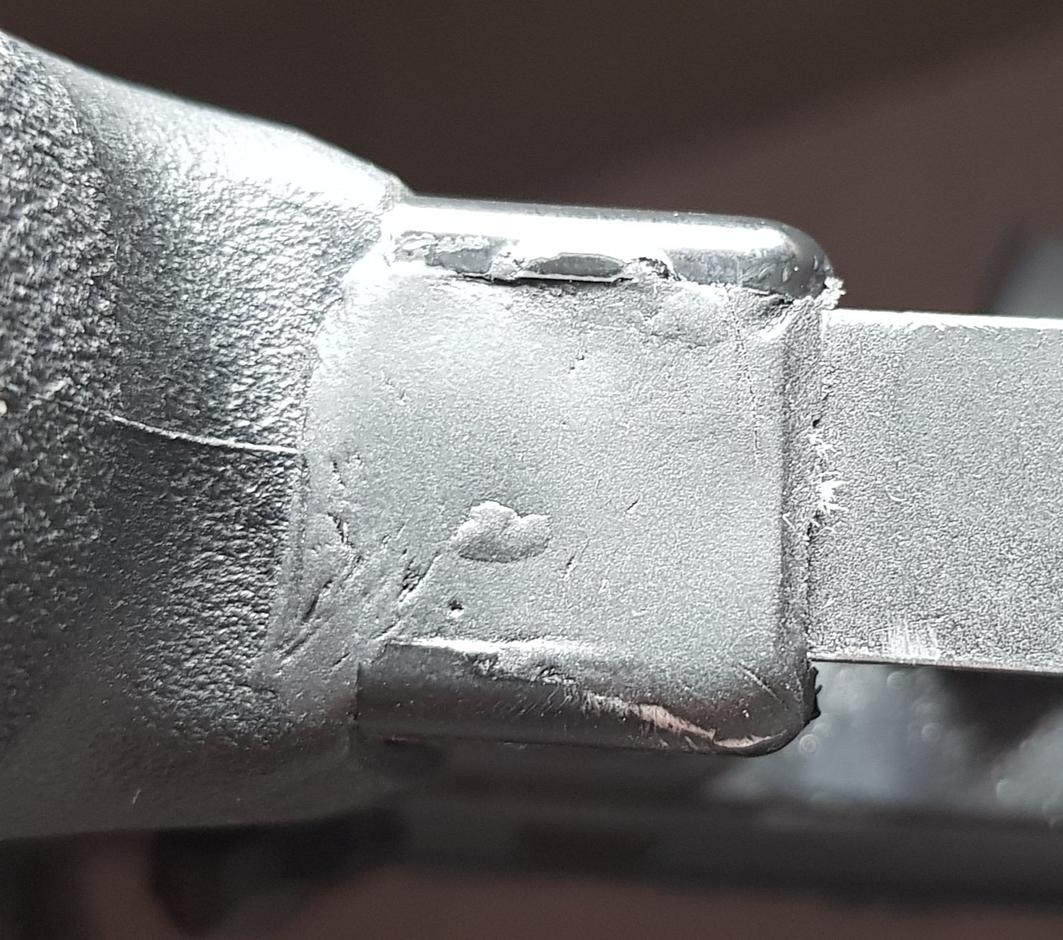

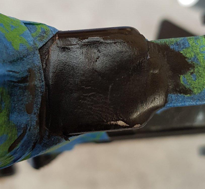

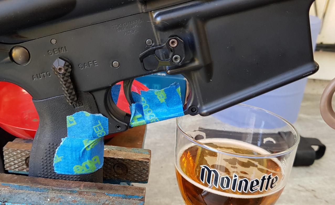

SSPKali Posted March 28, 2020 Posted March 28, 2020 So on inspection there was not only the sharp edges of the trigger guard wings but also a hefty burr from a knock it had taken. I cleaned up the burr with some fine wet&dry paper, de-greased the area and then masked it off ready. I used black Sugru to fill the gap and blend into the trigger guard wings and also around the scuffed area. I let it set over night and removed the tape then used a craft knife to tidy up the front where it had overlapped the tape. Feels great and you would not notice it unless you turned the gun over and squinted ? Cipher-032 1

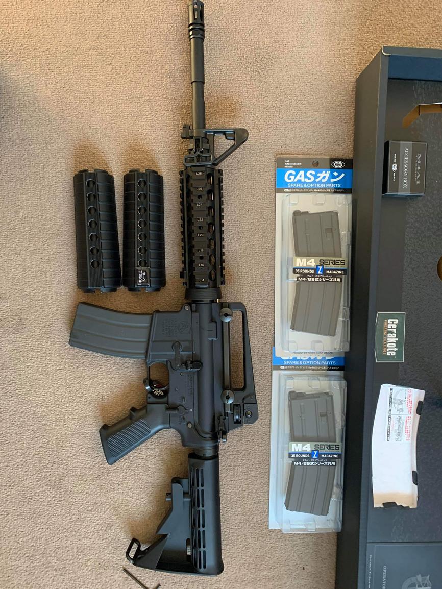

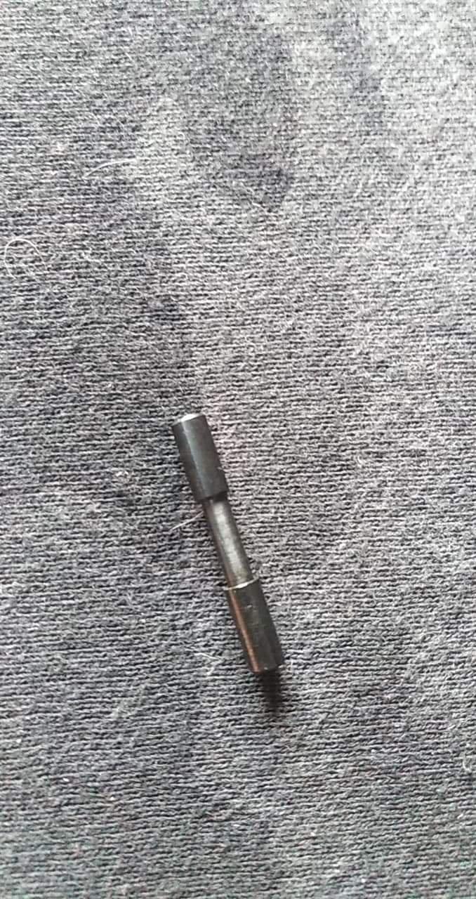

Mitchwalk3r Posted March 29, 2020 Posted March 29, 2020 So went to swap my sling mount on my TM m4a1 carbine(with mws handguard) and found this on the floor. Anyone shed some light on what it is please

Ninjacabbage Posted March 30, 2020 Posted March 30, 2020 On 27/03/2020 at 14:41, Softcore said: @hunter511 Did you need a barrel nut adapter? How good does it sit on the barrel nut? Any wobble? I'm currently contemplating on getting a 13 inch mcmr clone, either AG or C&Ctac, and was wondering if it would fit the stock mws 14.5 inch socom barrel. I have the ag 8inch mcmr Not tried it with a barrel nut adapter but I can say for sure it don’t work with a stock barrel out the box..got mine on and the barrel just plopped strait out. Didn’t go with a barrel nut as I had ordered this https://www.ebay.co.uk/itm/5KU-8-7-Inch-CQB-Airsoft-Outer-Barrel-For-Marui-M4A1-MWS-GBB-14mmCCW-5KU-MWS-2/283301788016?ssPageName=STRK%3AMEBIDX%3AIT&_trksid=p2057872.m2749.l2649 needed to back some of the shims in masking tape to get everything to line up tight on the barrel nut but it fits great and feels super sturdy..and looks sexy
