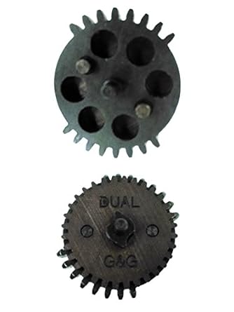

Also worth noting that G&G could have totally ripped off Seigtek DSG - RiotSC was not approached by G&G
and it seems to be a clone of his gears he said
dsg-set-2-wm_large.jpeg?v=1404903008
Note the 3 holes on each side of gear - not SHS type or Modify's either
if you look at the launch poster of the HC05 it shows a DSG exactly like the above pic
So not impressed that G&G "could" have ripped off Seigtek DSG - RiotSC's design

Well the gearbox is a bit crap tbh...
They fitted 9mm ceramic bearings but not all the same ones...
Sector & Spur/middle gear have 9mm outer & 5mm inner race ceramics
Bevel gear though 9mm outer & 3mm inner race
So in effect the sector/spur gears have thicker but not so common 5mm shafts
Bevel - average bevel gear I suppose 3mm shaft
Gear Ratio is 18:1 no mega spring spacers
but jeez that spring (was at rest btw coz released AR latch) is a mofo
Also all steel teeth & strengthen piston - std G&G piston head & plastic white cylinder head used in normal CM's
seals not bad but is new with say 250 300 rounds through it - could/should be a tad better
But AOE wasn't done either - just like CM's - yup 2nd tooth removed but that was it, maybe usual 2-4mm sorbo needed
Nozzle - looked bog standard CM non o-ring nozzle - deffo could be a lot better
Ah yes no cut off lever - ok should be able to put in one...
NOPE - dual sector does NOT have any cam lift point(s) on there at all
Great - coz they are 5mm shafts and 9mm outer rim bearings can't fit a SHS Dual Sector either
(well I could I guess if I had say normal 9mm/3mm bearings but only got up to 8mm)
On top of that the finish sector shimmed tight - ok got that a bit better but it snags at same point
(deffo sector - well 99% it is sector with bad finish - very crap)
but even after picking through all teeth on both sector/spur and smoothing over the back of sector
coz it was that roughly cut finished still seems to snag/bind a little it seems - jeez this was really just chucked together

GEARBOX WITH DIFFERENT SIZE BEARINGS....
CRAP AOE & DIY PORTING OF CYLINDER
DSG STILL SNAGGING ON SPUR, SOMETHING IS STILL SHARP AND CRAP
PLUS THE SPRING BEARING GUIDE THAT ISN'T FULLY SECURED TOGETHER
Not one of their best bits of AEG building and really should charged a bit more to put it together properly
WITH SEMI AUTO !!!!
use SHS DSG ffs if you don't want to use Seigtek's - but c'mon this is really a bit of a let down I feel

There is something deffo wrong with them gears and snagging/binding on sector/spur
holding box together with just those 2 gears in there you get to a point and they snag
keep going at this snag point and the very top of box starts to open/seperate then closes back after snag point
the gears finish is like some really blunt cutting tool or more like roughly punched/cut out - hence me trying to file
and try to reduce the rough snagging finish.
It is either a bad - no very f*cking bad finish like I think or the shafts/gears are bent perhaps - jeez this is crap
Never experienced stuff this bad before even on a crappy cheapo set of gears
and the ceramics are quite deep needing very very few special shims on there so can't just keep adding shims
(well they are bigger shims 5mm hole that I don't have and M5 washers are way way too fat)
The ceramic bearings - well they ain't like them super duper Modify ones that seem to spin forever
Actually had ordinary 8mm bearings spin better/longer but the ceramics are supposed to be much stronger.
(well like I said not impressed with a not so long spin test on them)

Able to still use G&G DSG - think the spur gear was the worst of the 2 binding/snagging, something is bad on gear finish
Anyway, moved ceramic 9mm/3mm bearing up to spur gear fitted a pair of SHS 9mm bearings to bevel gear.
Then used a SHS bevel & spur gear - shimmed nicely and reckon she runs really well and might work ok......
Slightly stronger (smidge heavier) piston all metal teeth - 2nd tooth removed already & shaved down 3rd for AOE
Also removed last 8 unused teeth & swiss cheesed on top but left sides - nice n tidy but not a great deal lighter
wasn't happy with lightish stock piston head's seal - was never as good as alloy but think I found another plastic/POM one
Probably dropping bearings from piston head too as got them in spring guide....
Complete piston weight is about 21.5gms fully assembled - no bearings but has plastic spacer in piston instead now
Stock piston with bearings was about 27.5gms so 6gms saved on a heavier hopefully more robust piston even with cheesing

my first cheesy piston:
The gearbox with 9/5mm sector ceramic, the smaller 9/3mm spur ceramic moved up from bevel & SHS 9/3mm bearing:

Another thing is that ORIGINALLY G&G DID make a DSG with cut off lever cams
though this was a limited production run way before HC05 was made
maybe they had to pull it for copyright issues with Seigetek so pulled the 3mm axle with cams
then made a 5mm axle no semi cam DSG - yeah WTF ???
see here on an old Amazon Japan site pic shows the 3mm axle and cut off cams....
G&G ARMAMENT G-10-102 Double Sector Gear
This was probably the gear set option showcased by G&G at the 2015 Shot Show with 3mm axle & COL cams
Alas the HC05 went into production with crappy 5mm axle & no semi DSG gear - absolutely stupid idea
So yeah - avoid the G&G HC05 & perhaps a QUICK UPDATE - lol on the M160 motor is way too quick
(just in case you think of getting one of those bad bot motors as they really are quick - ergh too quick & warm running)
Just a quick update, mainly in case people are thinking of buying the M160 motor - old review of mine
and my choice today would be a 30k not 45k motor
(ultra high speed & heat is not the be all & end all I have learnt the hard way)
Edit - pasted the SHS DSG on Amazon instead of the old G&G one - doooh my bad
removed the SHS link & updated....
G&G did originally make a 3mm axle DSG gear with COL cams
(probably showcased in 2015 but likely pulled due to copyright issues)
So they made the poxy 5mm axle no semi gear instead - stupid doesn't even cover it
see here G&G's Riot rip-off clone DSG with 3mm axles & COL cams no longer made
if only they had put this in or come to an agreement with Riot/SHS or something the HC05 would have had semi
https://www.amazon.co.jp/ARMAMENT-G-10-102-Double-Sector-Gear/dp/B007JQGHPK
