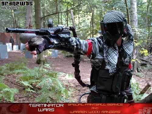

An ergonomic paintball gun retains a form of stock via the air cylinder as the point of contact still provides stability and grip.  But it doesn’t have to be a classic stock wedged into the shoulder.
A curved fibre wrapped cylinder allows it to be ‘rolled’ in the shoulder and also the gun angled over in front of the face - making you a smaller target and putting the point of aim to in front of your eyes instead of needing to lean your head over to the point of aim
The grip pretty much remains as is - this part of a gun is designed around human hands, but specific grip types vary.
An obscure paintball grip angled forwards, which was partially novelty value and partially ergonomics - but it didn’t take off well as it was different than the ‘norm’.  See the example below with the extreme of the Z frame and a ‘kick up’ ‘drop backward’
(similar to a ‘drop forward’ but reversed - a drop forward would allow a cyclinder to be fitted, lowered down and pushed forward which give a ‘better’ position making the combination shorter and  easier to angle in front of the face)
As with bull pups the trigger grip doesn’t have to be physically behind the chamber.  It doesn’t even have to be a trigger, a switch will do - see also attached
This was ‘easy’ to point and shoot with a button - but he found it very tiring holding up his arm with the 100 round Qpod also on his arm, though the air source was via a remote line.
An airsoft edition would be more compact, could be all one unit and much lighter - but still involve holding your arm up most of the day - handy for a sneaky assassin type

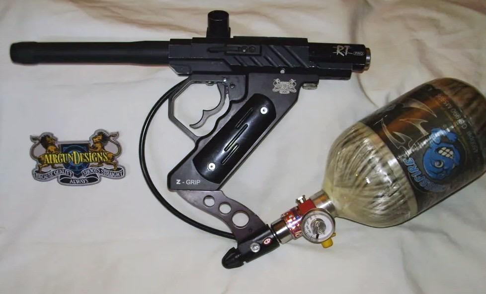

  On 11/12/2023 at 15:44, Tommikka said:
Z frame
Expand
I once saw a Bob Long 2k2 Timmy with a prototype (raw aluminium) Z frame at the European indoor tournament around 2003-4. It was gopping. And the ICD Bushmaster looked even worse with one fitted.
Thank god they didn't become the 'norm'.
Expand
But I’m still jealous that you saw a live one
