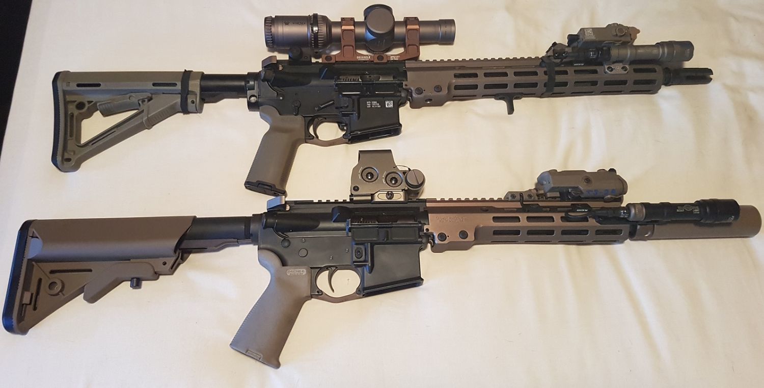

Popular Post mightyjebus Posted July 11, 2021 Popular Post Posted July 11, 2021 I'm going to do this review slightly differnetly from normal. Usually I'd take the AEG to bits and talk about the good and bad parts but there are plenty of youtube videos out there comparing the GBLS to other platforms and very little on what it is like to use one. I'll cover the elephant in the room, the price, later on in the review and give my thoughts. So this is my GBLS and I bought the budget/skeleton kit for a couple of reasons. As much as the full rifle is nice I was never going to keep the supplied rail and was probably always going to make my own verison (Mk18 ish in my case however this might change to a MK16 or L119A2 depending on what I finally settle on). If you have been living under a rock a little bit about what the GBLS is might help..or not. It's not a GBB rifle but it uses a similar design, it's not really a typical AEG but it uses a similar design. Confused? Well the closest thing to it would probably be the TOP M4 shell ejecting M4 but the GBLS doesn't eject shells. Inside the lower receiver you will find the gearbox and in the pistol grip is the motor. In the upper receiver you will find full sized bolt. Inside the bolt is the piston head and spring. The way it works is you pull the charging handle to the rear and when you release it it pushes the bolt forward and chambers a BB in the hop unit. You pull the trigger and this releases the compressed spring which pushes air out the front of the bolt propelling the BB out the barrel. At the same time the gearbox kicks in and cycles the bolt again and loads another BB. If set to semi it does this once. If set to auto it does that until every BB is fired out the magazine and the bolt locks in the rear position and you then take out the mag, replace with a fresh mag and hit the bolt release which loads a BB in the hop. I'm going to be aiming these next comments to people who have been skirmishing a while and use PTW's, GBB's and NGRS's. You know that way on a PTW you can get a quick double tap off quickly and both BB's will mostly likely hit the target. On the GBLS that's not going to happen. Well it will but you are going to have to train with it to get a grip with the recoil as after the first cycle of the bolt your aim will be off by quite a bit. You know the way when you full auto a GBB rifle and the FPS drops about 30 or 40 from the first shot to the 35th shot. Yeah that doesn't happen. The FPS is consistant from BB 1 to BB 60. You know that sound and slight recoil you get when you fire a NGRS well that doesn't happen. You get a very nice kick and quite a loud sound as the bolt slams forward. I'm not having a go at these other platforms as I have them all and enjoy them but the GBLS is just a bit different and in a good way. I'll do a few more comparisons to the other platforms so that the more experienced players get where I'm coming from. On the GBB it's great to have the bolt lock back making you do a mag swap, slap the bolt release and get back in the game. When I run a GBB (MWS, GHK, VFC, or any of the others I run) I'm always concerned that the gas I'm using which was under the site limits at the start of the day is now pushing the BB's above the site limit because it's now the afternoon and it's 10 degrees hotter. I'm also concerned that in the colder months in the UK I'm not getting the best from the platform because it's cold so tend not to use them. The GBLS gives me the mag swaps and the recoil I get from my GBB's but at a consistant FPS the whole year. The recoil is probably just as good as my MWS running sub 350 FPS and if there is a difference it's hardly noticable. On the PTW or a NGRS with a Titan fitted I get some nice snappy shots off. I don't get this on the GBLS. My first shot is snappy and on target but the 2nd shot will need adjusting (GBB people will know what I'm talking about). On the GBLS the trigger pull feels very real. I've heard that the trigger pull was about 10 lb but mine seems to be about 8. It feels very realistic with a nice break and reset. It feels more realistic than my GBB's never mind the PTW and NGRS. My opinion at the moment is the GBLS DAS is more realistic than a PTW or NGRS and more reliable than a GBB. Before I move on to price I'll mention the following. I ordered 2 Nupol 11.1V 30C Lipoi batteries as I thought the GBLS might eat through a battery since it's shifting the heavy bolt back and forward. I used 16 full mags today on 1 battery and there is still plenty of juice left in it so it doesn't seem to be current hungry. I had zero jams, stoppages or feeding problems with the 8 mags I used (although I did loose one somewhere along with a Glock 19 but thats another story!). I took it out the box, set the hop with 0.3g blaster BB's and was easily hitting 55 meters with accuracy and the FPS is running at around 320 (on a 0.2g BB). To be clear I have done nothing to it, straight out the box if fires flawlessly and that leads into the price. So £1350 for a toy gun is quite excessive or is it? Let's have a look at the other toys out there. Let's start with the GBB as this is probably the cheapest platform when comparing it to the rest unless you look at the running costs over a long period of time. So a MWS is around £500 then you add 7 more mags at £45 a pop. Let's also remember that carrying 8 BGG mags is a chore as they weigh a ton. Let's say you want to get the best range out to 55/60 meters so you might chuck in a tightbore and maple leaf rubber and possibly a NPAS to control the FPS. So you are probably looking at about a grand now. TM NGRS can be a bit of a money pit when it comes to getting the best out of them. £550 for the AEG, £150 for the titan, 8 mags at £25 each, tightbore, S hop, new spring and spring guide and possibly reinforced gears to replace the soft TM gears. We are probably at around £1200 now. PTW's are anywhere from £1200 to £2000 depending on the model you buy but then you have spare mags, possibly get the hop sorted, have the electrics waterproofed and then maybe have the motor rewired. God knows the final price of a full tuned PTW. I hate to think how much I've spent over the years on them. At this point you might be seeing the point I'm trying to make. £1350 plus £35 a mag doesn't seem that expensive when you don't have to upgrade/replace/rewire anything and it justs works as advertised out the box and is more realisitc and reliably than the other platforms. Are there any negatives? I know of 1 and heard of another but never experienced it. The electronic board in the gearbox doesn't like to get wet or so I have heard. Tell me a titan or Systema board that does. My only slight gripe is the metal mags rattle a bit inside the magwell. This is genuinely the only negative I could find with the GBLS. Is it the best airsoft gun in the world? well no but it is the most reliably realistic one out there and it's very much a nice experience using it. I'll finish this review of with a couple of notes. I handed it to about 10 team mates today and everyone had a stupid smile on their face after that first shot. I think a few AEG's will be getting sold off shortly to fund a GBLS. I'm probably going to be one of the ones selling other AEG's as I see that there is now a HK 416 GBLS. I'm not in anyway associated with GBLS but if you want to send me the steel bolt and Type B buffer I'm not going to get upset. Just saying. Hypokondrikern, jackd787, Kaspar Reed and 5 others 5 2 1
Supporters Adolf Hamster Posted July 11, 2021 Supporters Posted July 11, 2021 interesting review, if you are in the mood for pulling apart then some pics would be lovely, although granted the whole point of a gun like that is to not have to pull it apart. it's a fair point you make on the price, it always seems easier to stomach the bills when they come in smaller chunks rather than dropping it all at once on a pew, even if it ends up the same once you're done.
