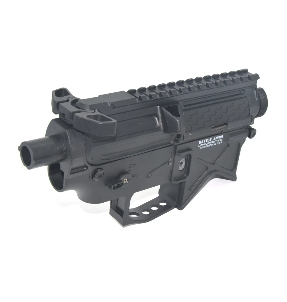

Are there any decent polymer/FRP ones?
Or to branch out, best polymer body generally? Silverback SRS is great, anything similar for AEGS (not GBBs otherwise that Aug is meant to be pretty good)?
You can buy a SLR M4 polymer receiver on aliexpress for around £40, it's pretty decent, designed for gel blasters but can be modified for airsoft.  I've also got a couple of the battlearms receivers still left over but these required a fair bit of modification.  keep meaning to get around to putting them together
