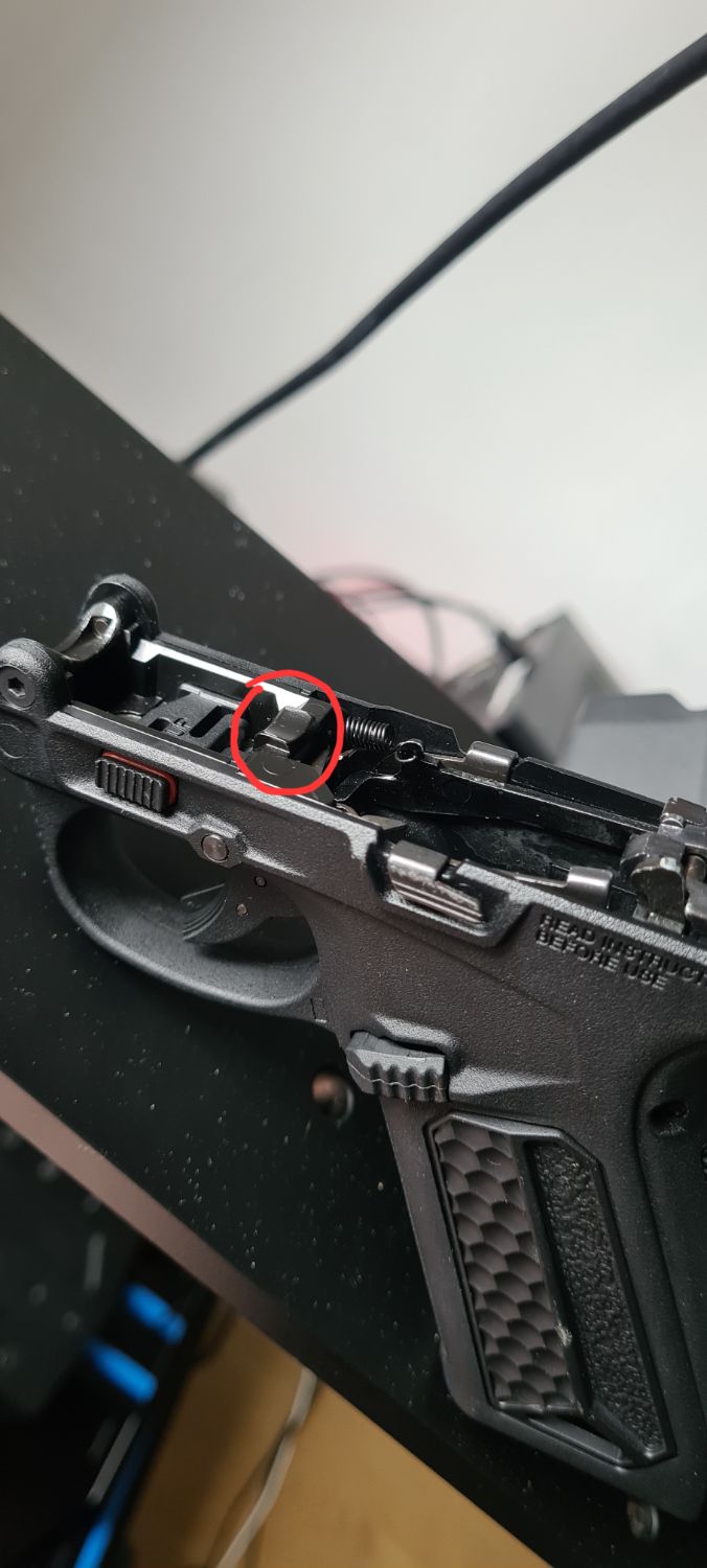

JLR Posted April 30, 2023 Share Posted April 30, 2023 Hey people I have an issue with my tti mini mamba not fitting with my lower could it be the fault of the lower or the new upper Amy help appreciated thanks Link to comment Share on other sites More sharing options...

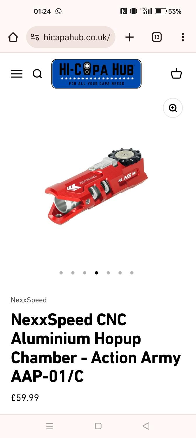

leadly Posted July 14 Share Posted July 14 Not that I ever use my AAP but I've got one of these set aside for when I next pop in for a coffee and catch up! I believe they're due in next week or the week after! I've got a NexxSpeed hop unit in one of my Hi Capa's and I'm really impressed with it! So hopefully this is just as impressive! I was going to get a Loki for it but I like the fact this has a wheel that can be accessed when the bolt is pulled back!! Link to comment Share on other sites More sharing options...
Cr0-Magnon Posted July 15 Author Share Posted July 15 Interesting! I wonder if it'd be possible to access in a black mamba upper, the ejection port on those is quite a bit smaller than stock. Not that I have any issues with my AA CNC chamber. Link to comment Share on other sites More sharing options...
Skara Posted July 15 Share Posted July 15 (edited) 28 minutes ago, Cr0-Magnon said: Interesting! I wonder if it'd be possible to access in a black mamba upper, the ejection port on those is quite a bit smaller than stock. Not that I have any issues with my AA CNC chamber. One thing that will always puzzle me is how most of these parts are "one dimensional", designed around ONE part (stock upper receiver in this case) without taking in consideration what's available on the market. With that being said, TDCs are a well established upgrade that more and more manufacturers are incorporating in their designs, a few of them actually include drilling jigs (either made of metal or "single use" plastic/3d printed parts) to have a clean end result, which will also drop manufacturing costs for things like dials and leverages in general. Now I am not saying those chambers suck, but from a designing perspective they're less efficient and convenient than, say, the first iteration of the Stalker TDC kit. Okay you need an additional tool (hex key) to adjust the hop, but let's be real for a second, unless one brings 6 mags with 6 different BB weights in them, there is absolutely no reason to set the hop mid game, especially in a pistol that doesn't see much use outside of close range cqb environments or close range backup to a primary that requires a MED. Edited July 15 by Skara Link to comment Share on other sites More sharing options...
Cr0-Magnon Posted July 15 Author Share Posted July 15 Let's face it, most pistols are "upgraded" purely for the sake of messing around with it. If you just want a reliable sidearm for the odd occasion you are close enough and actually remember to use it, then you could get pretty much any of the TM line and stick 0.20's in them. As I say I've got the AA CNC chamber, with stock rubber and nub, plus a 150mm Maple Leaf Crazyjet Barrel. I can hop 0.40's more metres than I'd ever try with a pistol. For use at up to 30M, I've currently set it up for 0.25's (also as this is the weight of the tracer BB's I may eventually use in CQB). I find much heavier and the BB's casually sail through the air, leaving my target plenty of time to duck for cover. Skara and leadly 2 Link to comment Share on other sites More sharing options...
