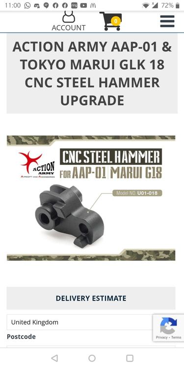

Waaaaaaah!! It's died!
I filled my drum mag with balls so I could waste the gas responsibly before I HPA tapped it. Had a few shots on semi and then bbbbbbbrrrrrrr, empties itself on full auto!
Pulled the mag out, popped it back in, racked it and yup, fires in full auto all by itself!
What done broke?
Happy deaded hammer to you too.
Mine are still going :D but I'll order some spares soon (next week most likely)
I assume this will fix it?
Yup.
In the meantime, I ordered a TTI charging handle with external fire selector for the DMR.
Unfortunately WGC doesn't have those nice CCT hammer sets :(

Well, my shopping basket at Airsoftworld is getting bigger by the day!
I 100% need the CNC hammer, so that's not up for debate.

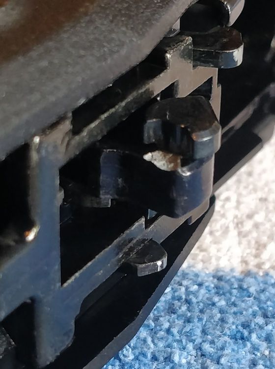

I've not had my AAP SMG in bits yet to investigate the damage but I assume that I'll find it's definitely the hammer and nothing else? Probably should be a grown up and check before I order!
Edit:
Did an adult,
Small chunk missing from the back of the hammer, I assume it stops that spinny bit spinning?
I'll go look at my other AAP to see what it should operate like!

When comparing to my other pistol, it looks like the part that has snapped off (a little lug) allows the bearing rotor to pivot around it.
Are you @Skararecommending I just fit a round bearing rotor that Google showed as compatible with Glocks to fix this issue?
Can anyone tell me what this bearing does or is responsible for?

The bearing is so that you can still use the hammer while you wait for a replacement.
