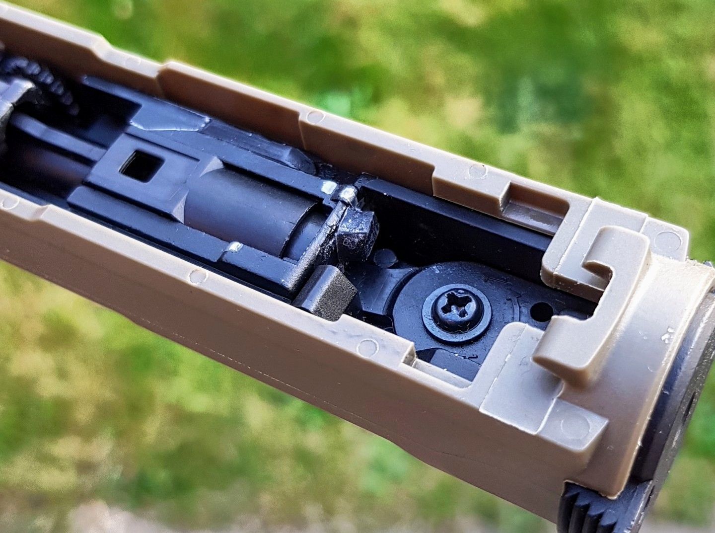

Supporters Samurai Posted September 16, 2020 Supporters Share Posted September 16, 2020 I have one. Played on an event with it once, so far I like it very much. Some parts of it are made of cheese. The screws for example and only after less than 100 rounds there was the big dent on the thing the hammer hits. Gluing a small rubber there is a must. Mine shoots very nice with the stock parts after a cleanup. Easy 70m torso hits on the test range. My Hi-capa couldn't reach it, only 65m. I'm trying to make it quieter with various methods. It's in progress. Skara and Cr0-Magnon 1 1 Link to comment Share on other sites More sharing options...
Skara Posted September 16, 2020 Share Posted September 16, 2020 Regarding this rubber thing. Would a piece of hop rubber suffice? Care to share any pictures of the mod? Link to comment Share on other sites More sharing options...
Supporters Samurai Posted September 16, 2020 Supporters Share Posted September 16, 2020 They say a 2mm rubber is enough. Mine is bigger and made from a harder rubber thing. Skara 1 Link to comment Share on other sites More sharing options...
