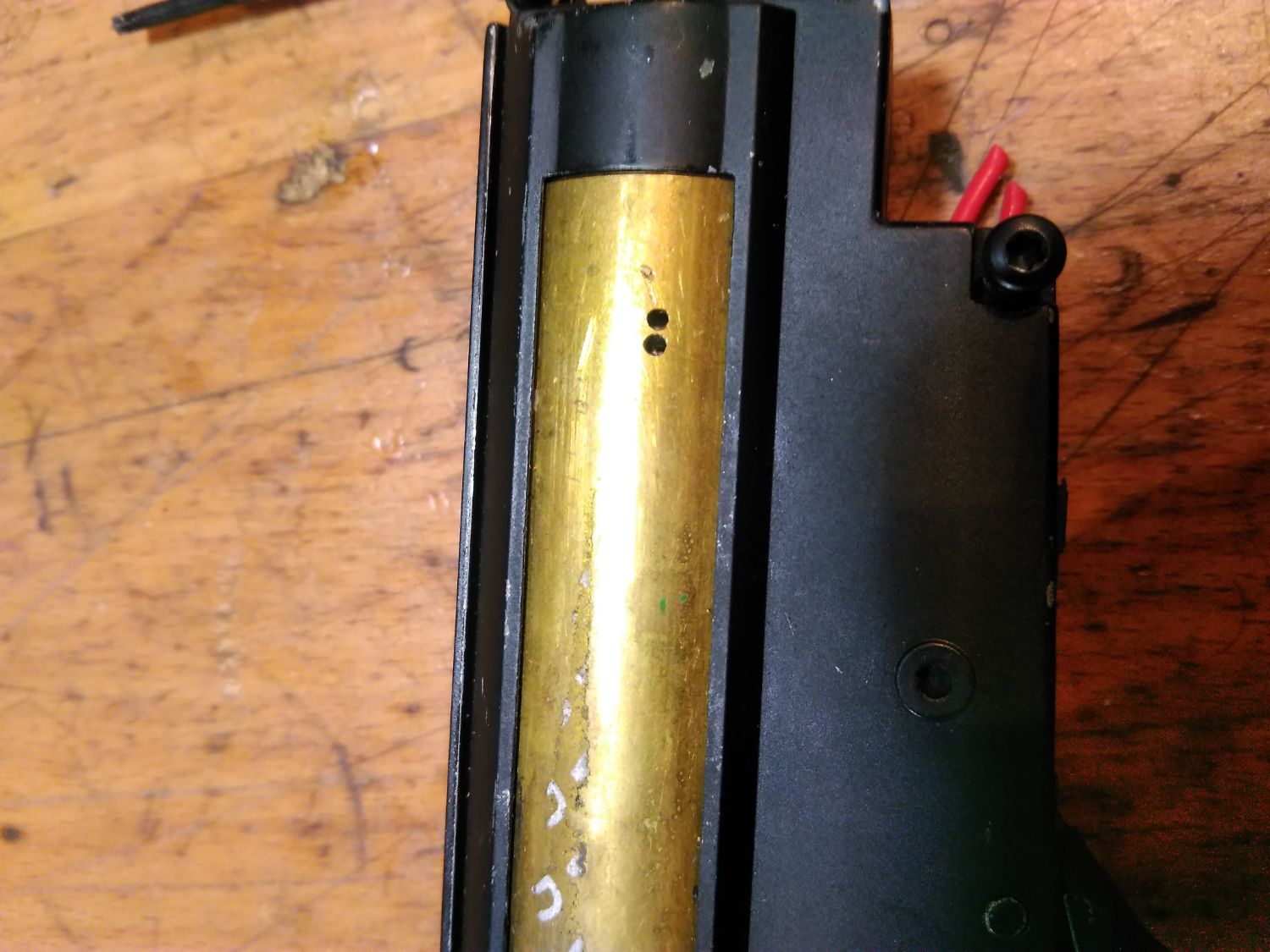

Wasnt sure if this goes here or if we need a cursed airsoft images thread:
I fervently believe AEG’s are the devils spawn, and have no desire to work on them ever again. However, my interest is piqued, I’m assuming to two drilled holes shouldn’t be there ??‍♂️
G&G pneumatic blowback I suppose
Its a jg gearbox i picked up boneyard, those holes are the result of someone doing an "fps downgrade" who presumably had either zero knowledge or gave zero fucks
Shame, wasnt a bad cylinder until that happened. Have to laugh at the aftermarket piston head in it like they gave a crap about air seal......
