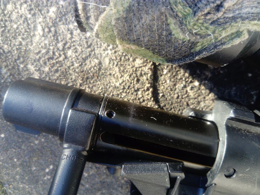

Cannonfodder Posted February 28, 2021 Posted February 28, 2021 So I've finally gotten round to looking at my Striker and I think I've found the problem. One of the 4 pins holding the bolt in place has gone awol.
Supporters Samurai Posted March 1, 2021 Supporters Posted March 1, 2021 The Striker's cylinder and piston is straight to bin unfortunately.
