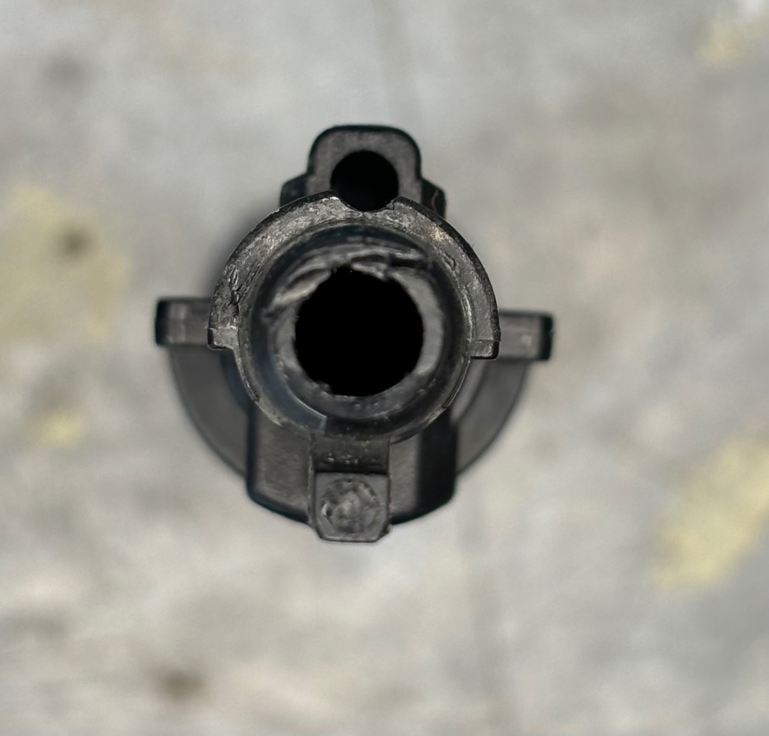

SSPKali Posted July 24, 2024 Posted July 24, 2024 (edited) Having fielded my MWS at the great RIFT Airsoft REDCON-2 site at the weekend I found that the old TM hop rubber was on its way out and my GunsModify nozzle damaged (probably from a shattered tracer BB earlier in the year) and this led to a couple of gas dumps at in opportune moments ? I also noticed some drift to the left beyond 40m. By 60m it was missing the torso sized target without some serious aiming off! I fitted a Maple Leaf bucking which gave a better air seal so dropped in the spare AG v2 nozzle and NPAS to offset the now very spicy FPS. I have some more GM and G&P nozzles if needed but the RATech NPAS are such a pain to adjust and not that consistent. Once cooler weather is here I’ll go back to the GM fixed set up. To keep the hop perfectly vertical I added a 0.1mm AEG shim to the outside left of the hop unit, between it and the outer barrel / brass collar. This stopped it rotating a fraction when snugging the barrel nut up. Now I just need to get to a range with 60m+ but it certainly looks perfectly level. Tested all my mags and FPS was 278 - 292 over the 7 mags, with each mag within +/-2fps on 3 shot of 0.28g Warhead BBs Mag #5 was the spiciest so marked that one and will chrono using it ? Edited July 25, 2024 by SSPKali Forgot photo! AlphaBear 1

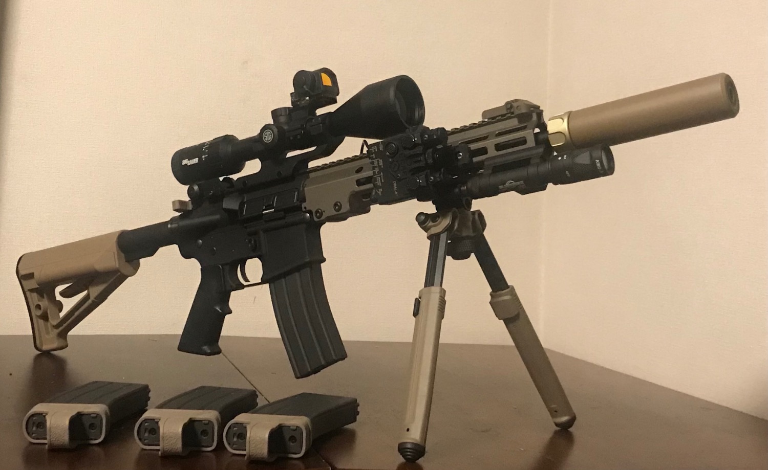

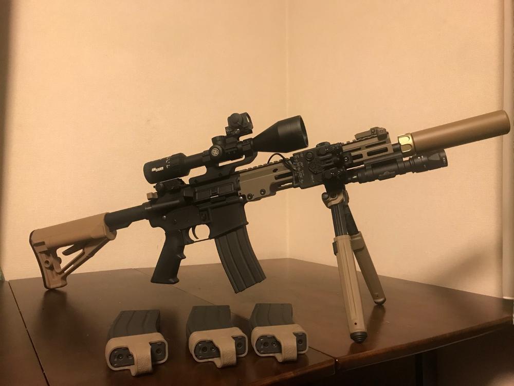

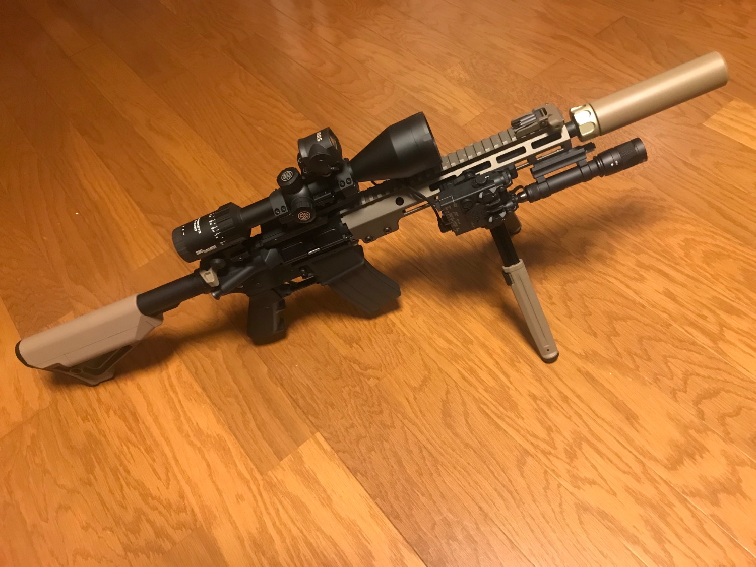

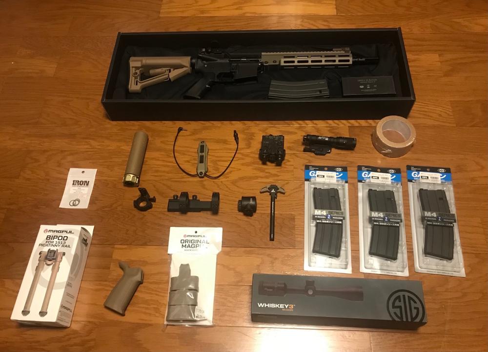

O3Tactical Posted July 27, 2024 Posted July 27, 2024 (edited) I'm in Japan now so the time has come to join the MWS club. Mostly real gear apart from the charging handle and the can. I have built a lot of firearms but am still a bit of a noob when it comes to airsoft and so, upon seeing this wonderful thread, I binge-read a good seventy five percent of the posts while in anticipation for getting my first proper GBB rifle. Because of this, I feel like I am very well prepared to put this beast together and would like to give a big thanks to Wo1f and all the regular contributors here for all of your knowledge and advice and, by way of reciprocity, should anyone wish to know what's going on in the scene in Japan or have questions about parts and procurement etc. then please send a message. When I am off base and not lumping things around in the heat I will do my best to answer promptly. Edited July 27, 2024 by O3Tactical credits and corrections rj1986, gavinkempsell and GothicGhost 2 1
Popular Post O3Tactical Posted July 27, 2024 Popular Post Posted July 27, 2024 (edited) So here it is, still in need of cable management and the grip needs to be installed but feeling good none the less. I aim to make this one a DMR, in as much as one can do in airsoft, and so will be doing my best to source the parts that you guys have recommended. I'll shoot it a bit first for fun and then start the upgrades as soon as possible. Next step will be paint followed by some killflashes and a fair amount of tape for the shiny bits. Edited July 27, 2024 by O3Tactical Added photo GothicGhost, Jacob Wright, gavinkempsell and 2 others 3 2

AlphaBear Posted August 7, 2024 Posted August 7, 2024 On 24/07/2024 at 21:34, SSPKali said: Having fielded my MWS at the great RIFT Airsoft REDCON-2 site at the weekend I found that the old TM hop rubber was on its way out and my GunsModify nozzle damaged (probably from a shattered tracer BB earlier in the year) and this led to a couple of gas dumps at in opportune moments ? I also noticed some drift to the left beyond 40m. By 60m it was missing the torso sized target without some serious aiming off! I fitted a Maple Leaf bucking which gave a better air seal so dropped in the spare AG v2 nozzle and NPAS to offset the now very spicy FPS. I have some more GM and G&P nozzles if needed but the RATech NPAS are such a pain to adjust and not that consistent. Once cooler weather is here I’ll go back to the GM fixed set up. To keep the hop perfectly vertical I added a 0.1mm AEG shim to the outside left of the hop unit, between it and the outer barrel / brass collar. This stopped it rotating a fraction when snugging the barrel nut up. Now I just need to get to a range with 60m+ but it certainly looks perfectly level. Tested all my mags and FPS was 278 - 292 over the 7 mags, with each mag within +/-2fps on 3 shot of 0.28g Warhead BBs Mag #5 was the spiciest so marked that one and will chrono using it ? Brings back memories when I foolishly used Nuprol bbs in my MWS and they shattered and royally screwed up the MWS! I should have sent Nuprol a bill for repairs ! That reminds me I need to check the rubber as I’ve not used the MWS for over 13 months. I know I know. Bad bad MWS owner ?? On 01/08/2024 at 08:29, MorganL said: Howdy folks :), I've bought the HPA adapter for the MWS, what uprades would you guys recomend for the platform or should it be fine as is for the most part? I only really do CQB so I don't need it to shoot the other side of the a forest. HPA’ing a MWS? Good lord man! Wash you mouth out with soap young man! Failing that a swig or two of whiskey! MorganL 1

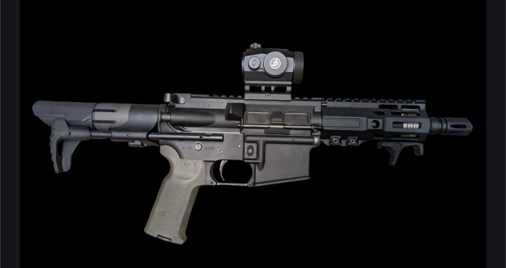

GothicGhost Posted August 9, 2024 Posted August 9, 2024 Bought a SLR rail to start my PDW build. SSPKali and rj1986 2

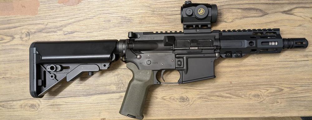

GothicGhost Posted August 14, 2024 Posted August 14, 2024 (edited) Added a pdw stock, took a while to sand the threads down. Edited August 15, 2024 by GothicGhost zizivert 1
zizivert Posted August 22, 2024 Posted August 22, 2024 (edited) Sweet GothicGhost. Some internal/external modifications since my last game with the previous version. Internal: I put a thicknes of resin on the aluminum nub of the hop up chamber PH+ because at the begining, to get an hop up effect you need to put the setting at the middle of the range. So with one millimeter thickness more i have full range of hop up setting. I replaced the TM bolt carrier + NPAS Angry gun by a G&P gold bolt carrier + guns modify nozzle + NPAS Feda. I also replaced the TM trigger box by a G&P steel trigger box by EMG. External: Removed parts: silencer warden by Angry gun, sight set magpul mbus 3, outer barrel extension dytac 10,5inch and the copy of leap01 1,57" rise. New parts: silencer no name 38mm x 185mm with balystik silencer spacers, outer barrel extension dytac 6inch, scalarworks leap01 mount 1,93" rise and a copy of Griffin sight set by PTS that is the only option I have to put the flash light at 45° and in front of the handguard. Edited August 22, 2024 by zizivert Nick G 1
