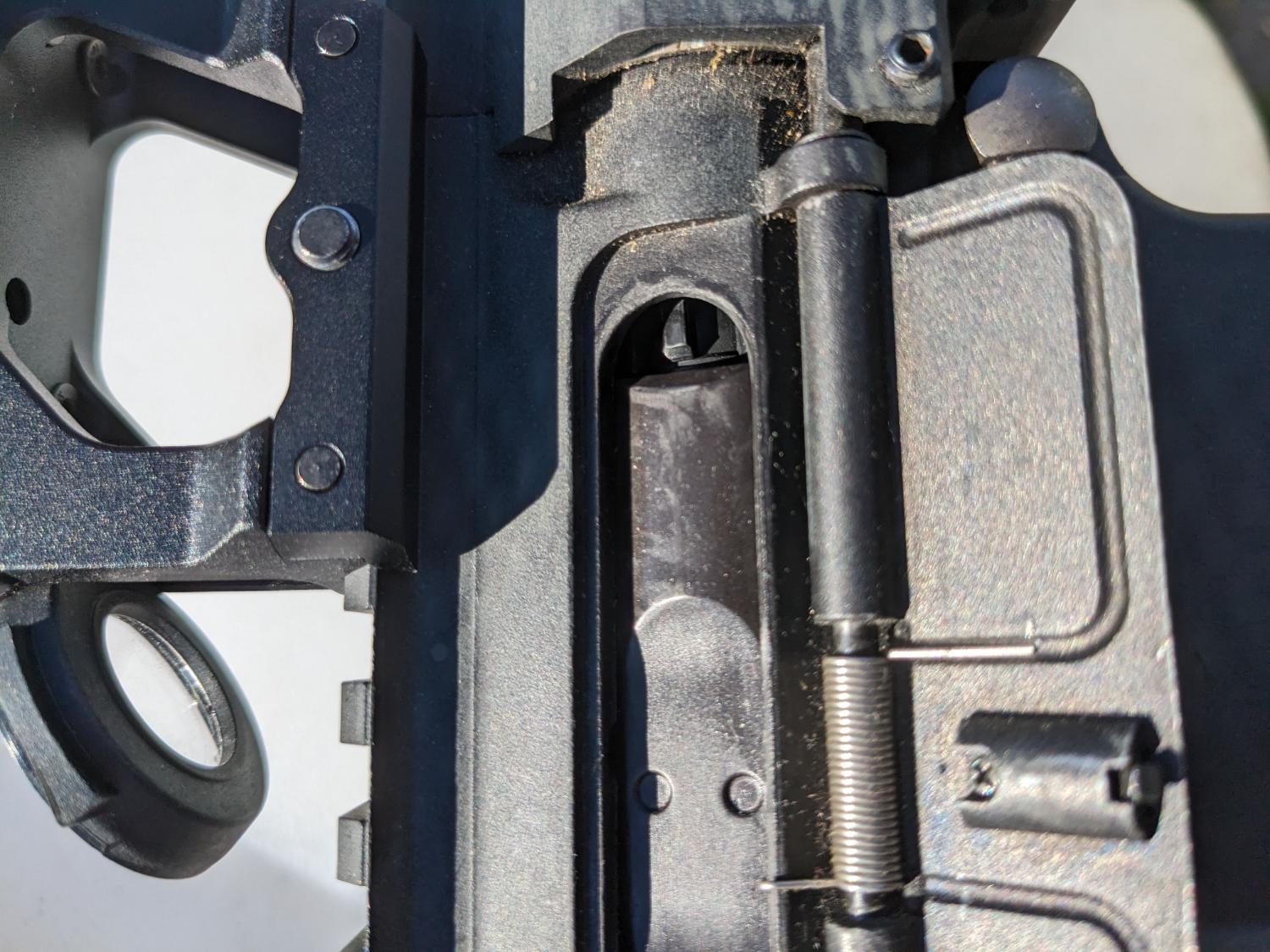

Emergencychimps Posted August 18, 2023 Posted August 18, 2023 Having an issue with it now venting gas, getting more and more consistent. As it's happening to pretty much all the mags, I figure it's an issue with the rif. As per the pic, the bolt sticks in the position, if I then pull the trigger it vents. My theory is: 1. It's bolt bounce, I've added 10ps to the stock tube but maybe the gas is too powerful and I need a weighted buffer. 2. There is an issue with the nozzle and it's catching on the mag /lips and it's stopping it from going into battery as normal 3. It's something else and I have no idea. I'd rather not buy parts on the basis of "it could be that" so does anyone know with confidence? Truth of the matter is money is tight at the moment (recent baby!) and I've been considering selling this, as much as i Iove it.
Wavey_Gravey Posted August 18, 2023 Posted August 18, 2023 (edited) What does your nozzle loading arm look like? Strip it all down, clean it, take some pics. Also, congrats on the baby ? Edited August 18, 2023 by Wavey_Gravey Emergencychimps 1
C-Diddy Posted August 18, 2023 Posted August 18, 2023 Like Wavey says, strip it all down, give it a good clean, and look for any obvious signs of wear on the BCG. When you put it back together, make it as near stock as possible and see what the score is. And congratulations, of course SSPKali and Emergencychimps 1 1

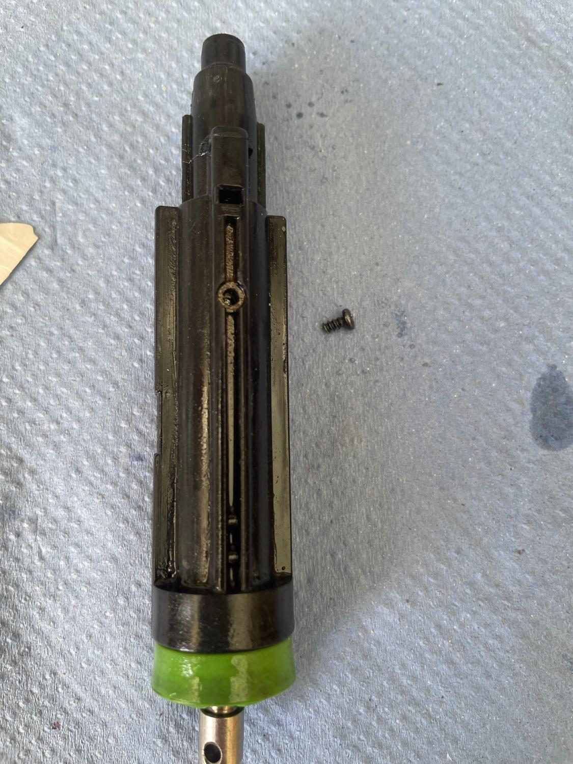

SSPKali Posted August 19, 2023 Posted August 19, 2023 Went to fit the Bavtac spring and this happened! Guess I will run it as-is until the nozzle or nozzle spring fail then chop it up to get the useable parts out! Have some 1.5mm lefthand drill bits coming so will try and back out the remaining stub but not too worried. Need a few spare screws like that - seem to be M2 screws with button head. Having replaced the the selector (LH lever fell off - was AG one and threads shallow / sloppy) and hammer roller (WiiTech polymer one cracked, replaced with TM steel one) I could do with out any more dramas ?
Emergencychimps Posted August 19, 2023 Posted August 19, 2023 On 18/08/2023 at 11:37, Wavey_Gravey said: What does your nozzle loading arm look like? Strip it all down, clean it, take some pics. Also, congrats on the baby ? On 18/08/2023 at 20:43, C-Diddy said: Like Wavey says, strip it all down, give it a good clean, and look for any obvious signs of wear on the BCG. When you put it back together, make it as near stock as possible and see what the score is. And congratulations, of course Thanks both, have done so and there was a very slight bend on the nozzle loading arm, applied some head and bent it back to shape and it's working like a charm now. I think I caused it with a BB double feed during a reload Wavey_Gravey, SSPKali and C-Diddy 3

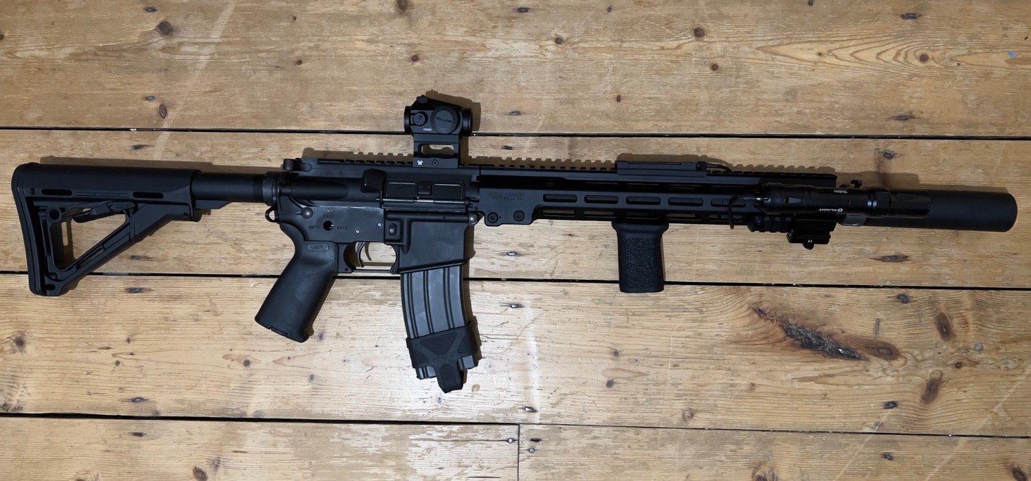

uncleanlatent Posted August 30, 2023 Posted August 30, 2023 Alrighty so a bit of an update on my MWS DMR build m. Started off as a banged up second hand CQBR, and is now a URGI-ish bb slinger. I’ve made the following modifications: eagle6 upgraded nozzle return spring Poseidon ice pick high flow valve mapleleaf MR bucking 60 SixG super Nub 14.5 inch 6.03 Laylax inner barrel zparts mk16 DD steel outer barrel zparts 13inch geissele hand guard magpul MOE+ pistol grip magpul CTR stock VFC BCM grip Olight Odin It’s doing around 300-310 fps on .40 BBs on green gas. Happy with the results so far and don’t think I could squeeze and more out of it ! Anyone else have success with DMR builds ? GothicGhost, Jacob Wright and Nick G 3
