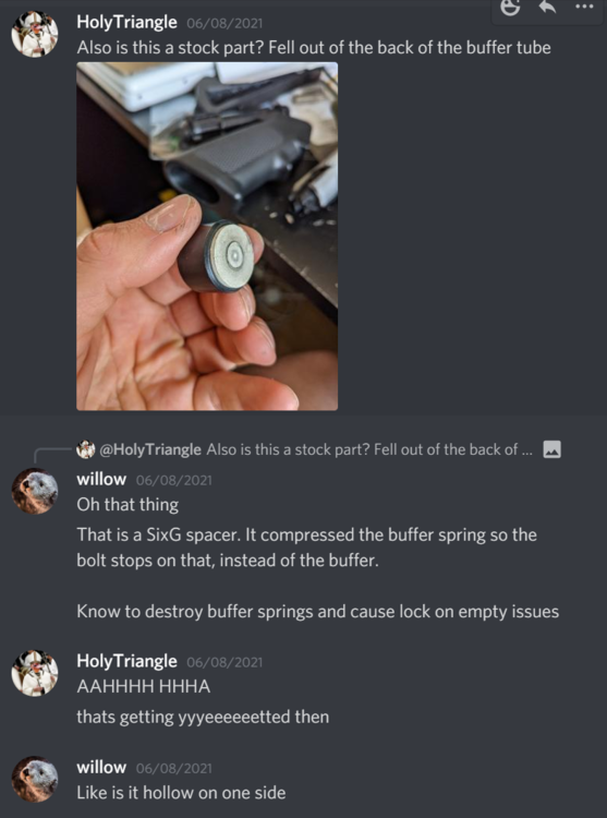

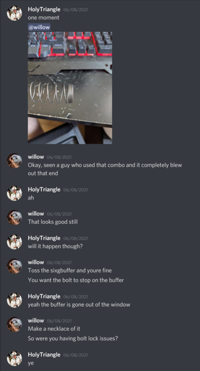

TadsJ2 Posted June 15, 2021 Posted June 15, 2021 3 hours ago, Davegolf said: No i havnt, where have you heard this? do you have a link? 2 hours ago, Softcore said: plz provide source, I'm about to order one and would like to know where you got this from? I've read the comments from one of the guy who claims to have seen buffer spring wrecked by HSB from TM discord server I am in, since I havent found any info about it here I wanted to ask you guys, I dont have any other source than this so thats why I wanted to ask the veterans in this field I already have HSB in my hands, so just wanted to be sure whether it should be safe to install - so gonna go ahead and do it, havent had a problem with what this thread has been suggesting me before
TadsJ2 Posted June 15, 2021 Posted June 15, 2021 this is what baffled me... And the explanation from SixG: Peoples buffer tube end caps fall out from time to time, this happens on stock guns, it vibrates itself undone, as with most things on GBBs loctite blue (243) is your friend. This is not because of the HSB. The prime purpose of the HSB is to stop the buffer parts being hammered so hard, causing the above and shattered buffer 'part-B'. I have never known a buffer spring to be broken because of the HSB, i cannot see any reason why this would be so, i actually think they may be getting confused because the image of a buffer spring posted is completely normal - AKA one end is supposed to have tighter wound coils (this end seats onto the buffer itself) They are also misinformed as the HSB still allows the buffer to bottom out, he difference is that the spring rate is increased so that it doesnt hit as hard, and when it does contact it touches down onto the rubber bumper not sharp/cast stock tube end cap. With regard to bolt lock on empty functionality, depending on the power of gas you are using you may or may not need to unscrew the buffer tube 1 turn. So sorry if I raised some eyebrows, just wanted to make sure that HSB shouldnt do damage to MWS SSPKali 1
alxndrhll Posted June 15, 2021 Posted June 15, 2021 3 minutes ago, TadsJ2 said: this is what baffled me... And the explanation from SixG: Peoples buffer tube end caps fall out from time to time, this happens on stock guns, it vibrates itself undone, as with most things on GBBs loctite blue (243) is your friend. This is not because of the HSB. The prime purpose of the HSB is to stop the buffer parts being hammered so hard, causing the above and shattered buffer 'part-B'. I have never known a buffer spring to be broken because of the HSB, i cannot see any reason why this would be so, i actually think they may be getting confused because the image of a buffer spring posted is completely normal - AKA one end is supposed to have tighter wound coils (this end seats onto the buffer itself) They are also misinformed as the HSB still allows the buffer to bottom out, he difference is that the spring rate is increased so that it doesnt hit as hard, and when it does contact it touches down onto the rubber bumper not sharp/cast stock tube end cap. With regard to bolt lock on empty functionality, depending on the power of gas you are using you may or may not need to unscrew the buffer tube 1 turn. So sorry if I raised some eyebrows, just wanted to make sure that HSB shouldnt do damage to MWS Ahh the good ol' fashioned 'seen a guy'. You can always count on reliable information when it follows those 3 words. SSPKali, TadsJ2 and RMDavis 3
TadsJ2 Posted June 15, 2021 Posted June 15, 2021 2 minutes ago, alxndrhll said: Ahh the good ol' fashioned 'seen a guy'. You can always count on reliable information when it follows those 3 words. Yeah, after these comments I am starting to want to leave that discord server
alxndrhll Posted June 15, 2021 Posted June 15, 2021 1 minute ago, TadsJ2 said: Yeah, after these comments I am starting to want to leave that discord server People presenting second hand information with a definitive result just grind my gears. The fella initially asking followed up with 'Will this happen?' and the chap answering literally ignored the question and just said toss it. No reason, no further explanation, no break down of the parts being used alongside the spacer. Nope, the answer to the question will this happen to me wassss... toss it. Superb, I don't know who's more daft of the pair. The one asking the questions and taking the first answer he got at face value, or the clown spouting second hand garbage (the answer is both). SSPKali, RMDavis, TadsJ2 and 1 other 2 2
TadsJ2 Posted June 15, 2021 Posted June 15, 2021 (edited) 5 minutes ago, alxndrhll said: People presenting second hand information with a definitive result just grind my gears. The fella initially asking followed up with 'Will this happen?' and the chap answering literally ignored the question and just said toss it. No reason, no further explanation, no break down of the parts being used alongside the spacer. Nope, the answer to the question will this happen to me wassss... toss it. Superb, I don't know who's more daft of the pair. The one asking the questions and taking the first answer he got at face value, or the clown spouting second hand garbage (the answer is both). Worst part is the confusion of mostly everyone... after I asked him directly how can he be sure whether HSB caused this he didnt respond Edited June 15, 2021 by TadsJ2
alxndrhll Posted June 15, 2021 Posted June 15, 2021 3 minutes ago, TadsJ2 said: Worst part is the confusion of mostly everyone... after I asked him directly how can he be sure whether HSB caused this he didnt respond Got too carried away with rapid fire facepalming to actually give my own first hand experience. Used both the Super Nub and HSB in my first MWS, will be doing the same in my second. Only other thing I touch is throwing an NPAS in there as and when it's needed and if I decide to use a BAD lever (which is unlikely because I'm currently planning on doing a carry handle build with this one) I'll use a lightweight bolt stop plate to ensure the bolt continues to lock reliably. Outside of that, don't see a reason to change anything internally. Tom_84 and TadsJ2 2

quango2k Posted June 18, 2021 Posted June 18, 2021 On 15/06/2021 at 15:40, TadsJ2 said: I've read the comments from one of the guy who claims to have seen buffer spring wrecked by HSB from TM discord server I am in, since I havent found any info about it here I wanted to ask you guys, I dont have any other source than this so thats why I wanted to ask the veterans in this field I already have HSB in my hands, so just wanted to be sure whether it should be safe to install - so gonna go ahead and do it, havent had a problem with what this thread has been suggesting me before i have one. A couple of times I have had the buffer stuck in the buffer tube. When stripping and poking it back loose the tapered end of the spring was folded in on itself causing the spring to bunch up and stick in the buffer tube. When I remove the HSB, this doesn't happen. Take from this what you will. I know many have had no issues though.
SkyNex0 Posted June 18, 2021 Posted June 18, 2021 Anyone installed the mws hao 416 kit? How was the fitment? Did the gun work flawless or was filing and fitment nessecary? Cheers
Davegolf Posted June 18, 2021 Posted June 18, 2021 4 hours ago, quango2k said: i have one. A couple of times I have had the buffer stuck in the buffer tube. When stripping and poking it back loose the tapered end of the spring was folded in on itself causing the spring to bunch up and stick in the buffer tube. When I remove the HSB, this doesn't happen. Take from this what you will. I know many have had no issues though. Do you know what gas and at what temperature this happened?

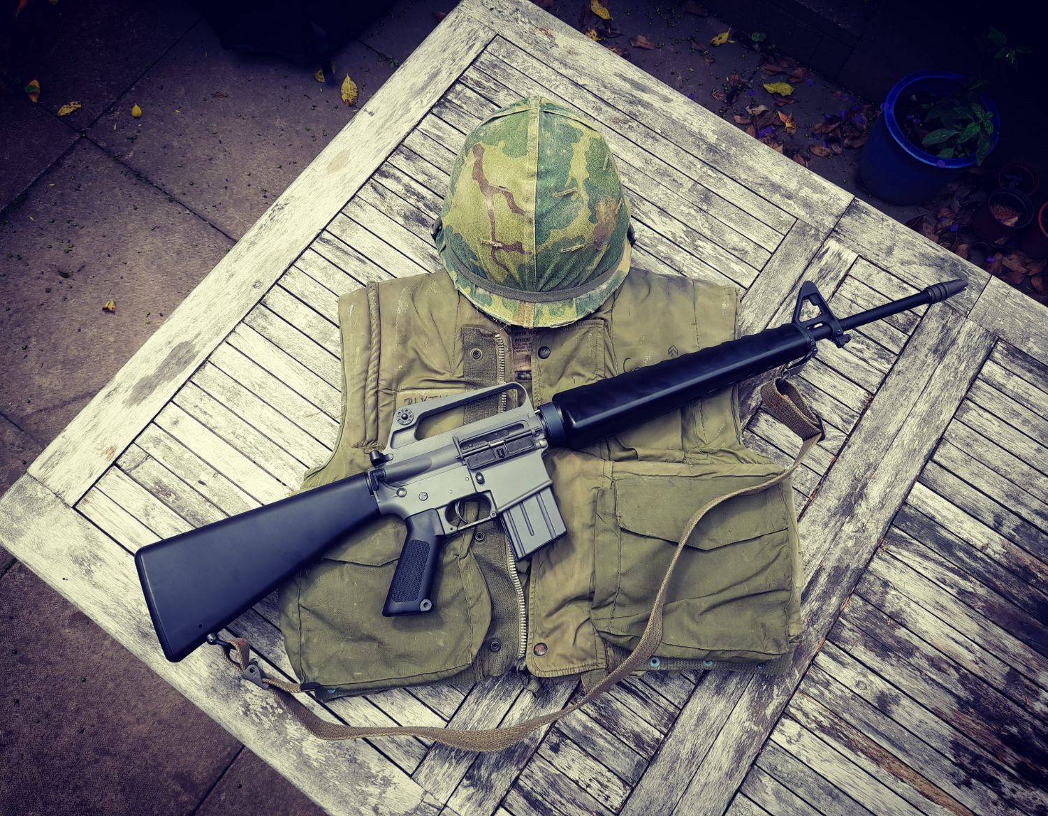

Patrolpointman Posted June 20, 2021 Posted June 20, 2021 So I finally got the proper early D-stock and pistol grip to finish off the XM16E1. Pictured with my original M1955 Flak Vest. Hypokondrikern and GothicGhost 1 1

GothicGhost Posted June 21, 2021 Posted June 21, 2021 On 20/06/2021 at 16:16, Patrolpointman said: So I finally got the proper early D-stock and pistol grip to finish off the XM16E1. Pictured with my original M1955 Flak Vest. Very nice ? Using a fixed stock does the different buffer more heavy? With slower rate? Thank.
Patrolpointman Posted June 22, 2021 Posted June 22, 2021 9 hours ago, GothicGhost said: Very nice ? Using a fixed stock does the different buffer more heavy? With slower rate? Thank. Cheers! The rifle length buffer has a selection of different weights you can use should you wish a heavier recoil. I opted to leave them out so it was more gas efficient when using the shorter magazines.
