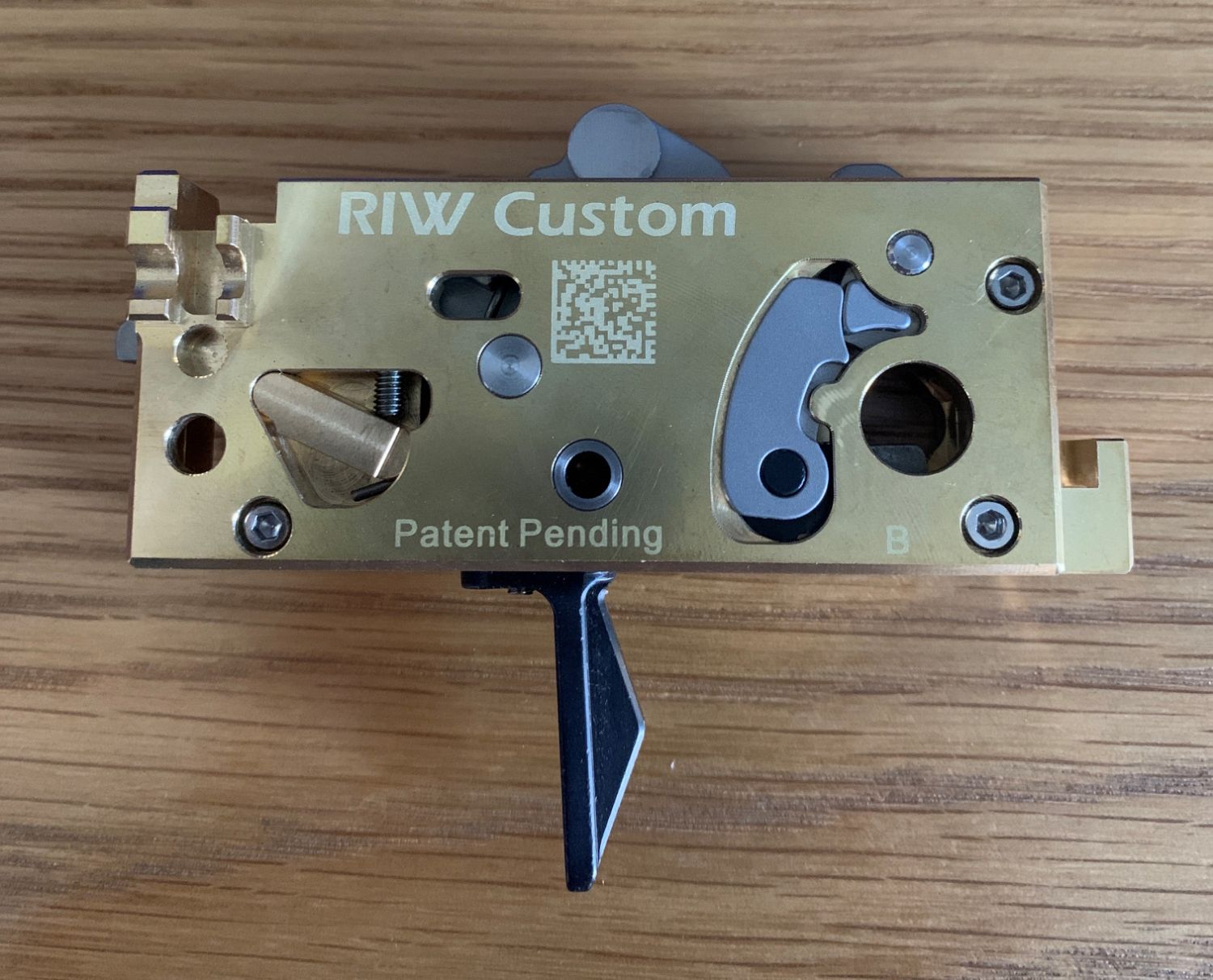

ajumma Posted June 14, 2021 Share Posted June 14, 2021 My long awaited (I say long, it literally arrived in 3 business days- posted Wednesday, arrived Monday) new trigger box. My stock trigger developed issues and I was always unhappy with how it felt. First impressions were wow, the construction is SO much cleaner than the stock trigger box. I guess that's what you get with CNC'ing! I dropped the trigger box straight into my MTR16. I needed to very gently mallet the safety to get it seated since it seemed to be ever so slightly misaligned with the right hand side of the lower when being reinserted. I made a very, very short video showing how it performs vs. my stock trigger. All in all, I'm extremely happy with it! I expect the trigger to work even better in a few weeks once it's properly broken in. I will likely take it apart at some point to clean it out and apply a little lube, but it seems to work great ootb. SSPKali 1 Link to comment Share on other sites More sharing options...

Davegolf Posted June 15, 2021 Share Posted June 15, 2021 (edited) @TadsJ2 can you expand, explain, what product you are talking about? Theres quite a few buffer products out there! On 14/06/2021 at 23:26, ajumma said: My long awaited (I say long, it literally arrived in 3 business days- posted Wednesday, arrived Monday) new trigger box. My stock trigger developed issues and I was always unhappy with how it felt. First impressions were wow, the construction is SO much cleaner than the stock trigger box. I guess that's what you get with CNC'ing! I dropped the trigger box straight into my MTR16. I needed to very gently mallet the safety to get it seated since it seemed to be ever so slightly misaligned with the right hand side of the lower when being reinserted. I made a very, very short video showing how it performs vs. my stock trigger. All in all, I'm extremely happy with it! I expect the trigger to work even better in a few weeks once it's properly broken in. I will likely take it apart at some point to clean it out and apply a little lube, but it seems to work great ootb. Expand Nice bit of kit for sure! Worth noting that what you experienced from the old trigger unit is generally resolved by a good clean out and deburr. The dead trigger is caused by excess friction from parts that have marred over. I actually find the old/worn trigger units once sorted out are better than new ones! Edited June 15, 2021 by Davegolf Link to comment Share on other sites More sharing options...

ajumma Posted June 15, 2021 Share Posted June 15, 2021 On 15/06/2021 at 06:33, Davegolf said: Worth noting that what you experienced from the old trigger unit is generally resolved by a good clean out and deburr. Expand Interestingly, the dead trigger issue started happening after I took my trigger box apart, cleaned out all the gun and old grease, then reassembled with a little silicon oil on the contact areas around the different sears. I thought I had over-lubed it, so I took it apart again and cleared out as much oil as I could, leaving behind an almost non-visible layer, and I still had a very weak reset. Although, the grittiness was improved after cleaning. I didn't try deburring or polishing the parts yet though, I might do that since I have the stock trigger box as a spare! I intend on trying to break in the RiW G&P trigger box for a few weeks/months since it's still very new, apparently the slight resistance/grittiness on the take-up to the wall (when cocking the gun without the trigger depressed) disappears after the trigger box is worn in. But even if it doesn't go away, I'm extremely happy with the feel of this trigger vs the stock one. Link to comment Share on other sites More sharing options...
Davegolf Posted June 15, 2021 Share Posted June 15, 2021 Yeh the trigger boxes are normally pretty slick, and have a less gritty takeup and faster/crisper reset once deburred, profiled and fine wet/dry Link to comment Share on other sites More sharing options...
