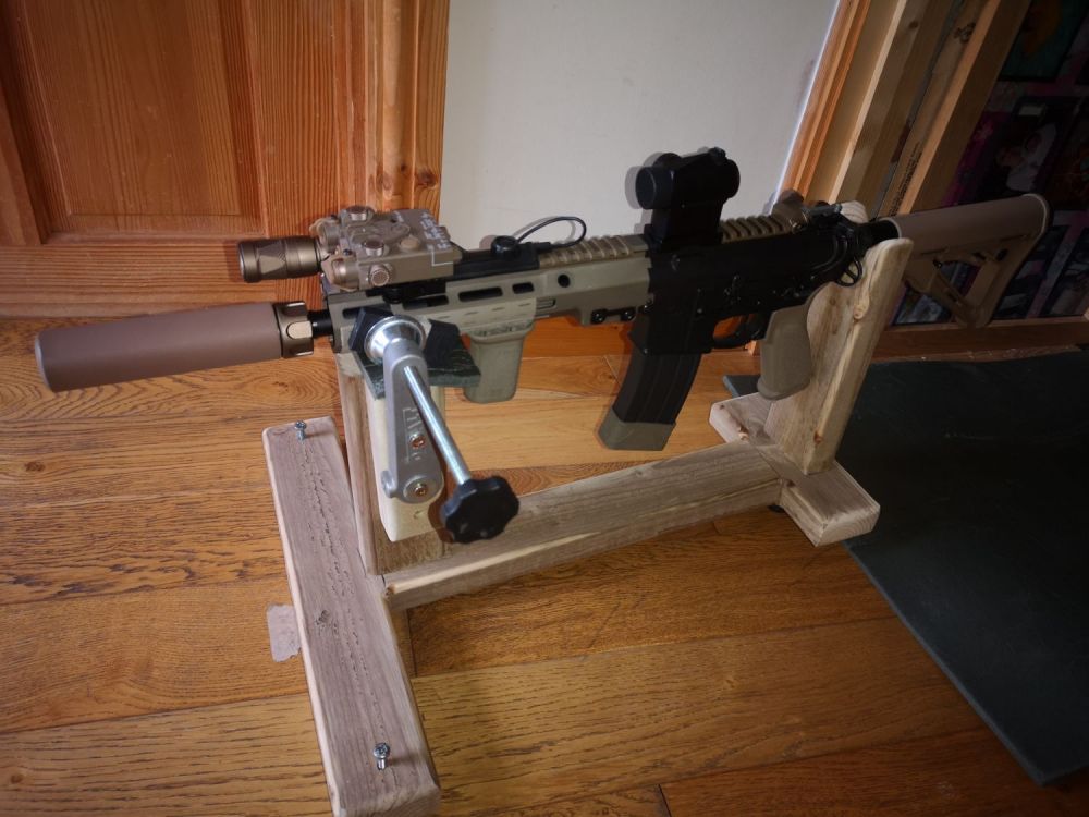

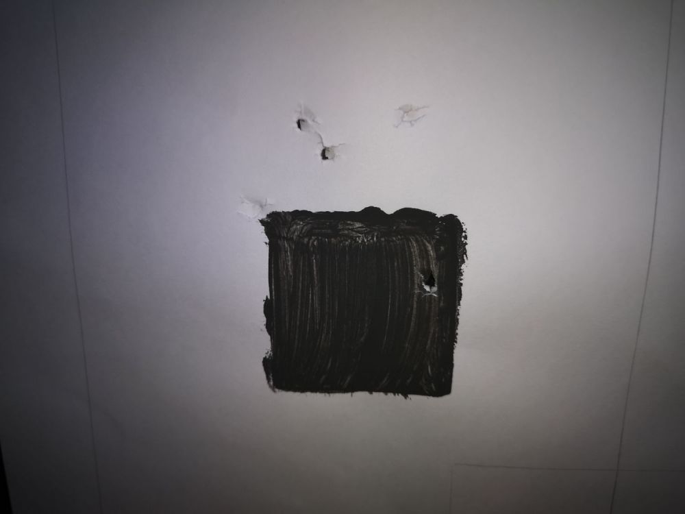

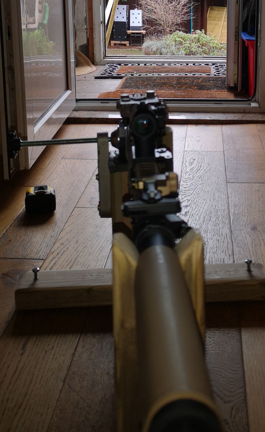

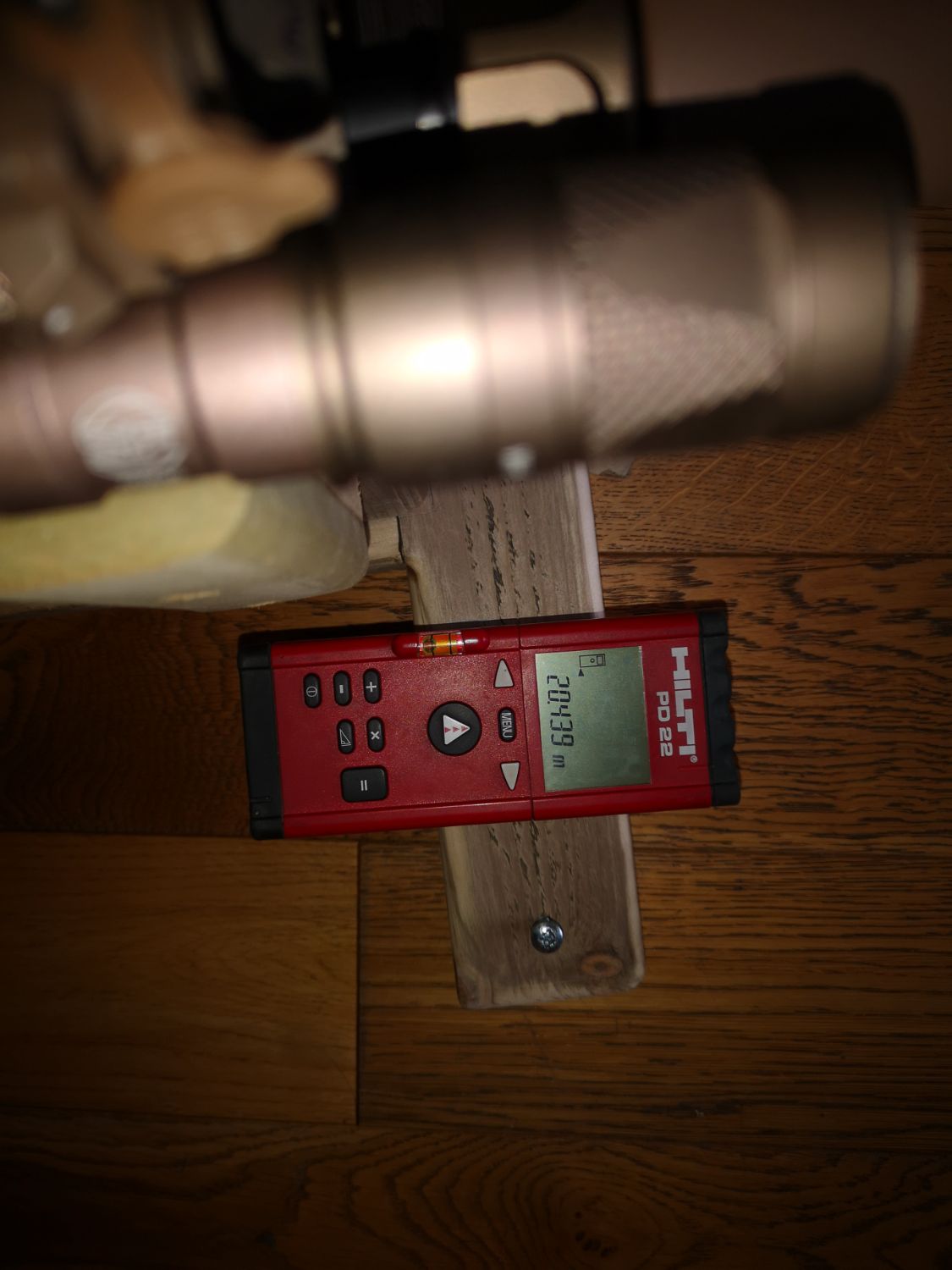

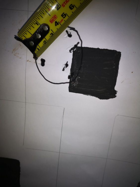

Wild Weasel Posted November 27, 2020 Posted November 27, 2020 So, the Autobot 60° seems to have done a damn fine job coupled with a six g nub. 40mm groups!!! Rifle was clamped the whole shoot and the very first group shot is the one with the black ring round it. Range is 20 metres, black painted patch is 50mm square, bb's Geoff's naturals black in. 3g flavour, propellant is Mapp gas and she's shooting around 300fps with three clicks of hop. Now all I've got to do is sort out my bolt-lock again as the lube I'm using in 8° c makes it move up sluggishly causing the bolt to miss. Captain Darling 1
